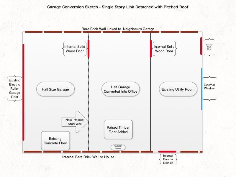

I will try and keep it short. In a nutshell new house (not new build) and it's got an unofficial conversion of the back half of the garage. I want to make this official by applying for retrospective building regs. First logical step here is to make sure it is up to scratch.
I thought a quick (not at all to scale) sketch would help.
It's a link-detached property so just joined by this single storey brick garage with pitched roof.
There are a rad, electrics, phone and Ethernet sockets already in place.
Any suggestions on what on the below sketch may need doing (e.g. Insulating the 'party' wall between garages?)

Does anyone know how I can tell if the raised timber floor in this conversion has 'damp proofing' as per regs? Presumably, from what I have read, the only other issue I may have if I wanted to gets regs. on it would be the party brick wall; seems it would need insulating somehow (although technically it's not external)
Oh yes, stud wall would need insulation too, not sure how I would so that without ripping one side down to stuff insulation in!

Why take one side of the wall down? You could just stick insulated plasterboard over what's already there.
But why bother? Building Control won't do anything - as you've already been advised.
Thanks Tony, I had no idea I could just stick more (insulated) board up as a solution! I'm pretty new to DIY so still learning!
As you've all said, no need to bring it up to regs, insulation may be good though as I use it as my home office and work two or three days a week out of it on average.
Sticking insulated plasterboard over will still need a finish. Which is is no harder than ripping out, insulating between studs and renewing the boards, which will need the same finish, unless you're not bothered, either way the final result is the same... all a bit chicken /egg really.
I guess that's a good point actually, either way I have to put up and finish a set of plaster boards, so all I am saving is the effort of ripping down the first layer of board and the stuffing in of insulation...
