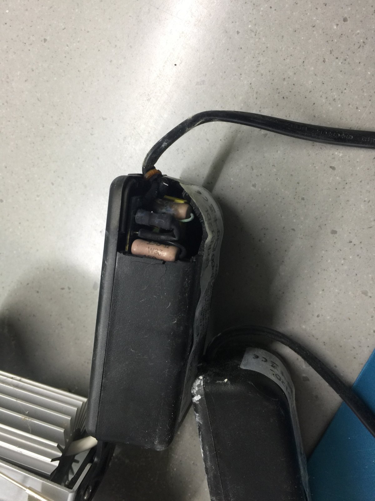

Have had 2 lights just go dead and then started to get random 6A lighting circuit trips when a string of these was being turned on or off. Finally the string would not come on at all. Traced it to one light whose driver looks a bit worse for wear. Unfortunately they were installed as part of kitchen remodel so would need to go back through him. Underwhelmed at the number of failures and this one in particular could have caused a more serious issue than a tripped breaker.
Blimey, I hope that unit gets sent back to the manufacturer for inspection.
I wonder what the fault was in yours, the resistor that looks cooked is in series with the mains supply. In the one I have here it is 249Ω 3W metal oxide film resistor. The other visible resistor is also in series with the mains supply. Unless the heat was from further inside the unit? Did the fuse that is now visible blow? The previous dead ones had shorted main transistor that took out the input fuse. Do you have a photo of the inside of that power supply?
