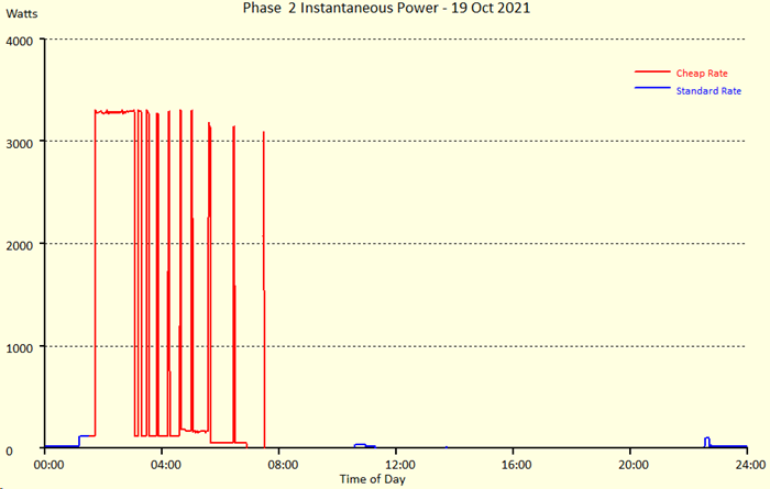

OK so to continue, if it is as I suspect (that the immersion tank is on all night) does it make sense to add a further timer at the fused switch unit that feeds the tank heater ... so that the tank is only heated for a few hours (how long does a tank take to heat fully?).
Provided one has a well-lagged HW cylinder (as previously discussed, mine is very well lagged) one gains (saves) very little by reducing the period for which an immersion is powered, since its thermostat does that anyway.
My immersion is powered (by a time switch) for the entire 7-hour cheap E7 period. However, as can be seen from the graph of a typical recent day, it usually only takes 1.5 - 2 hours to heat the water 'up to temp' at the start of that period (at which point the thermostat switches it off) after which the thermostat only switches the immersion back on fior a minute or three very occasionally (to 'top up' the heat) - only 9 or 10 times in the 5.5 hour period (after 'initial heating') shown below.

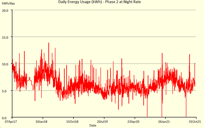

... But immersion heaters or any other form of domestic water heating is not normally going to power up for long, my insulation is not very good, but ½ hour every other day is enough. So looking at around 4.5 kWh per day, so even if not on E7 still less than £1.
Indeed (in concept) - although I don't know how you got from "½ hour every other day" to "around 4.5 kWh per day". Did you mean hours ever other day (which would be about 4.5 kW per day) OR, perhaps more likely, "4.5 kWh per week" (which would be fairly close to "½ hour every other day")??
If you did mean 4.5 kWh per day (which I doubt) then, by quoting a daily price, you might be taking a leaf out of the book of those who sell insurance, 'extended warranties' etc., since you might regard the situation a little differently if you re-wrote "...less that £1 per day" as "...less than £365 per year" :)
Off peak heating tends to heat home when not required, and so it is uncertain if it really saves money, and clearly does not save energy.
True, but as I recently wrote, the progressive increase in nocturnal EV charging has the potential to eventually flip the situation, such that the period of lowest electricity demand (hence, one might hope, 'off-peak' charges) might become the daytime hours!
In passing, by co-incidence, as can be seen from the graph below, 4.5 kWh per day is roughly what my nocturnal (E7) immersion uses in mid summer. Even though extremely well lagged, the cylinder is in a minimally-heated part of the house, and therefore shows substantial seasonal variation in the energy usage, the energy used usually being almost double in mid-Winter as compared with mid-Summer. You can also seen on the graph the effect of my increasing the cylinder's insulation from 'very insulated' to 'very very insulated' in early 2018!
