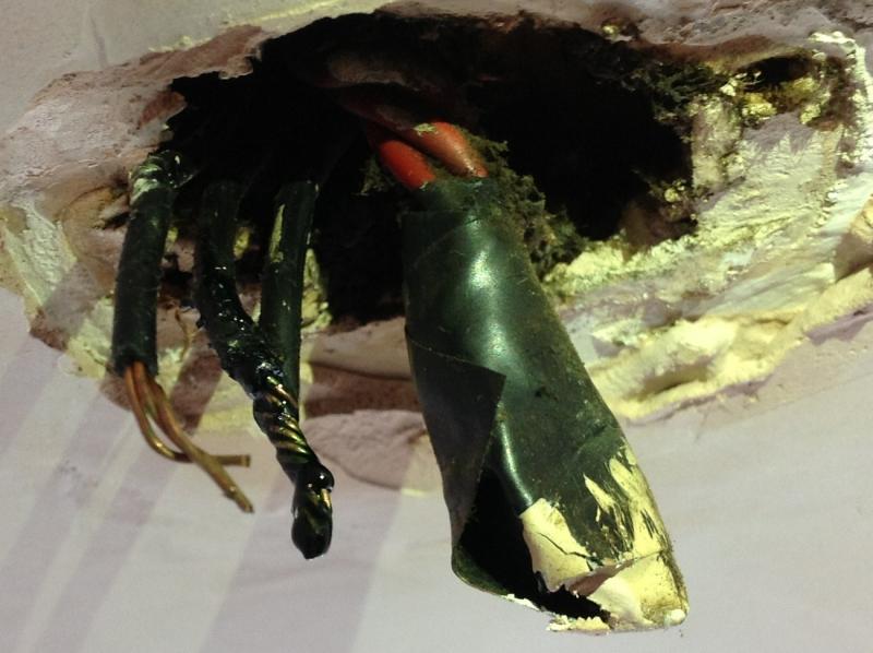

Hi all. First post so be kind :)
Have just taken a really old fitting down as it had a dodgy connection. The cables weren't into any kind of block on the fitting, just black taped together, so everything is a bit of a mess.
The red bundle of cables weren't connected to anything.
The other cables are sheathed black as far as I can tell.
The single cable on left I believe was connected to a red cable on fitting (hard to tell as everything is a black gooey mess!)
It's a landing light, so are the two together for the switch downstairs and up, and the other the live feed? Can I use them in this condition, or is the residue a fire hazard?
I can't see any earth, but am going to have a poke around for it in a minute.
I only want to hang a simple pendant so I can have some light until electrican fits all my lights.
Any help would be much appreciated.

The three red wires are [1] live feed to the lamp, [2] live feed to another lamp and [3] live feed down to the switch for this lamp. None of these connect to the lamp itself. If you fit a ceiling rose these will all go into the terminals marked LOOP
The two blacks twisted together are [1] neutral feed to the lamp and [2] the neutral feed to another lamp. These connect to the neutral of the lamp.
The single black is the switched live back from the switch and connects to the live of the lamp. It should be sleeved with red to show it is a live wire and not neutral. You need to mark it so you know which black is the switched live when you ( or the electrician ) separate the blacks while fitting the ceiling rose to tidy up the wiring.
If there are no earths you cannot safely use metal fittings or switches. Even if there is an earth wire at this lamp you cannot be sure it is connected at the other end so again no metal fittings.
It is a mess, live and neutrals seem correctly connected but installed badly. The earth needs to be verified.
I'd be very careful with the poking about bit. As too the goo, isolate the circuit From the mains (obviously) and double check with a multi-meter that there is no juice on any conductor. Then just clean with WD40 or the like.

The red cables bundled together were not connected to the old fitting. Just taped together (in their own little dodgy loop I suppose!) what are the implications of leaving them like that? I know it's easy to connect them to the plastic pendant I have, but just wondered out of interest.
Would I need to separate the two neutral feeds to fit into the pendant? I intend to anyway for cleaning, but once again wondered what good practice / legislation was.

The WD40 cuts through tape glue and such really well and wiped off well should evaporate within 30 mins. As it acts as an isulstor when dried it's best to cut back the conductors a tad past the bare wire to make sure you get a good connection.

WD40 is none conductive. The WD stands for water displacement, and it's brilliant for flooded joint boxes etc. A good liberal spray of WD40 and you back in action.
Quick update - pendant up and working fine. I left the bundle of reds as they are, and didn't play with them.
I ended turning off everything in the house, as when I turned off down and upstairs lights on the board, there were 2 wall lights in the living room that were still live! :(

That green goo is a common problem with PVC wiring of a "Certain age".
The plasticiser used at that time has a reaction with the copper conductor/heat which produces that foul goo after 20-30 years..
There's no solution (even WD40!") that will fix this issue but it has been found that the goo is only unsightly and not harmful. A rewire isn't needed unless the IR figures are outside the specific requirements.

The stuff on the OP's cable looks to me more like tar / pitch rather than green plasticiser goo.
