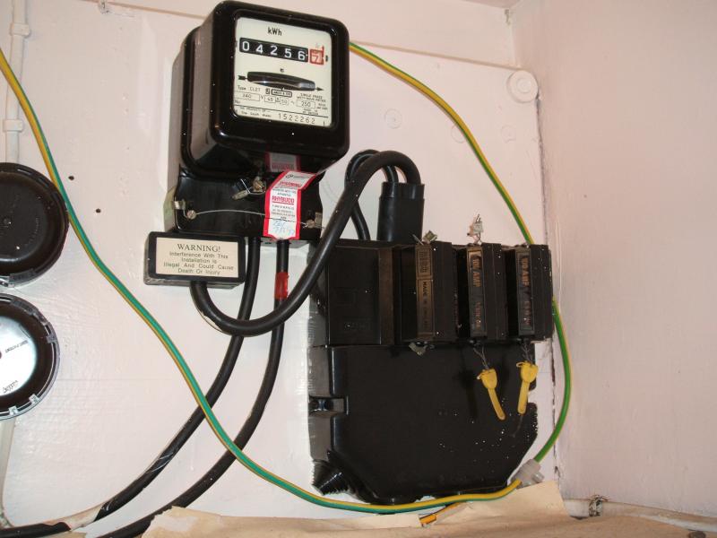

Hi, I have an old electricity meter with 3 huge fuses on a board next to it that takes up more space than the meter itself. 2 wires exit from the meter to black boxes the size of fag packets before a wire exits from each to the consumer unit.
I have a guy coming from the elec company to replace the meter on Friday (took 4 phone calls!) but I'm concerned about the age of the fuses and wiring.
My questions are:
1 - Should the fuse board with the 3 big fuses be replaced with a modern more compact fuse?
2 - Should the 2 fag packet size boxes be done away with?
3 - Should an isolation switch be placed between the board and the consumer unit?
4 - If the answer is yes to all, or any, of the above, will the guy replacing the meter automatically assess the present wiring configuration and upgrade as required.
Any help would be much appreciated.

It sounds like you have a 3 phase head.
The modern ones are no smaller than those fitted 30 odd years ago.
These sound like henley blocks.
They may well be your property.
Possibly. It depends on your exact setup, and the preference of your electrician.
No.
He will swap your meter.
If their part of your installation is dangerous, he will inform the mains team and get them to take a look.

The blocks are Henleys, I looked up what they are and can see that they feed the second consumer unit for the small extension.
I take it that I'm stuck with the 3-phase head?
I would like it to take up less space as its stretched over 2 feet across the kitchen wall (4ft including consumer units). At least I shouldn't require the Henley blocks as a new consumer unit is going to be fitting that will replace the 2 there already, which should shrink it to 2.5 feet :(

There is probably a reason for the 3ph head, perhaps your on the end of the line and its simply a termination point for the run of cable.
From your description I'm not sure if you are using all 3 phases.
OK thats a 3phase head. But only single phase meter. Do you live on the end of a row of houses? Or perhaps an old farmhouse? This would explain the 3ph head in domestic.
While the DNO are unlikely to remove the head, there is good news. You have a lot of wasted space on that board. The two round JBs could be moved over, the henleys could be moved over, Leaving space for the fuseboxes / CUs to move over.
More good news, all this can be done by an electrician since its all your kit. No need to get the DNO involved. I'm guessing the fuseboxes used to be mounted right next to the meter, since the two cables jointed in the JBs head for there, then divert to the "new" fusebox. I guess these form the ends of a ring final.
The black wires leaving the meter tell me they might be VIR, though I cant be sure. Dont go messing them them, they could disintegrate.
Look at yours again.
Imagine it without the two redundant fuses (middle and RHS).
That's about how big the replacement would be....

Bloke came to change the meter, which was a lot smaller than the old one. He was happy to put an isolation switch in when I asked. The new meter and isolation switch take up same space as old meter now, but at least power can be cut easily to allow a new consumer unit to be fitted.
He said I could have the 3 phase head change, but that it would cost me!
