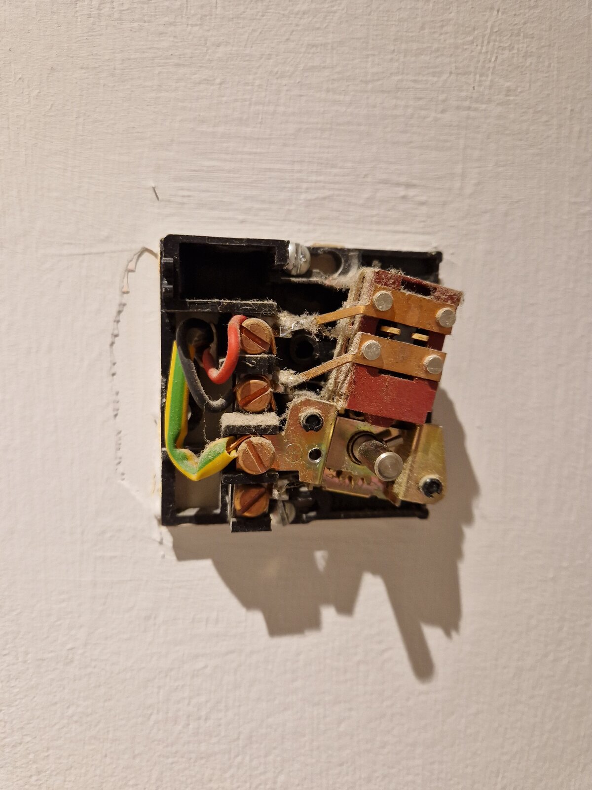

Hi Folks, looking for some advice.

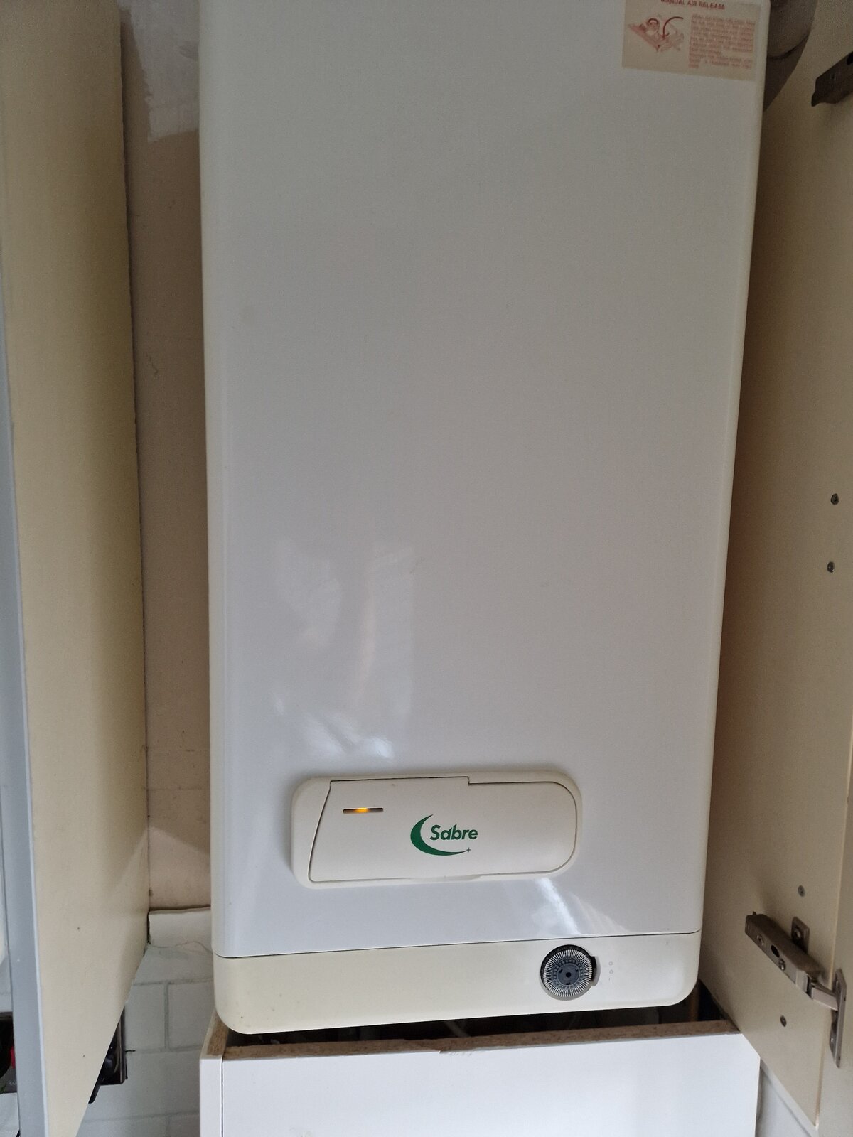

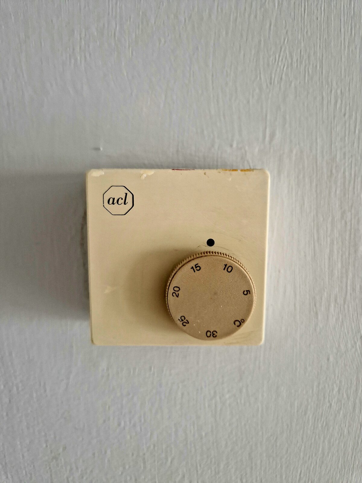

I have an older style Sabre boiler and an old 'Acl' thermostat in the hall.

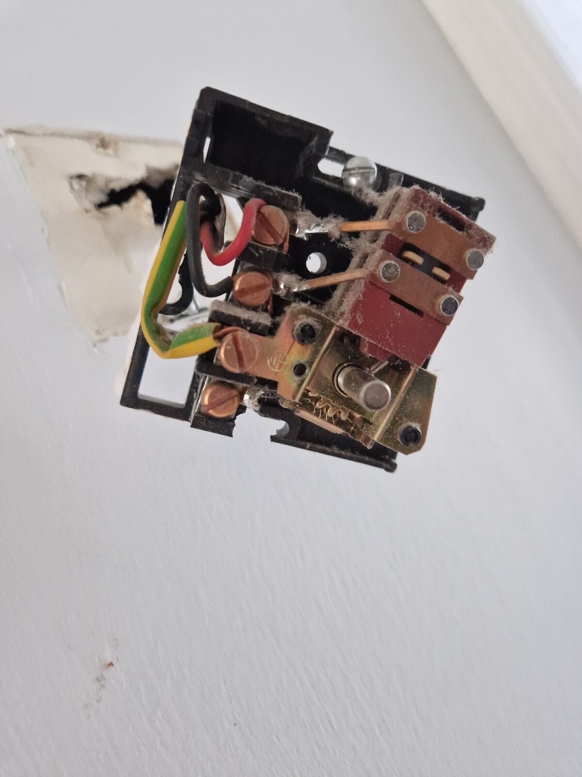

(see pics) The thermostat has never worked since I moved in a year ago and does not power up.
I removed it and have attached photos of the wiring. Looking to see what thermostat is best to replace it with, looking for something cheap that will do the job...preferably a digital one but don't know what would be compatible.
Thanks in advance!

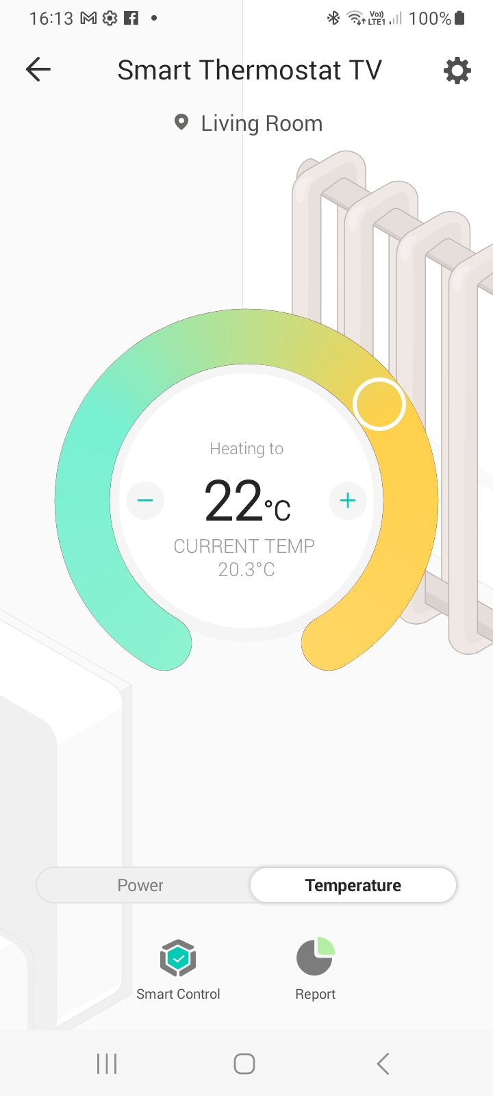

My TRV head shows current and target temperature 1697555710444.pngcurrent it says is 20.3ºC hard to read on picture, but I can use the two readings to set the lock shield valve, I used a thermostat like this ae235.jpgfor years, it cost around £35, powered by battery simple on/off. But tried cheap wireless and it lost the RF link, and was a real pain, so once you go to wireless, the cost jumps to around £125 to get one which will fail safe.

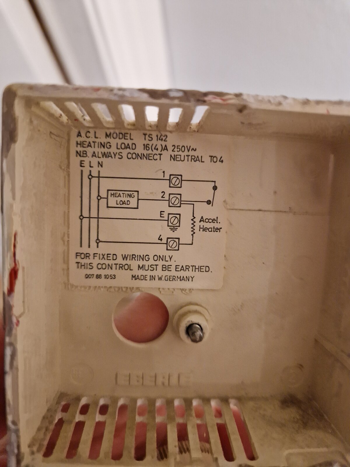

Your old thermostat, like most is a simple switch. There should be a diagram inside the ACLfront cover. Can we see that?
Obviously a simple thermostat will probably do.

Thank you all for your replies. I have attached a photo of the inside of the case. The only reason I am thinking digital is to have an accurate temperature reading. Not looking to spend a fortune on a hive system at the moment...simply something that's works for now!

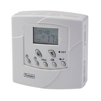

There are only 2 wires (plus earth) to your 'stat, you don't have a neutral.
If you want to keep things simple, cheap and don't want to change the wiring, you could replace it with a simple dial stat...
Alternatively, you could have a battery operated digital stat. Something like...
Or for a 'smart' experience, you could try a Nest Thermostat E.
Other choices are available!
