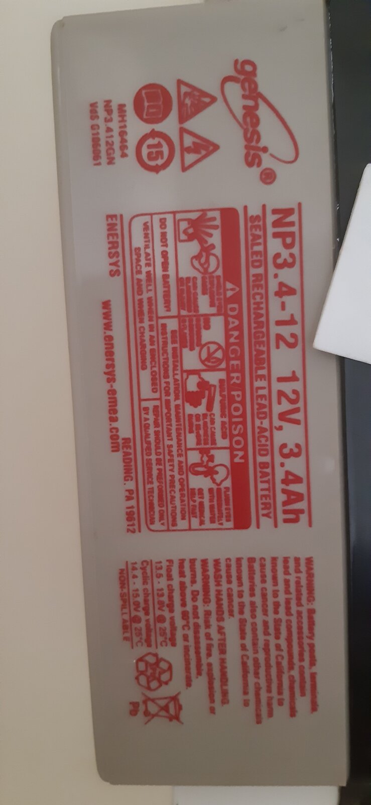

Probably a silly question...it looks like I need a new 12v 3.4ah battery for my old alarm system. All the ones available locally are 3.2ah. Will that do?
Thanks to everyone who gave me advice. New battery fitted and managed to re programme by following the manual. Cost £14 !!
