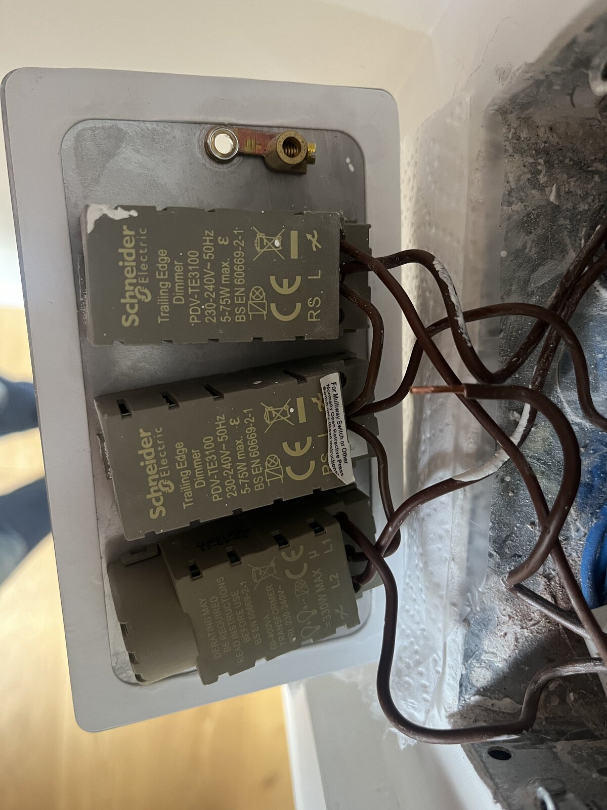

Hello all, I'm an electrics novice but pretty confused. I have a 3 gang, dimmable light switch.
Left switch - 2 external dimmable led lights.
Middle switch - 10 led kitchen ceiling dimmable downlights.
Right switch - 7 led undercabinet kitchen dimmable downlights (the different-looking module)
All working great since full refurb in 2017. Then the right switch stopped working properly - felt like the button wouldn't "click" in (very occasionally it did and lights would work fine).

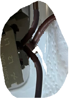

Opened it up, fiddled a bit, and it now clicks nicely again. But lights won't switch on, there's a wire that has come unconnected which you can see in the photo. And much more complicated wiring than I was expecting - the switches are 1-way, not 2-way, yet L2 is getting used.

Right switch 60 - 400 VA, so 7 LED's must be at least 8.6 watts, since likely wanting to run at 50% then really double that, so around 18 watt each, which is unlikely.
The other two are 5 to 75 watt so well within spec.
As to wire, seems most likely this
terminal on centre switch, but can only guess.

I look like the middle switch has 3 wires into 'L', in which case I'd assume the odd wire goes into '~'

4. I have put the loose wire into the middle switch ~ as suggested.

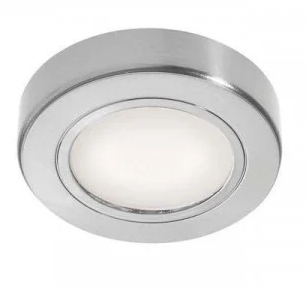

So the undercabinet round lights are 3W Leyton round cabinet downlights. There are 7 in total - 5 down one side of the kitchen, 2 on the opposite side (if that's what you mean by "2 different power supplies"?

I'm making a guess the two brown wires at the dimmmer go one to each group.
The Leyton undercupboard lights I know are
12 volt units and require a transformer/powersupply/driver which are often screwed to the bottom of the cupboard or laying on top.

So as someone suggested, I put all the wires into one single terminal on the "right" dimmer switch. They all turn on, but the undercabinet lights did could not be turned off. As you say, SUNRAY, they are 12V units.
But the plot thickens - I was having issues with a bedroom ceiling lamp. I thought it was the bulb, but the bulb is fine. With all 3 wires in one terminal, that bedroom light turns out. When I start changing the wire positions, it stops working. This is obviously a crazy situation, so I'll have to get an electrician in to look at this properly, far beyond my abilities. It's just bizarre everything seems to have been working perfectly for 7 years.
Many apologies, I didn't get notification of the more recent replies - but thank you to you all!
So with those 3 wires in the same hole all the undercupboard lights are on. That demonstrates the lights, 12V power adapters and wiring is good. And the problem is the dimmer switch.
