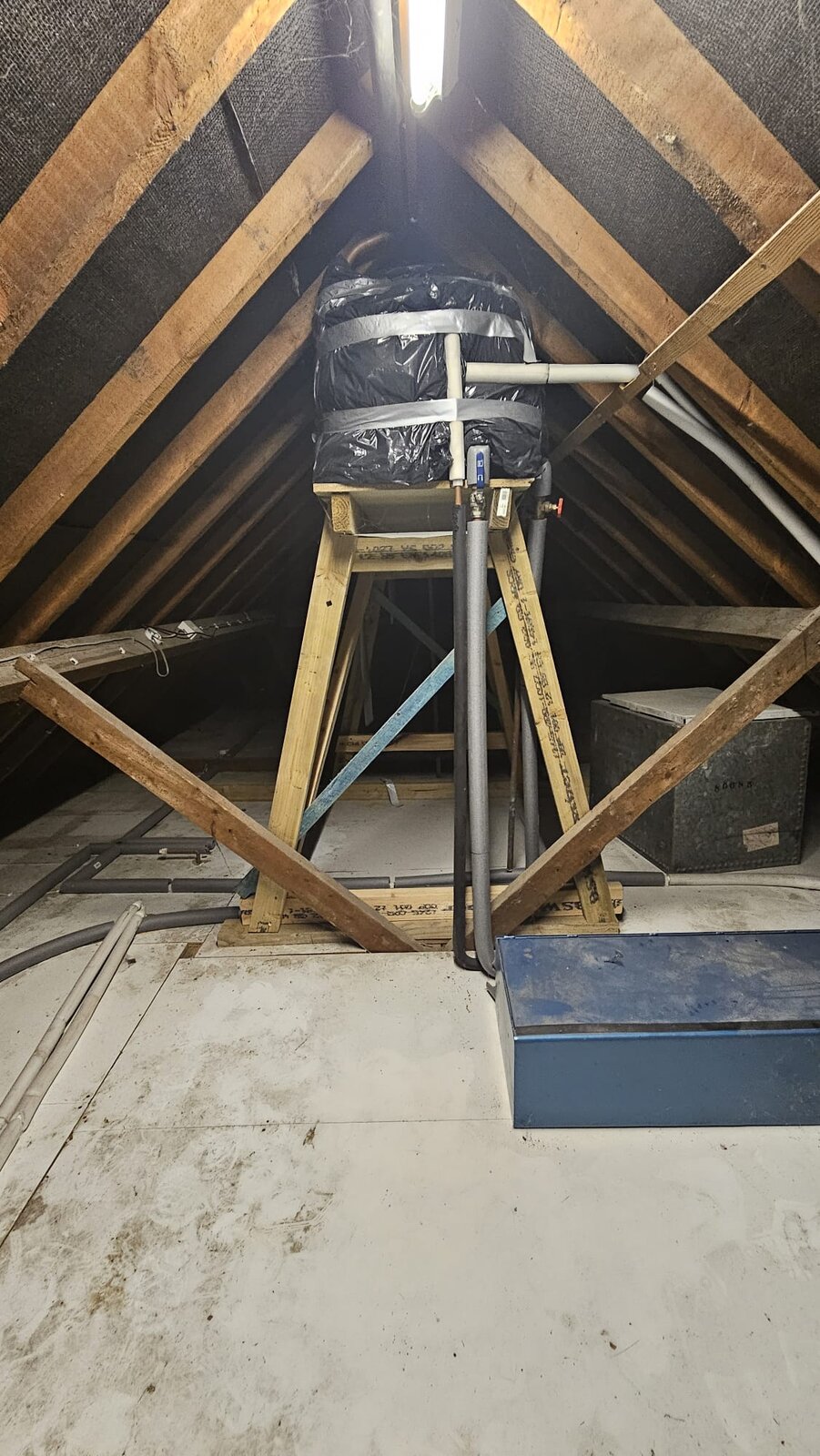

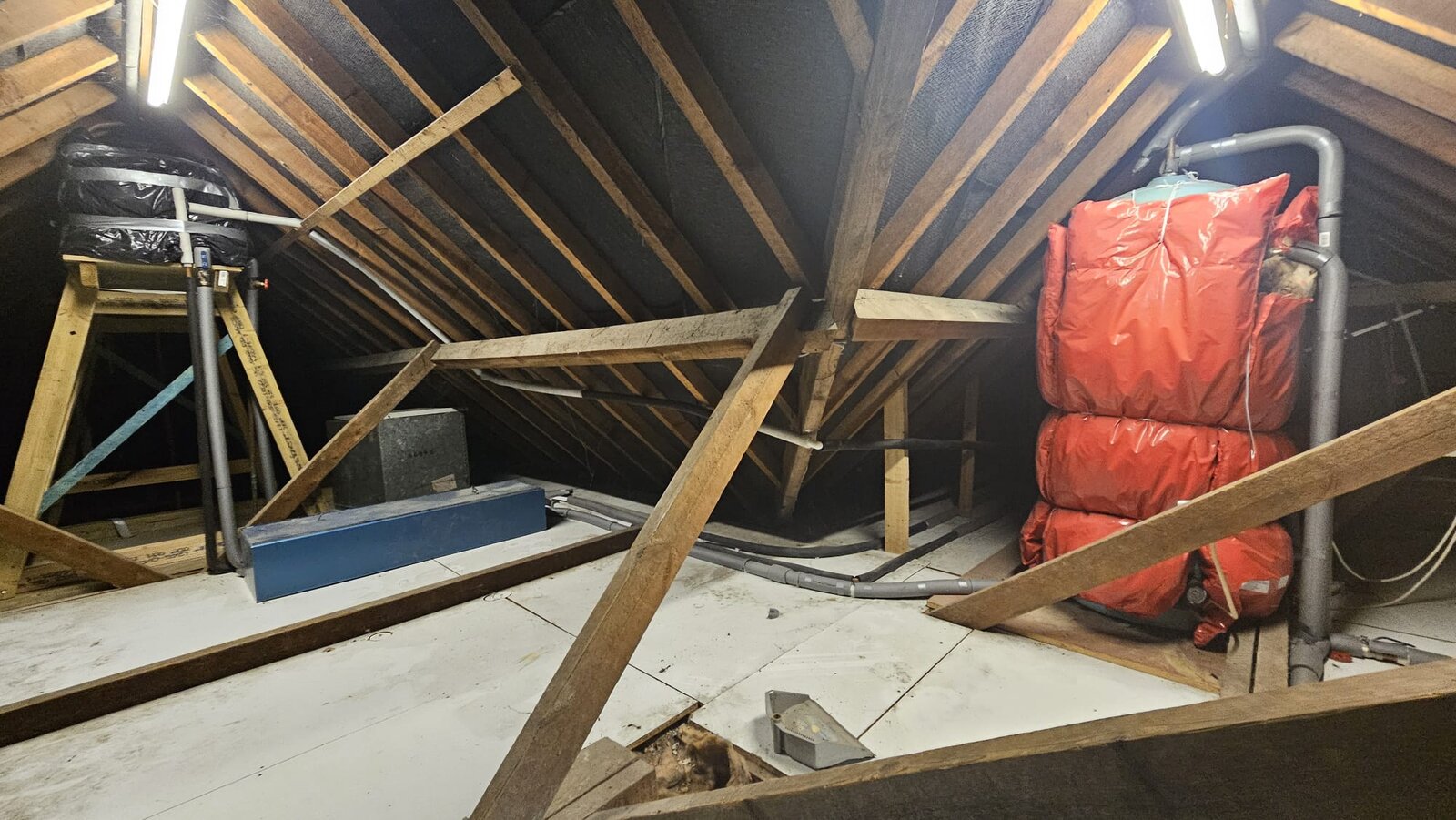

Attaching the photos of CWSC that feeds the HW cylinder.

Open vent on cylinder, check for any air in there. Could be valve or worse still flow switch on boiler.
Hi @gazfen. Thanks for you reply. I have tried that in the past and although there was some air trapped in there it did not solve the problem.
