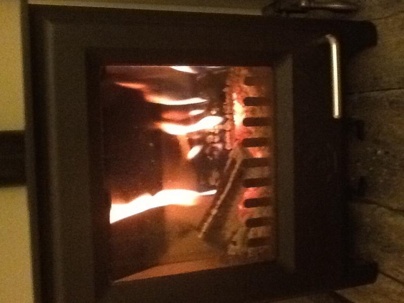

Well that's the plans finally approved. :D
I have nearly finished the install so will post pics once i paint it.
Mega thanks to everyone who helped.
Graeme
