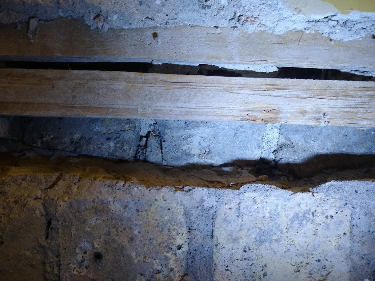

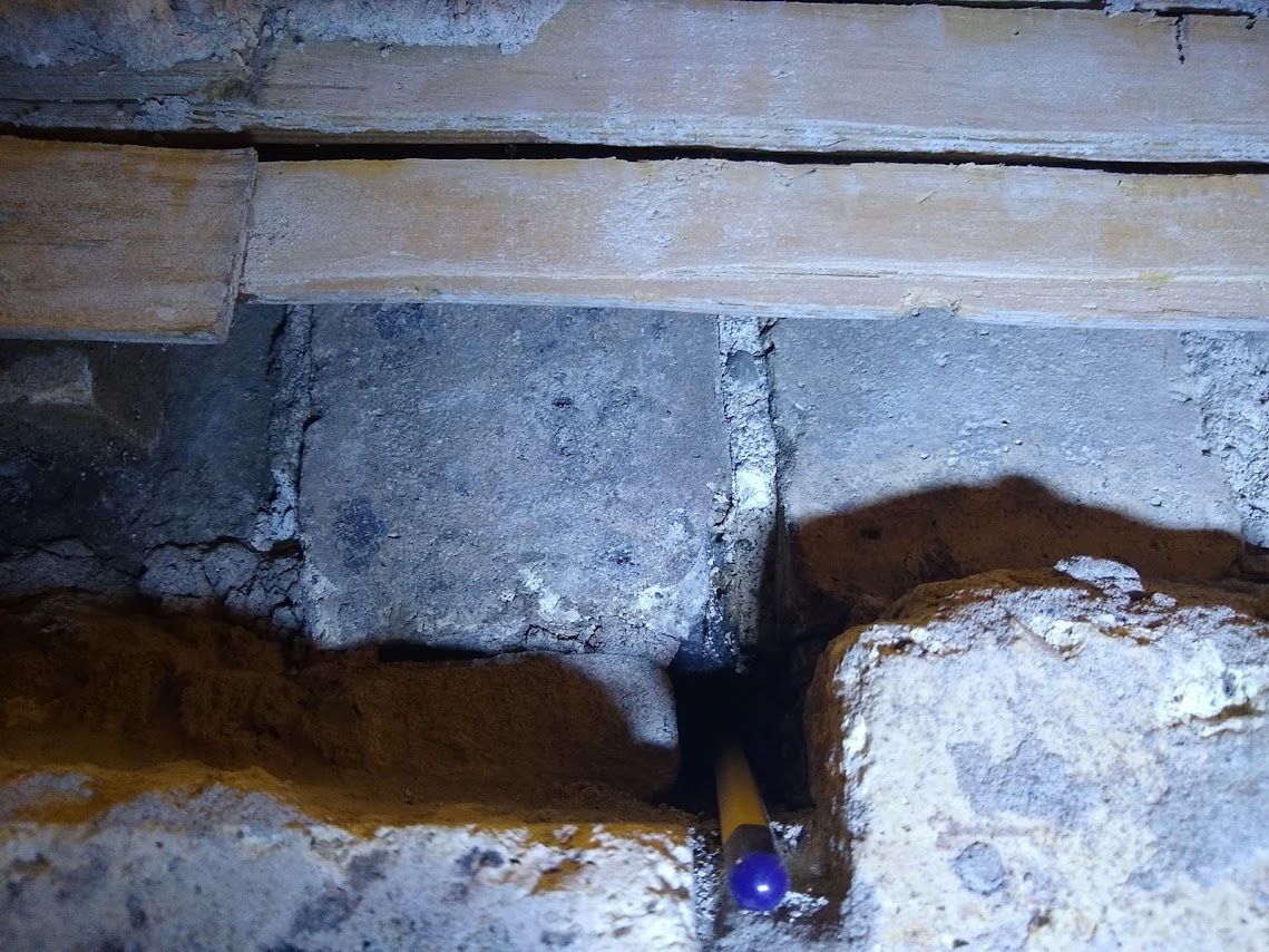

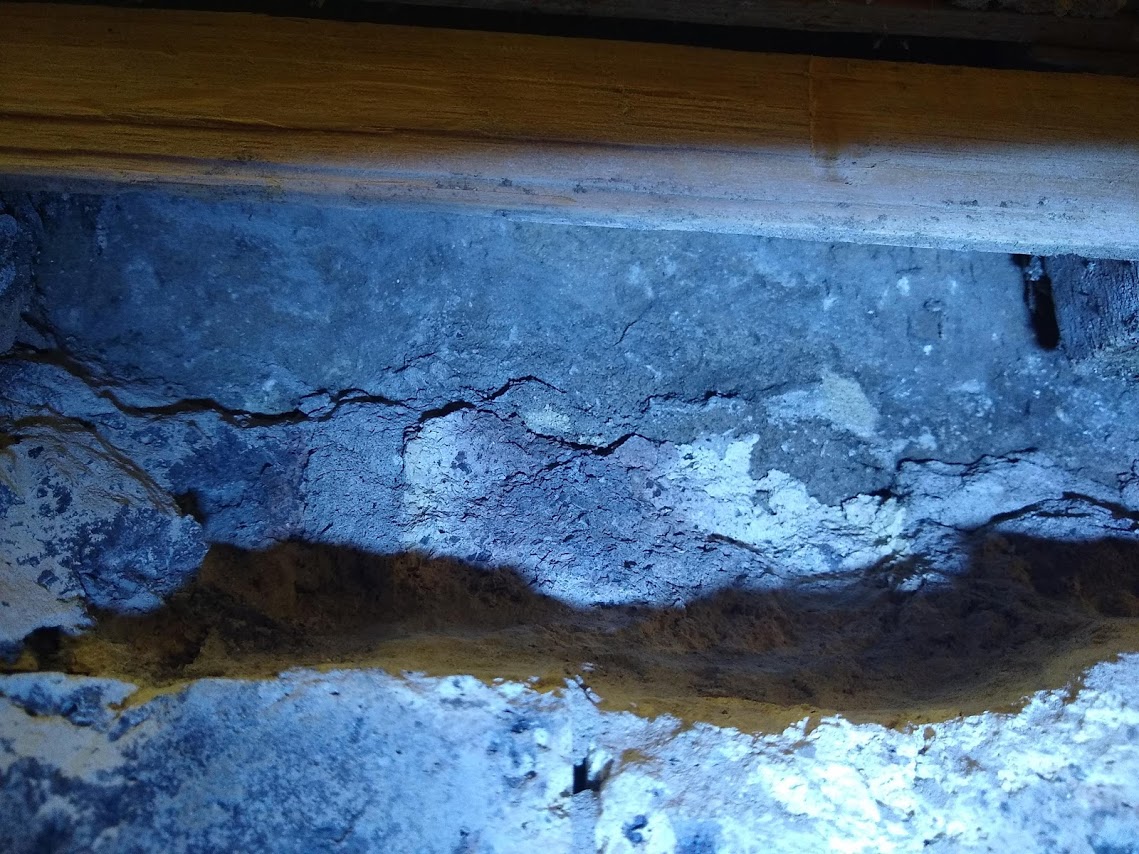

The main query concern is there appears to be no structural brickwork on the front chimney leaf so to speak (I can't see the rear wall clearly but behind the gas fire brick back it looks to be stone work again), with a stone and brick mix course at approx 57" then purely stonework above that. TBH, it was not what I was expecting, as stated had assumed there would still have been a brick built chimney.
I would stick a strong boy into the mortar bed but unsure which if any brick course its worth doing it in due to the final course layer being as described - part brick soldiers butted up against stone. I will upload some close ups to see if it can be see.
If you could be so kind as to state why the gas installation was dangerous I'd really appreciate it. The flue will be smoke tested and cleaned before installation of a steel liner, although as stated it was relined during renovations and alterations in the 90's. Even if good it seems the general advice is line with steel flexi to aid more modern stoves. Thanks again.
First pics shows the far left brick meeting stone. Pic 2 is the stone to the left (hard to see). Pic 3 are the bricks to the right. One course, mixed stone and brick? Appears to be final course of any bricks seen.
View attachment 202187 View attachment 202188 View attachment 202189
