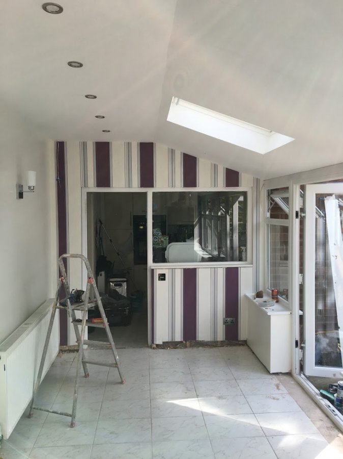

Operation Conservatory Modernisation

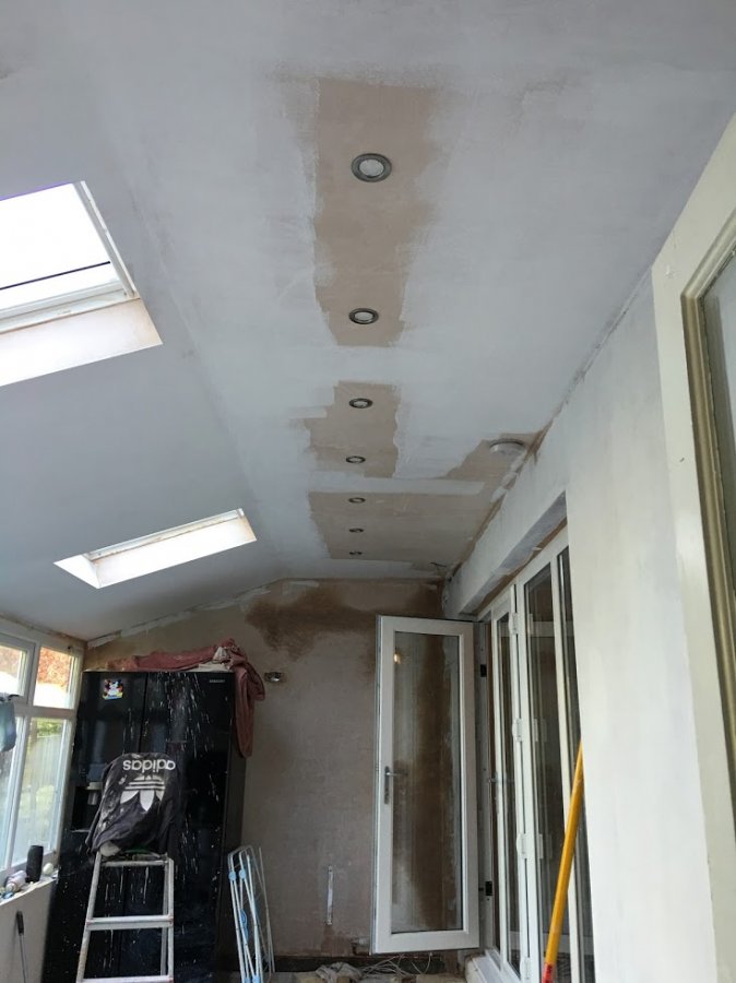

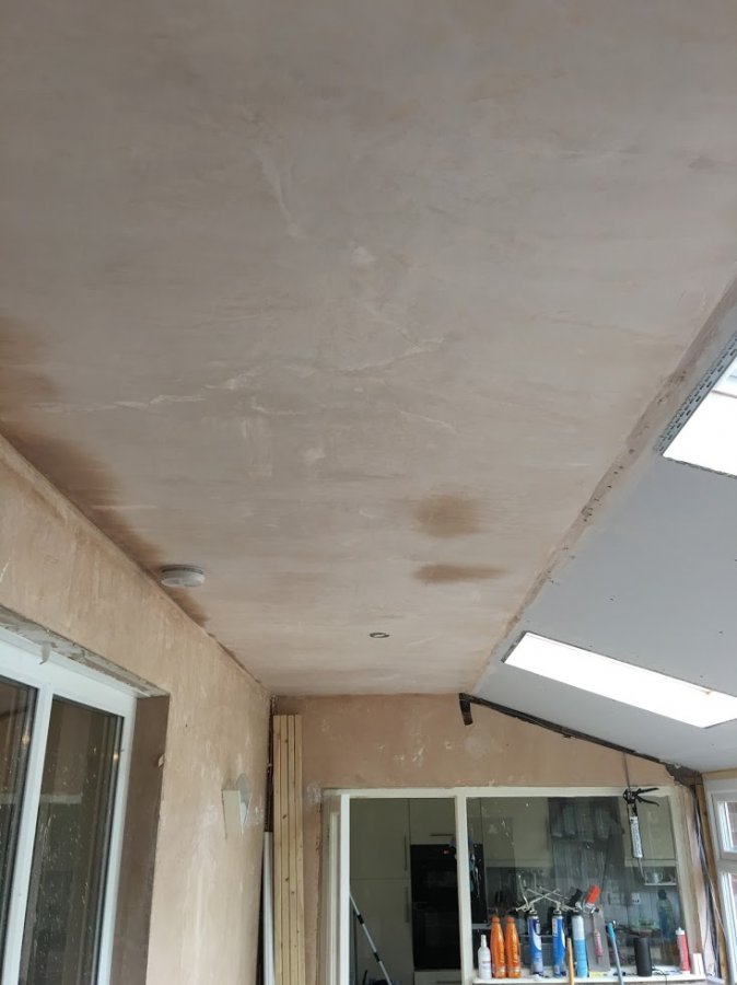

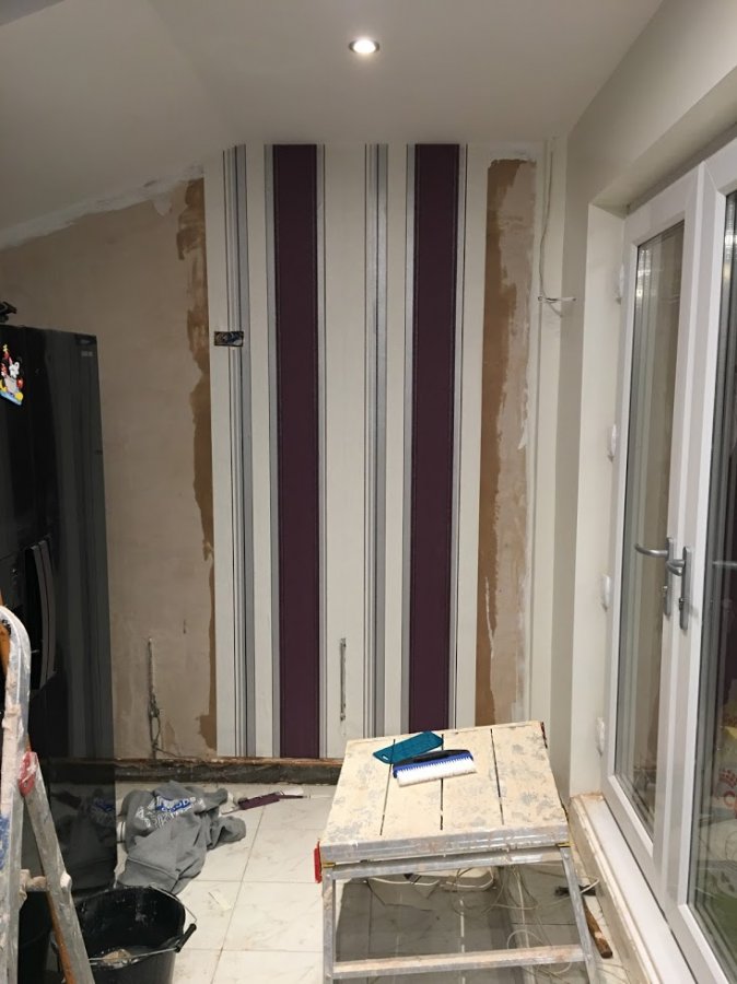

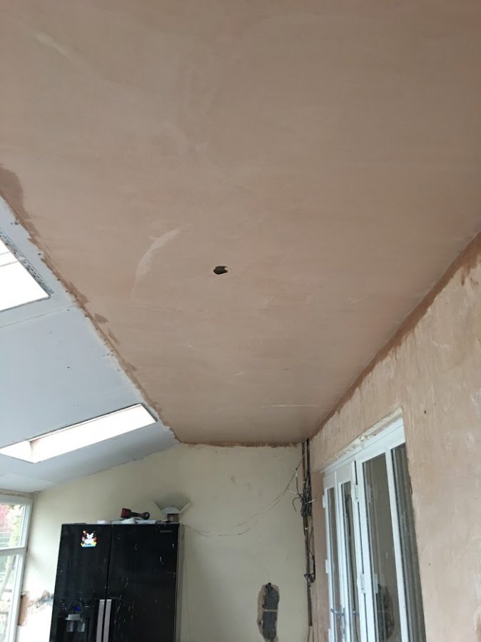

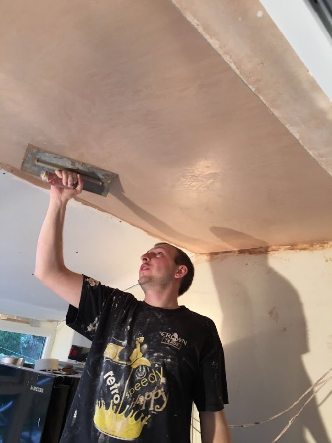

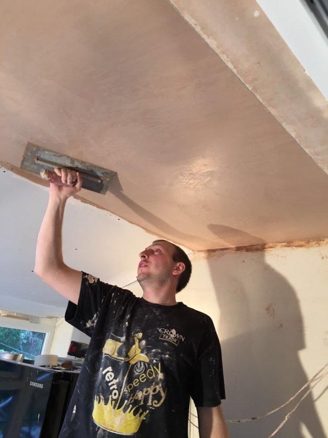

Skimming starts, nice easy wall for the night.

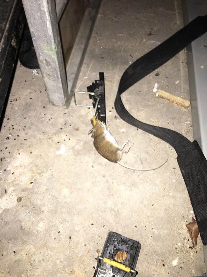

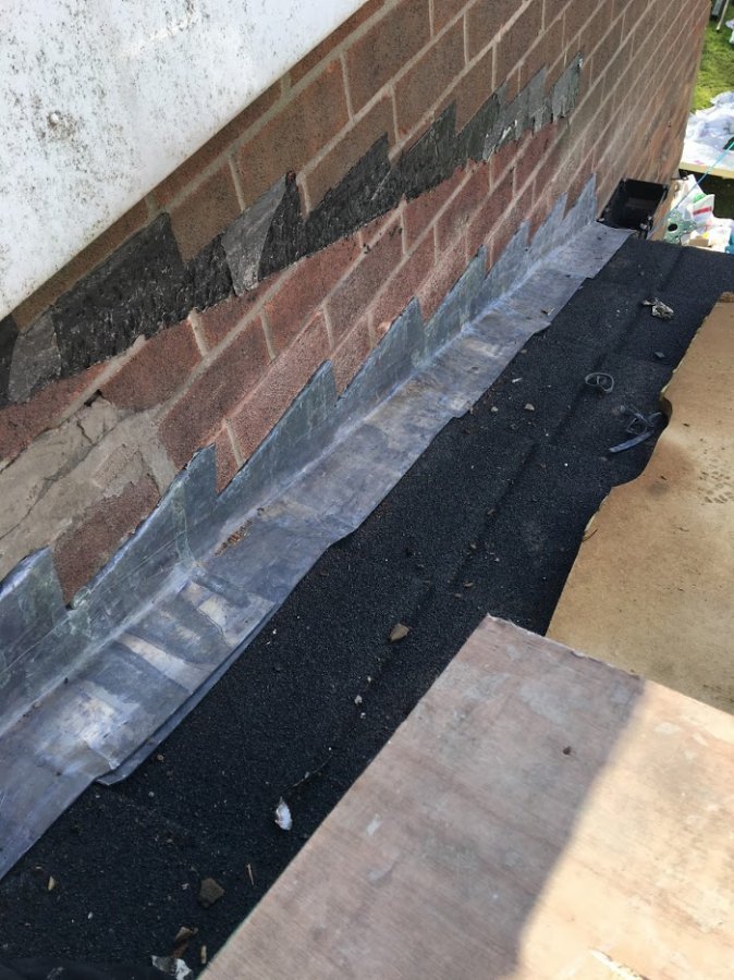

Noticed poo in the garage...
Had a go at flashing myself, in public!
More skimming

should have just bonded this wall out!
Not a bad finish

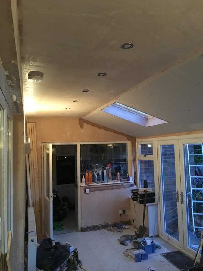

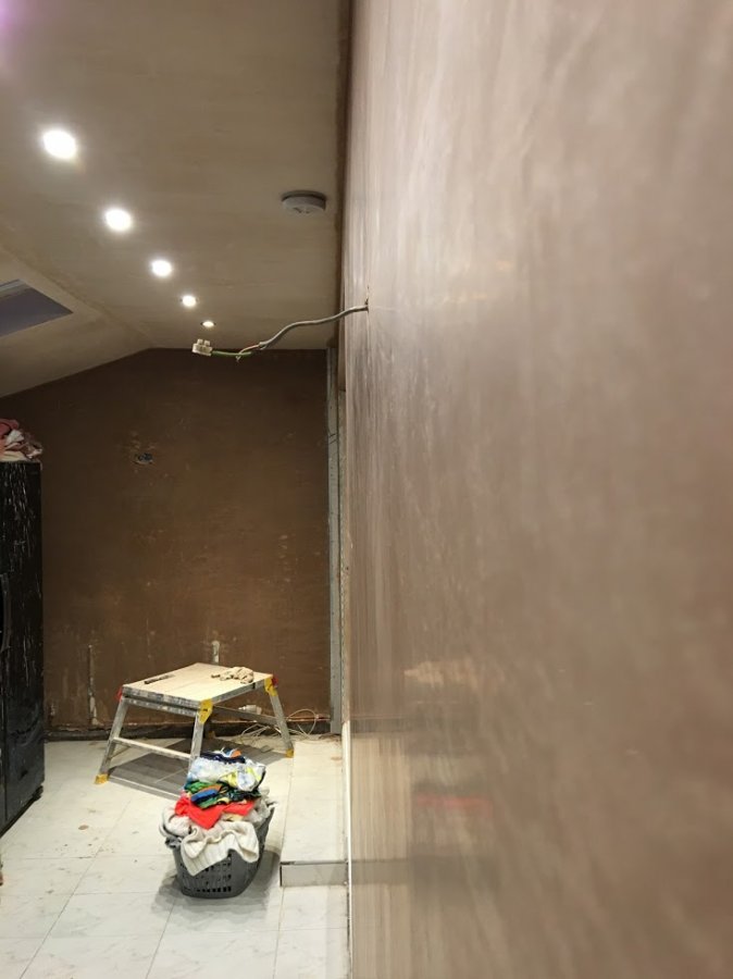

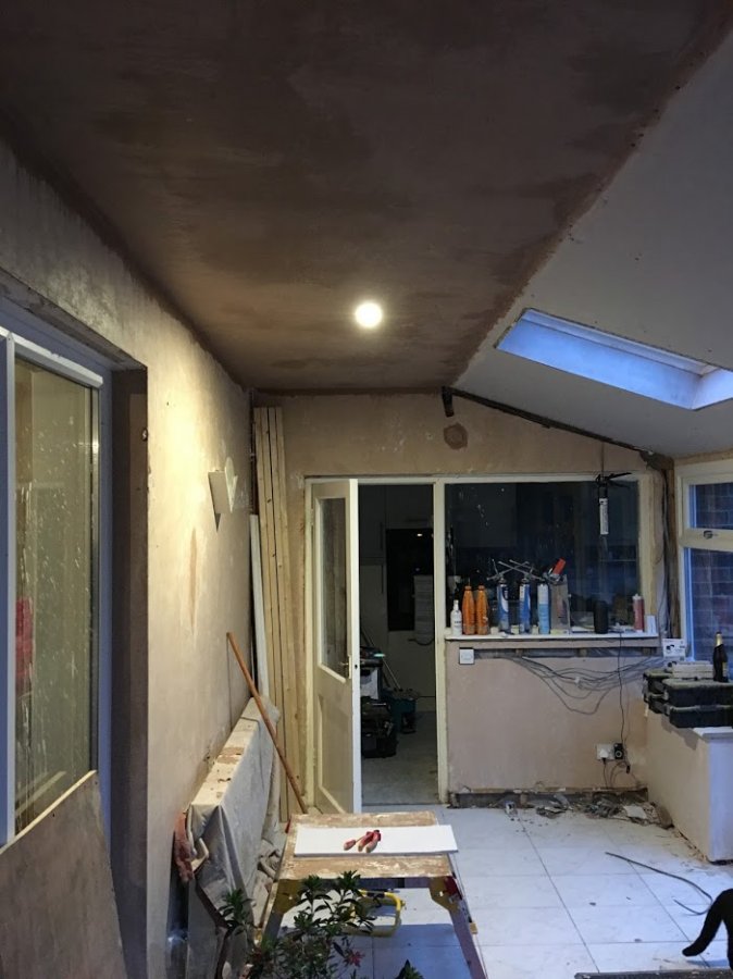

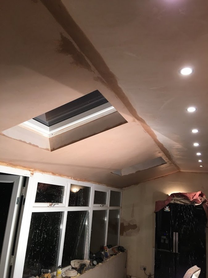

Lights in. I know regs say my mains smoke/heat sensor has to be 600 (from memory) from any wall but shh!

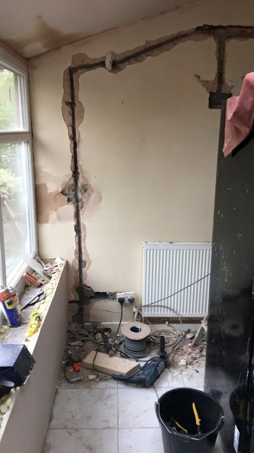

Wall chased out for tv and outdoor sockets
And filled back in
another guage down

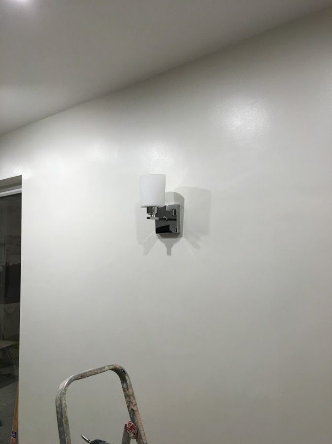

Lights and paint on
another wall done - if i could do things diffrent, i would have cut my ceiling boards and kept my join neater between the flat and the sloped.

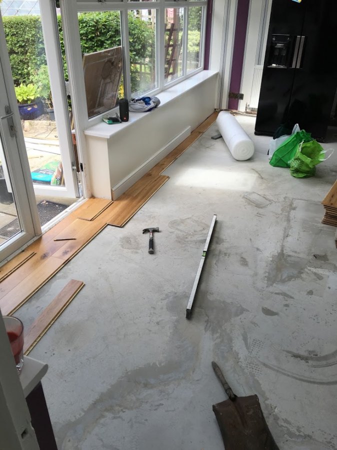

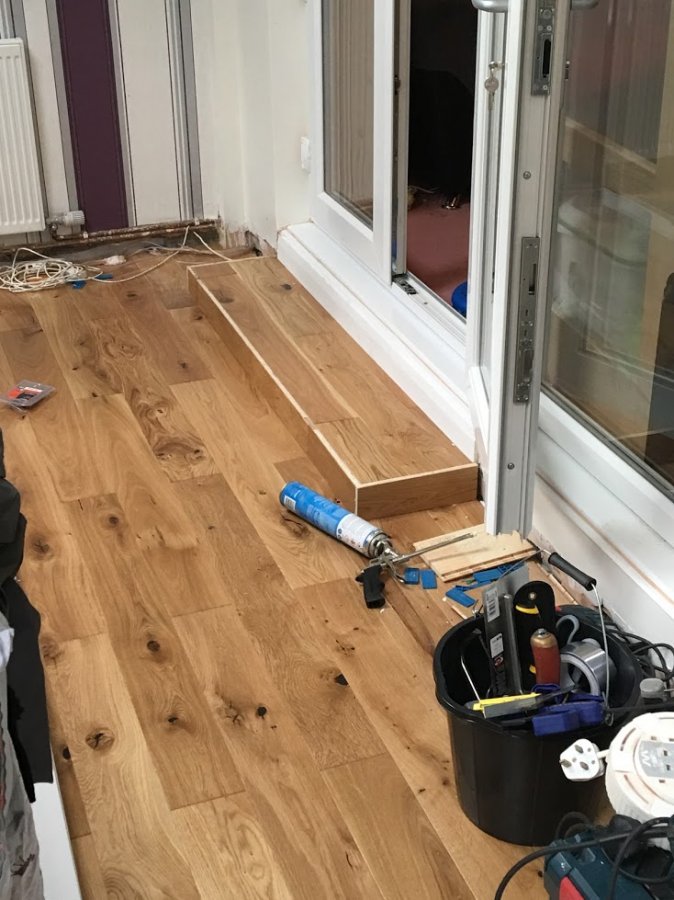

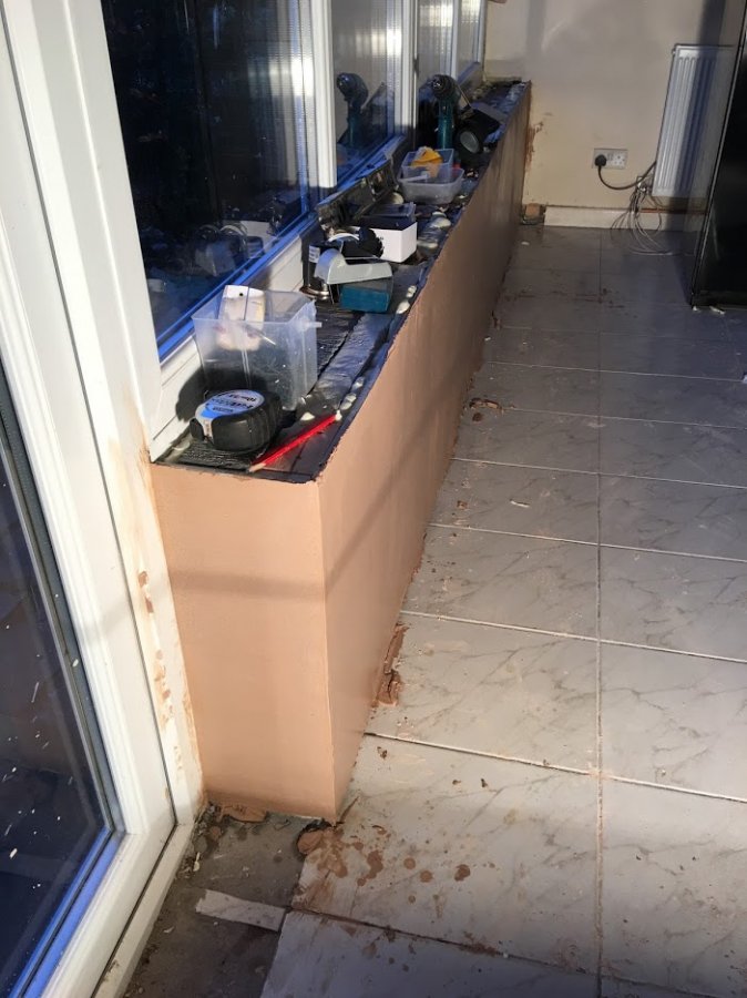

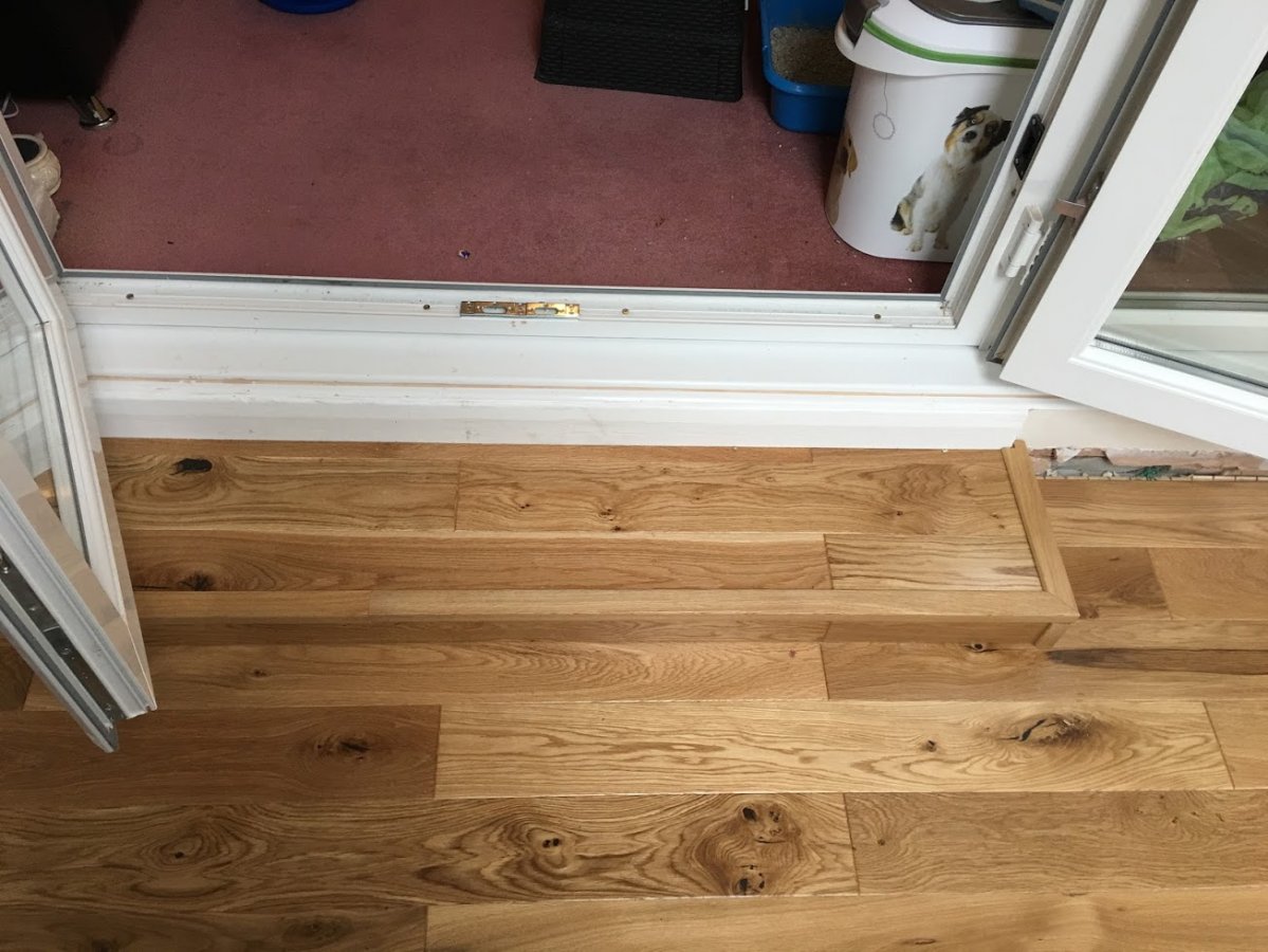

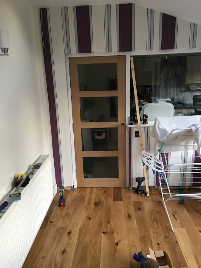

Time to level the floor,
Nice and dry and time for some oak!
Kids wanted a paddling pool... excuse to get us one too! haha.
I didnt plan for the step now did i!

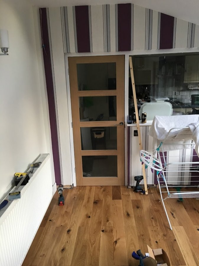

Manged to find some stair nosing.
Door on

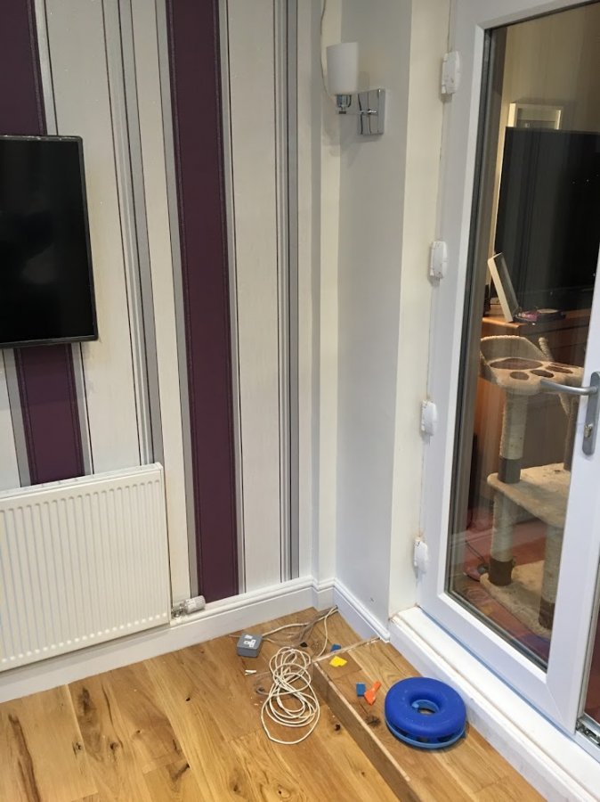

TV Mounted and skirts on

Hi that a great job, I wanted to do this to my conservatory but my council say they want footing of 1m and I got 600mm. Did you have any issue with your council?
Thank you Bloom, I didnt need to get planning for this mate. I had 600 - 650 footings too which is why i went with the lightweight roof.
The footings question is about Building Control, not Planning Permission. A solid roofed conservatory is no longer an exempt conservatory, so needs Building Control approval - specifically, they want to determine whether the footings and the wall structure are adequate for the roof.
Ahh of course, thankfully i did not need to worry too much, i had calcs done on this when i had my extensions done and with the clay ground i was told it was all ok.
