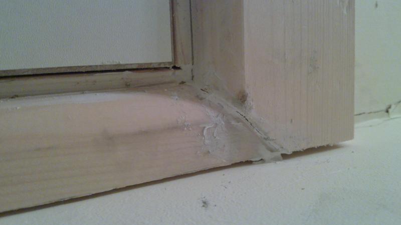

well imho he hasnt really given much finesse to the job,
archs should be a lot better then they are.but a bit of chaulk and paint then it should look ok.
so how much did the job cost?
Mark - it looks pretty shoddy to me. A decent pro wouldn't clagg-on all that filler to the corners ... they would have been accurately cut and not needed filler.

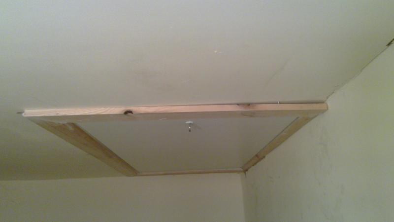

If in this day and age he insists on using oval nails to fix the trimming (that bull-nose architrave) then he should have 'set' the nails below the surface ready for decorator's filler and he should have avoided bruising the trim's surface will badly aimed hammer blows. He should have considered fixing these with screws so as not to further disrupt the plaster ceiling (a good rule is when fixing above or below plaster ceilings is to use screws as hammering causes vibration which can dislodge plaster). Actually, a decent pro might have used an air finishing (brad) nailer to fix these trims. He would have attempted to scribe them into the ceiling contour to avoid those gaps ... failing that he could have considered applying some quadrant, or similar, beading to cover the gaps.

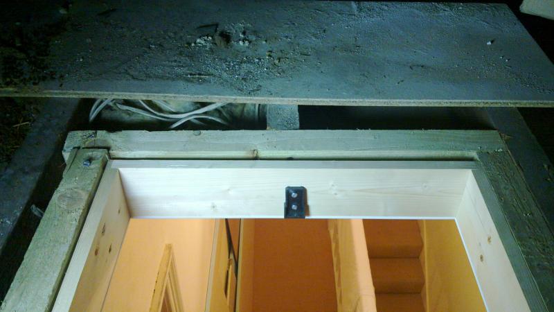

Did he structure with that 4 x 2 in the loft space? Is that (what looks like a large oval nail) splitting the timber near that knot (top left). Did he fabricate that framing in situ just with nails ... any screws used? He should have considered fabricating the frame elsewhere, with screws, then lift it into position for fixing (with screws).

looking at the picture looking down through the hatch on the left hand side where the timber transferring the load for the joist that's cut short looks like there is a gap how is it fixed to the parallel joist
Ah, yes I see what you mean but that's the shadows in the photo. It's the right length, touching the joist, but it's fixed with its top about 1cm lower than the top of the joist. It's level with the ceiling below, apparently. It's secured with one nail to the joist, and one nail to the packer adjacent&parallel to the joist.
The other side is beautiful and neat as you can see - all level, no nail heads sticking out or even visible. I asked why the left side couldn't be like that, but he didn't really latch on to it, said some stuff about the ceiling which I couldn't relate to the question, and that he'd bang the nail heads down. Lovely.
I'm sure CheckATrade will be eager to hear my feedback. Oh, no, wait...
the nail to the packer is supporting the packer ;)
should always have 2 fixings to stop twisting and in case off failure even if its skew nailing [at an angle] from the other side
