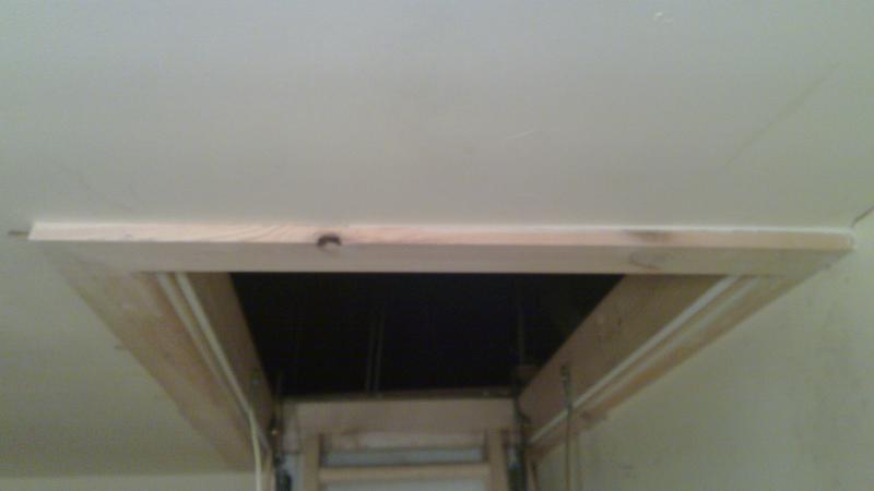

The irony is the bit I was least keen on doing myself was the mitres: I can do basic carpentry, but I'm not good with "finish", getting things to line up perfectly. Unfortunately, it seems, neither is the carpenter we got in to do it.

So he sanded it and squirted some caulk and PVA about. It's still a shoddy mess.
You've given him his chance to fix his work. Don't pay him and get someone competant to redo it..
wow thats bad
why did he fit a 4x2 on the right hand side in the from above pic on pg1?
if he put the frame to the joist it would have given enough room on the otherside for a full archtrave?
on pic 3 or the orig pics dont even look like archtrave, just looks like pse
the from above pics look shocking framework and something id deffo want to change.
it is supporting the cieling joist in the middle as well as supporting the ladder, last thing you want is to step on that joist and it give way or the ladder frame pulling out whilst walking up it. it only looks tacked up
We've had another carpenter take a look, and the consensus is that it's overpriced and not a brilliant job, but it's safe. The structural part is done correctly. (There were more nails in the noggin than I initially saw.) So we'll pay the man, attempt to leave poor feedback on CheckATrade, and not use him again.
That's a very good point. No apparent reason at all!
