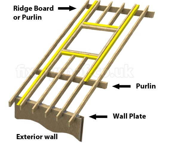

Opinions on insulating this vaulted ceiling
Are all the windows poorly installed, or does it look like just the one with the extra rafter next to it?
Rafters are usually doubled, as are trimmers:
In your case they should run continuously from wall plate to ridgeboard.
Deviating from this practice is possible if structural loadings can be proved.

Thanks RandomGrinch
So i could possibly run some new timbers from the ridgeboard to wallplate, to provide support fixed with screws?

Your biggest issue regards insulating is venting, which appears to be impossible with that roof layout. I'd be tempted to fully fill all voids with PIR, fill and foil tape, then add another layer beneath and across the rafters, fill and tape again.
You should double up the rafters each side of the Velux prior.
A hybrid roof is always risky especially for a kitchen. Robust attention must be paid to VCL. (y)
I also hope the ridge is fixed well cos now the collers have been cut out not much holding that in place plus think I only see one nail in the top part of that scab detail

Thanks noseall, does this mean I don’t need a ventilation gap at all? Thanks!
Hi Gonch,
I’d fastened the ridge with some 132mm concrete screws - assumed that’s sufficient?

Thanks Noseall,
So I don’t need to worry about a ventilation gap with this method? Just insulate, exp. foam gaps and then tape?
They are poorly fitted skylights, the roof should have been rebuild really to accommodate those new skylights, how many are there?
