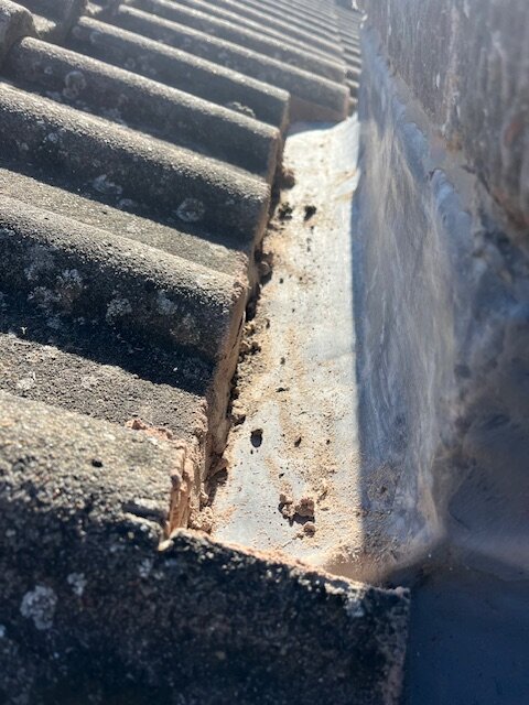

Opinions on this leadwork please
the leaking back gutter ...

OP,
Mortaring the tiles above the back gutter is wrong its possibly causing capillary damp to creep into the roof?
In turn, Lift all the tiles & the all lead around each chimney stack then post pics.
You've mentioned the roof membrane - membrane detailing is sometimes a cause of leaks.
Dont use Flashband.
Your blue bricks are the stack DPC.
Why not post pics of the flaunching on top of the two stacks?
I have now found a guy, fairly local to me, that has confirmed the back gutter work is poor and likely to be responsible for water backing up and getting off the sides of the back apron - he will replace it all, fitting a proper sole plate, doing his own welding and providing a good width of lead to the sides of the chimney. I doubt I would get far chasing the first lot for some refund so the next and last post will hopefully be a pic of a really nice piece of leadwork ... that keeps the water out.
Thank you all who took an interest and gave comments.
