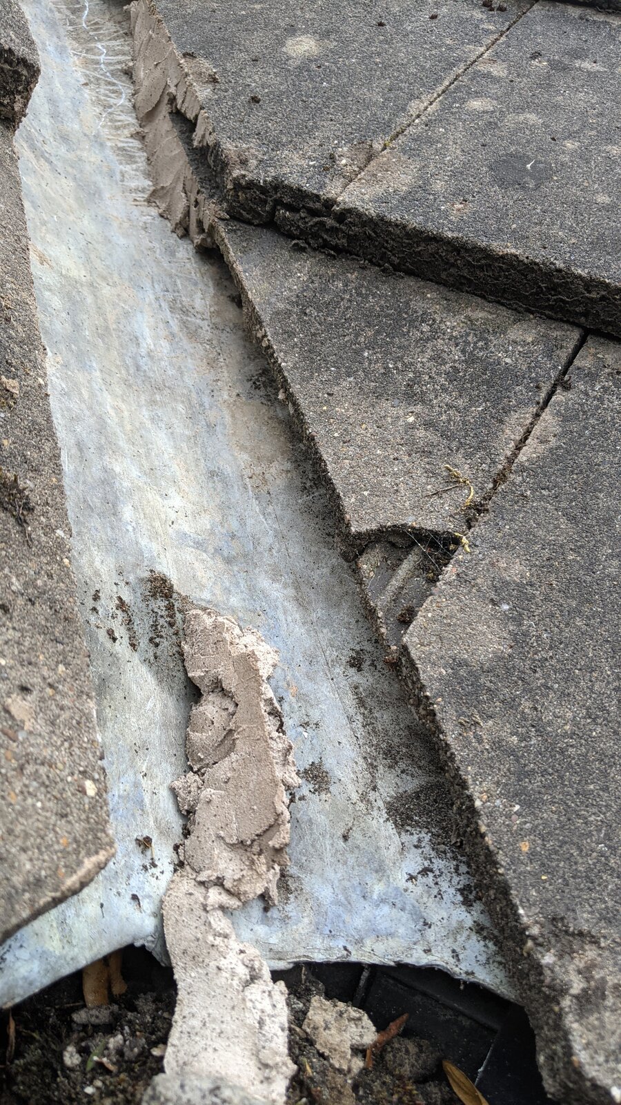

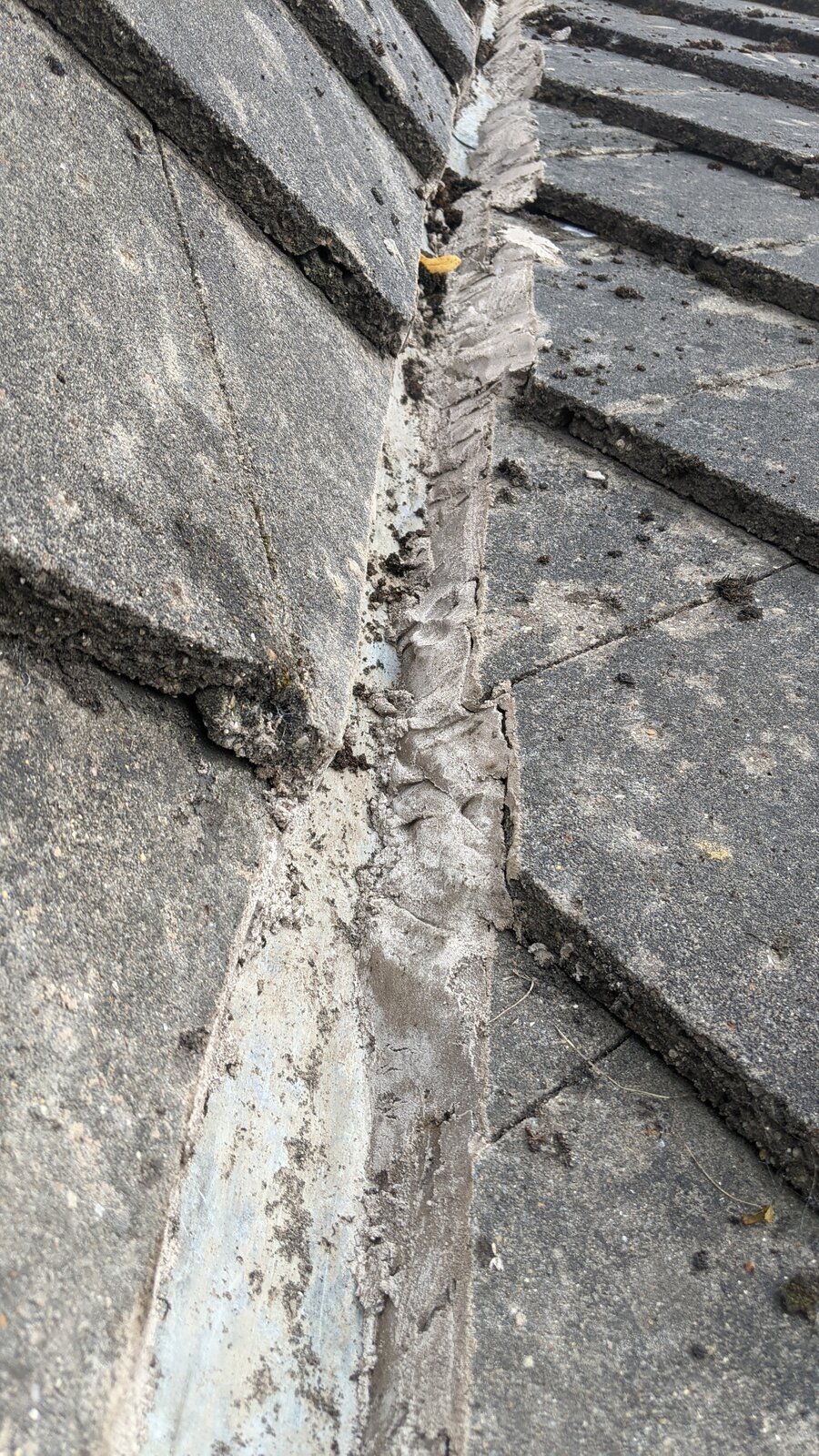

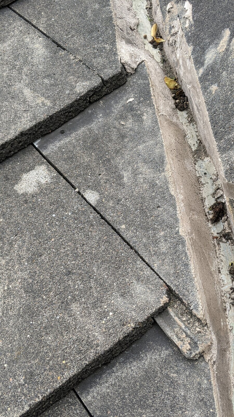

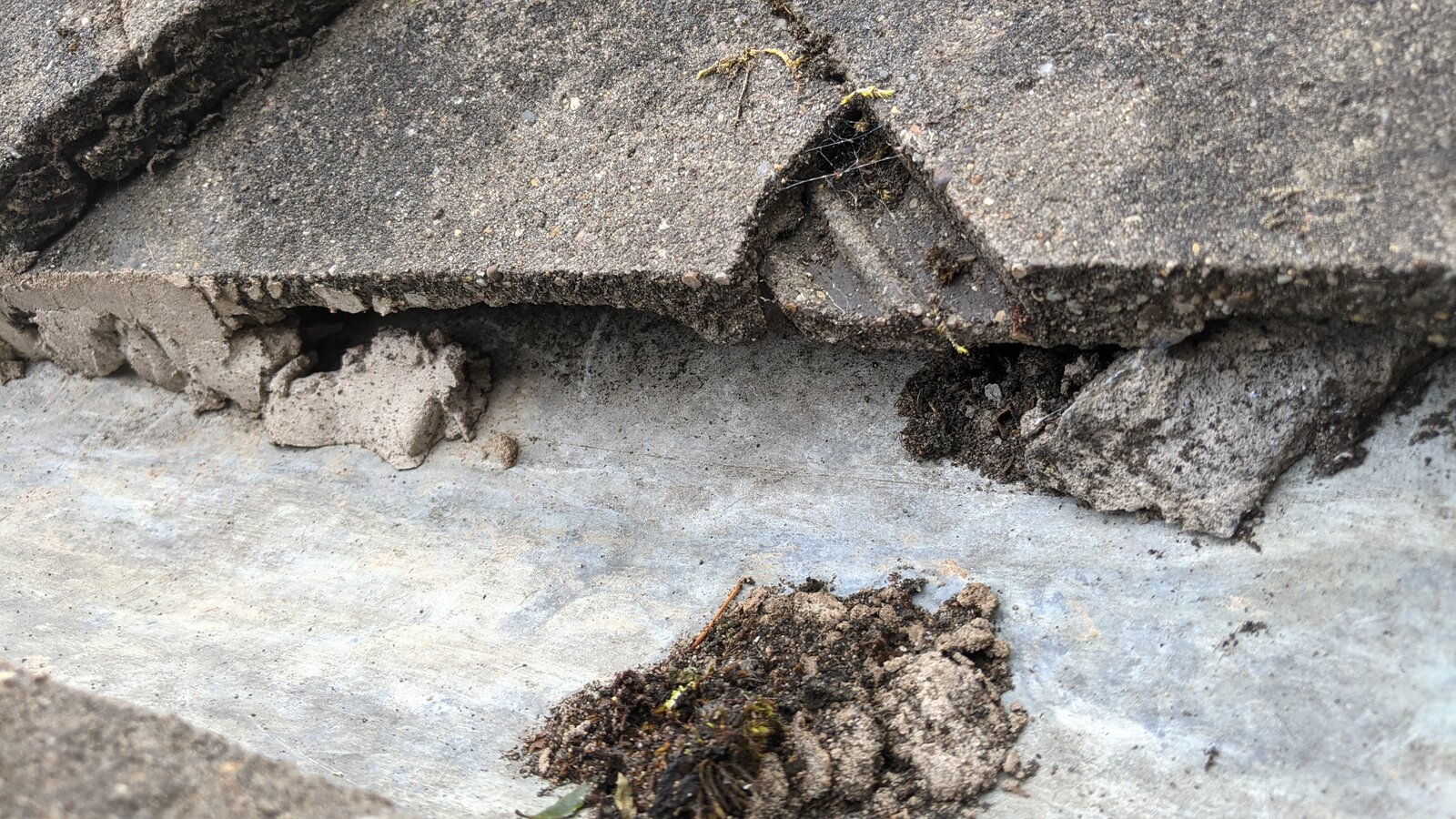

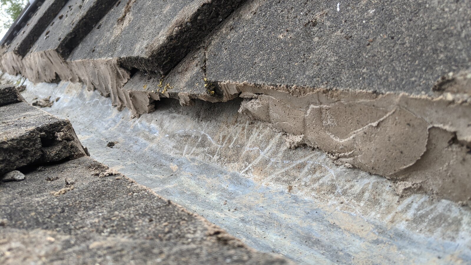

Hi all,
We had a company around to repoint 6 valleys on our roof. I went up the ladders to inspect it 3 days later and it is really shoddy work - gutters full of mortar, pointing missing in some places, already breaking away in others, slipped tiles that have been pointed in without reseating them, valley narrowing to less than an inch, etc.
The company owner and his team are supposed to be coming back to rectify at the weekend but I was hoping for some opinions on what work needs to be done to correct this so he doesn't try to fob me off. I expect he'll just want to patch it, but I don't think that will cut it.
What are my rights? Personally I'd rather he didn't touch it and I hire someone else to sort it, but then I'm out of pocket. As far as I'm aware, I have to at least give him the opportunity to fix it?

I wouldn't say it is poor, more like terrible.... who did it, WTF Roofing ?? I would find somebody else unless he can produce the standard you want at his next attempt.
This is my worry. I'm really not convinced his team have the skills to do a good job of it.

Oh dear, should be half that cost for that standard as it looks very amateurish / DIY level. Was a scaffold used or was it all ladderwork ?

What annoys me is that I'm not half bad at a bit of DIY, including basic roofing. I repointed all of the verges on our old property and they were smooth as butter and still spot on years later when we sold. Since valleys are essentially rainwater channels though, I thought best pay a professional to do it! I could definitely have done a better job myself.
