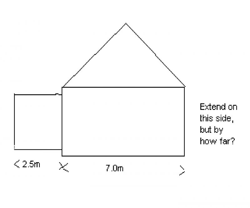

Recently had an offer accepted on a bungalow and assuming sale completes, I would like to erect a 'side extension'. Looking at the planning portal interactive guide, one of the constraints for permitted development of a side extension is that it's width can be 'up to half the width of the house'. The 'house' (bungalow) is 7 metres wide to the front with depth of 10 metres. however, there is also a single garage attached, which is 2.5 metres wide.
Just looking for opinion on how wide the side extension can be, given those measurements - half the width of the living quarters (3.5 metres max) ? or half the width of the entire structure (4.75 metres max) ?
Use the maximum width so 4.75m, provided the garage was either original or has been there since before 1 July 1948.
Yes it's the original garage, property has never been altered (built early sixties).

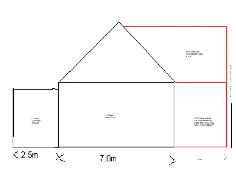

Would like to project 4.3m with the side ext, and running the depth of the bungalow (10m), giving 40sq metres of living area - with a pitched roof at 90 degrees (ridge of which will be no higher than existing ridge).
The planned structure will finish only 250mm from the boundary - interactive guide on planning portal doesn't mention any restrictions with regard to boundaries - however, 5 years back I'm sure any proposed ext that was going to be within 2 metres of a boundary required planning permission.
Have I missed a crucial constraint here? Or is building to within 250mm of a neighbouring property acceptable, given the measurements above?

Nothing planned at the back, strictly projecting out to the side only. Hoping for something like this - if i understand the constraints correctly, the proposed ext will fall within permitted dev?
Careful, here! height to the ridge must be no more than 4m to qualify as p.d.
Yes the ridge will be less than 4m, it's a very shallow pitch on the existing roof (which my diagrams don't reflect).
What surprises me is that a neighbour can erect such a sizeable structure so close to the boundary, without PP - I would be seriously miffed if my current neighbours did this!!!
Yet you seem to be proposing the same? :confused:
Yes, I am proposing the same. Simply genuinely surprised that the authorities allow a structure of this significance to be erected so close to a boundary, without any planning consent.
