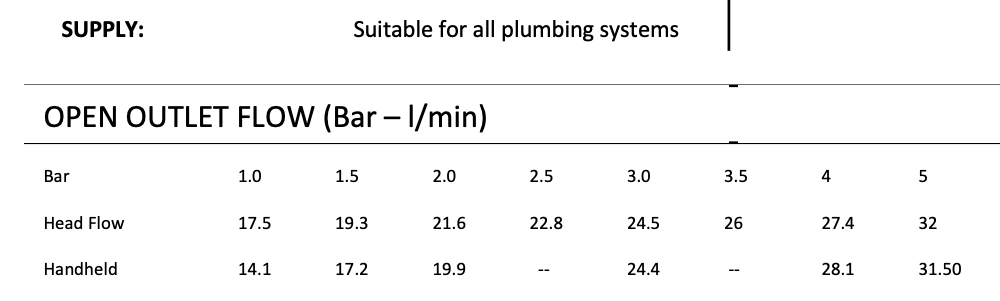

@cross thread the shower spec is the below - but I'm not 100% sure how to match this up to the boiler spec - does this suggest, at a MINIMUM, we'd need 17.5l/min water flow - in which case the boiler needs to provide at least 17.5 DHW l/m? The boiler I've been looking at have a Max DHW of 10.5-15.9 (even with the 35kW models - with exception of the Vaillant ecoTEC plus combination store which allows up to 20l/m). But is that really true - that even the most powerful Vaillant couldn't deliver enough?

All down to pressure - most combi's will deliver enough HW flow for a rain shower head but if the pressure isn't up to it then given the narrow waterways in a typical plate shower head, the flow will be poor. That being said given the flow figures @ 1 bar, then as long as that's sustained (dynamic) then that's your starting point, a quick test of the mains will tell you what yours mains will deliver.
Obtain a pressure gauge from TS or SF, attach it to an outside tap of a washing machine valve, run a cold tap or two and check the reading. Flow is measured by timing cold water at the highest flowing tap into a bucket over a minute and then measure the water volume.
Ideally a pressure of around 2 bar dynamic would be the min IMO for large shower heads, so the hot isn't impacted too much as the cold runs at the same time. Your min delivery would be calculated at an approx ration of 2:1 (H>C), so it you wanted 17L/min then you would be looking @ a HW output of ~11L/Min. The ratio's vary during the year of course as water temps fluctuate.
