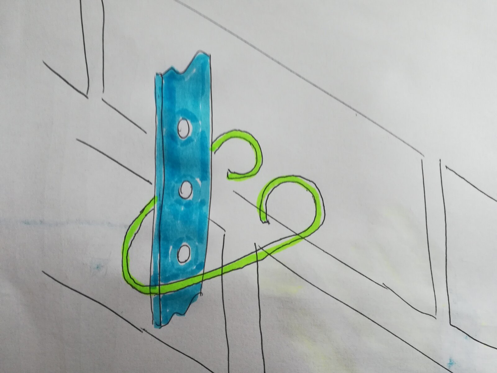

Options for shed roof ties?
Mortar has approximately zero strength on day two, it takes a week to be much more than damp sand. I could probably get away with non-hammer drilling into mortar rather than brick, but then the wall plug might spin or pop the mortar out when it expands.
I'll have a play with the sample bracket, see how terrible it would be to build it in.

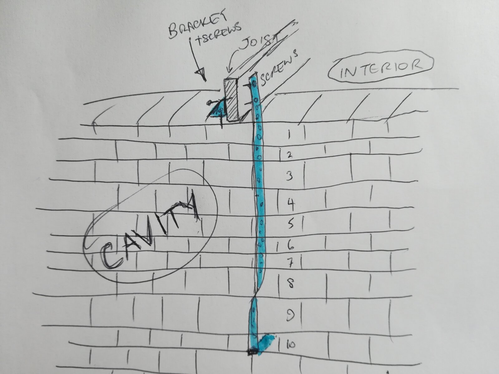

As stated above, I can pop some screws into mortar beds above if it needs some anti-waggle support. Not to take its weight, just to help hold it up until it's screwed into the wood. But if it's ultimately just between the roof structure and anchored very firmly into one brick joint about 10 courses down then that should be pretty good, and a lot better than nothing.
I'll be honest, I never drill into mortar unless it can't be helped.
I'd concrete screw straight into brickwork, but I'm sure your way will work. (y)
I bought the representative (non-twisted) bracket from Toolstation for £2-odd.
It gets held upright absolutely fine by just standing a brick on its tail. But I've yet to find out for terrible it is once there's wet mortar against it rather than just brick.
More experiments will be carried out shortly.
My latest idea is that I'll stand the bracket on top of a perp joint, and tap a couple of nails through it into the partially set mortar below. Then mortar, then the brick above...
It will be held down by the brick above. The nails into the perp joint are just to pin it into place while the mortar above it sets, to stop it falling over.
This does mean they need to go on a perp joint so will dictate where the roof joints go, and at 450mm spacing (2 bricks). But I think I can work with that.
If any of the holes below the twist happen to align with a bed joint then I'll jam a nail in there too.
But above the twist it will just be flapping about. I'm thinking this could be an issue, it will stop the roof lifting but there won't be much resistance against it sliding sideways.
Is this only going to be attached one course down from the wall plate?
Isn't the point of restraints is that you are anchoring to a the wall 1m down, you are adding lots of weight for the straps.
They're 900mm tall, so would be 75mm x 10 courses down, leaving 150mm sticking out of the top to screw onto the sides of the joists.
I can't have a wallplate due to height restrictions of permitted development.
I hope they'll be OK, perhaps with brackets into the top course to resist the sideways forces...
Unless anyone else has a better idea for invisible roof ties? I'm surprised there isn't something designed for the job. I've seen some american thing where they put a thick rod in as a wall tie then hook onto it with a hooked rod from the top. This avoids having the thing flapping about while building, but it ends up with the same thing.
Sorry was commenting on your 'new' idea... not the old one. As per the yellow brick drawing.
It's all the same idea, the only new bit is nailing down into a perp joint to (hopefully) stop it falling over. The previous drawing just didn't show the full length, the second drawing does.
I'm still hoping someone's going to tell me the proper way of doing it!

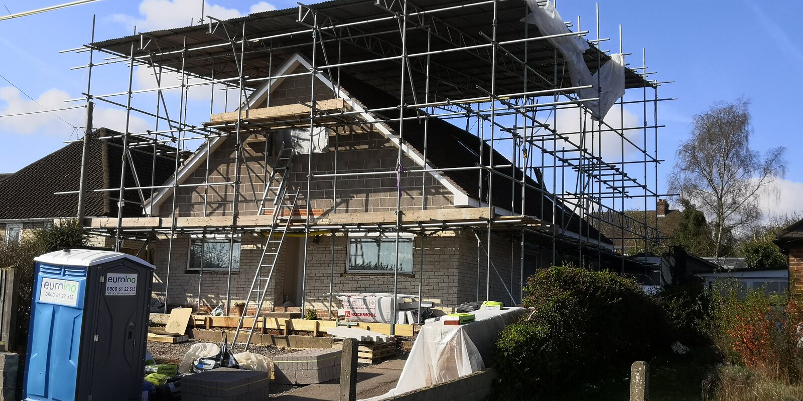

When we did our trussed roof replacement we strapped every 1.2mtr internally. I also used 50x 460mm facade concrete screws through my wallplates into the existing concrete blockwork.
May seem overkill but my trusses weighed 2.2 tons plus the tiles.

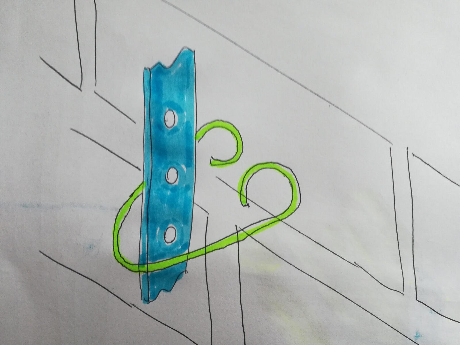

But the issue is that most of the tie will be at right angles to the wall, not flat against it. I won't be able to screw in most of its length so it will be able to bend sideways. So it would resist lifting but wouldn't resist sideways movement very much. This is why I added the bracket to the left of my joist in the doodle above.
I will try bending a wire wall tie in half over the strap and building it into the wall higher up, to give some extra sideways support, kind of like a staple...

I was worried about the risk of drilling into a single-brick untied newly built wall, hence the idea of building in one that has both a twist and an angle. I don't know how real a risk this would be, but I'd be really sad if I put a massive crack into a brand new wall and have to pull it down and start again.
