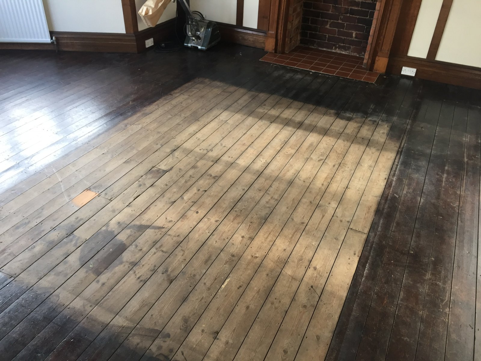

Your efforts seem very similar to mine. My room they had painted that black finish that melts and clogs the sand paper around the rug. The floor sander had not too much problem, but the edge sander struggled.

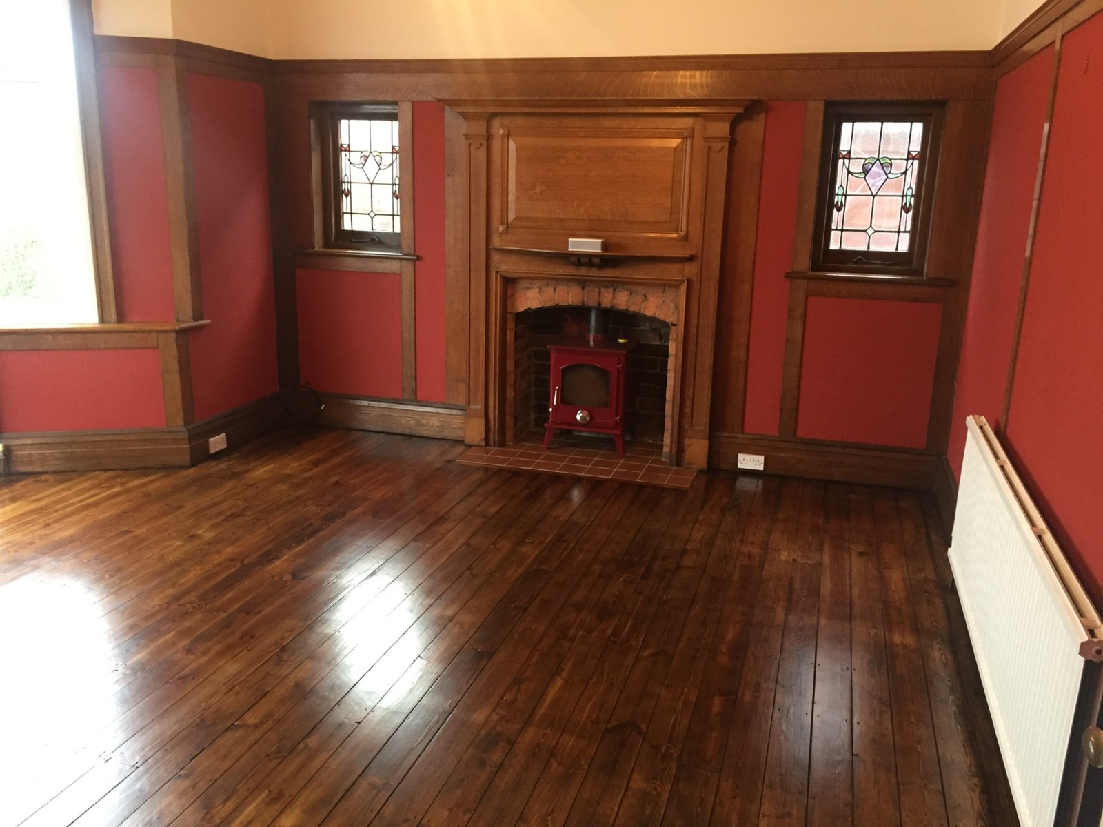

I went with treatex colour tone stain, I went quite dark, followed by treated clear hard wax oil. I went for satin finish but they do Matt and gloss. You need to put it all on nice and thin as mine took ages to dry. All fine in the end but caused me some real stress! The finished pic looks glossy as the floor was wet when taken. I’d use the treatex brand again.
Thanks for sharing. Yes it does look similar, nice job there. It looks like you got away without replacing many boards?

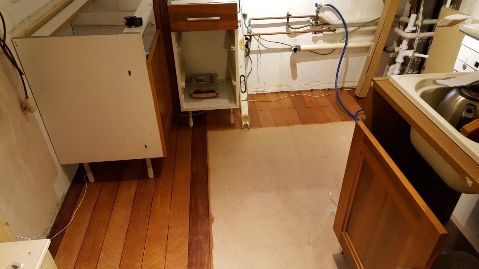

if you have a few jars of dye on the go, you can treat boards with a seemingly randomised variety of similar tints, which helps to hide variation. You can use one basic colour (I like "light teak") and add a hint of brown, red or black in your different jars.

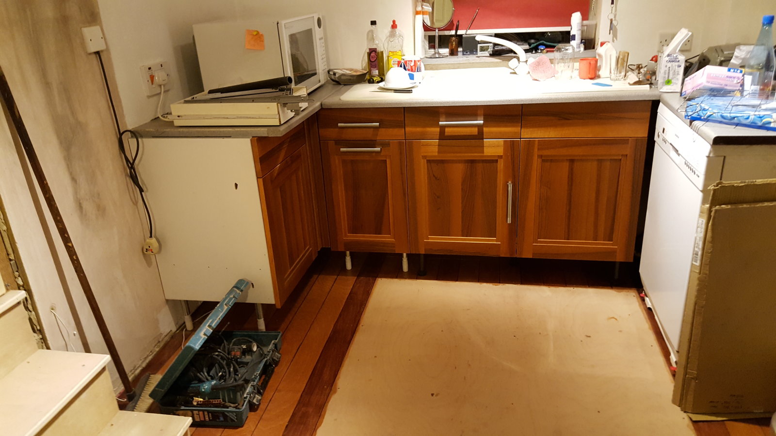

This one has too much variation. I got better results with more similar colours. It's only the floor I dyed, not the doors, to try to make it seem in keeping.
Mahogany dye is very red. Teak has a slight warmth.
When the boards are from different sources they will not match unless you do something to hide it. The very dark one here is IIRC "Rosewood" or possibly "Mahogany" intended to draw the eye away from non-matching boards.
