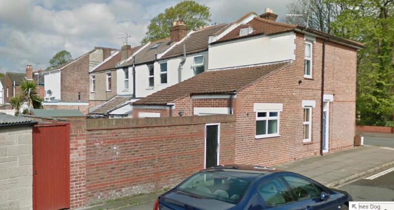

if you have any pictures off the house in 1947 you can maybe prove the footprint as in on google earth move the time line
If that extension was pre '48 I'll eat my leotard.
1. Establish the position of the original rear wall pre '48. Talk to neighbours, look at the other houses in the street etc. There are likely to be other more obvious clues like how it was constructed which will likely confirm it approx age.

it looks like a 60s to 80s extension to me but you cant tell without probing
another point its close to the public highway so will probably need planning any way even iff you can convince them your 1980s extension is 35 years older :mad:

Can anyone tell me if this is something I am likely to struggle getting permission for? I would want a wooden or brick structure the height of which would be just below the outer wall so it was not visible from the street. I would then slope the roof so that it did not obstruct light from the neighbours garden.
This is the first time I would have ever entered the murky waters of planning.
