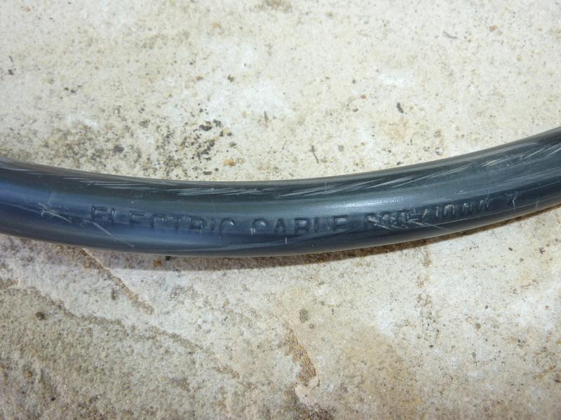

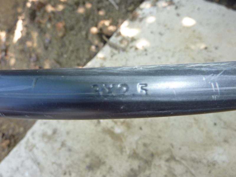

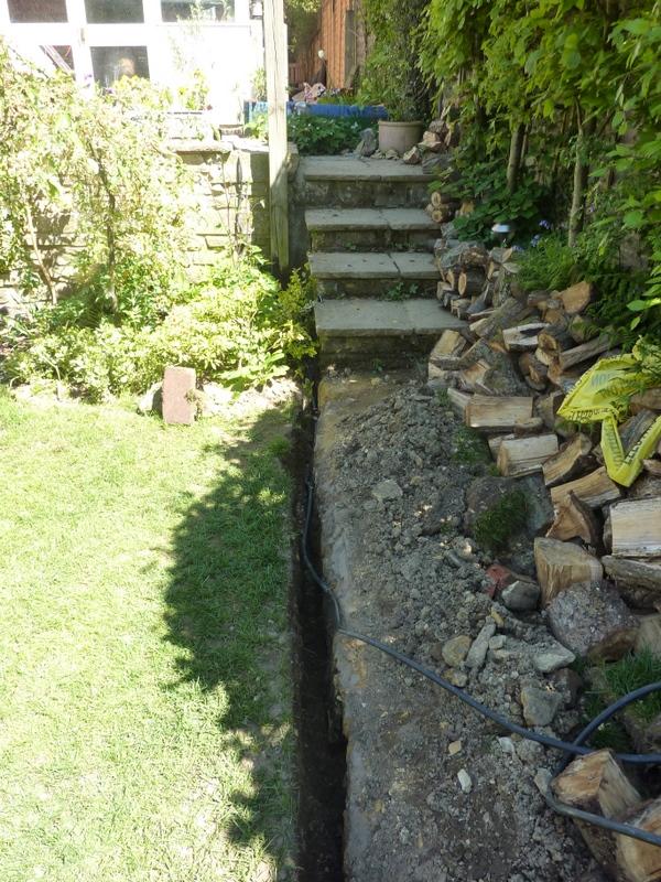

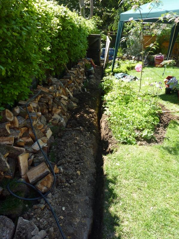

I am a competent DIY'er who has done a few electrical projects in my time but never outdoor work. So far I have dug a trench from the side of my house down to the driveway which is on avereage 18" deep. I'm using 2.5mm triple core armoured cable.

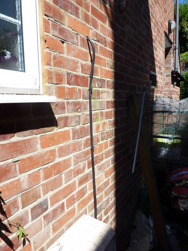

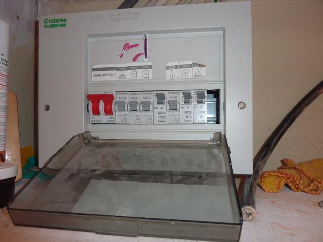

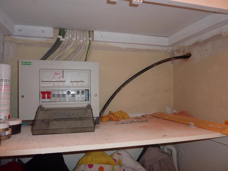

The only thing the previous sparky did was drill a hole through the wall and start to bury the cable down the side alley. He said he could use the empty space on the CU so drilled through the wall near that.

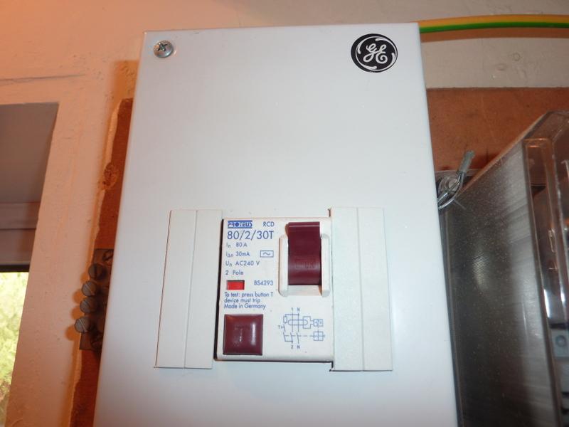

This unit is connected to this RCD

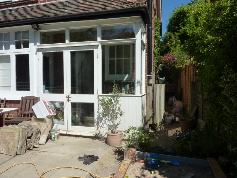

How the job is currently is that the cable is attached to the wall of the patio and is now ready to go into the trench that I have dug down the garden and to the drive.
Ideally I want to have a switch in the porch to turn the path lights on/off

Can I come off of the armoured cable as it goes past the porch (for my garden lights and switch) or will it have to come from the workshop back up the garden path to the porch (in which case I won't fill in the path trench yet)

your "original sparky" was a cowboy.
I think that SWA is too small, you might need 4mm for that length of run and it's too short at the CU, there's not enough length there to terminate it into the CU properly I don't think..
MCB at the house and a small CU at the shed with an RCD in it.
the garden lights will need it's own cable ( so that 2.5mm won't go to waste ) as there's no way to switch them from the porch if they are fed from the shed.. ( well there is but you're getting into RF switches and it gets complicated ).

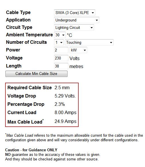

From what I can work out standard buried 2.5mm SWA will carry 21a over 38m whereas XLPE will carry 25a, so you really need to know what you've got and your expected load before you go with that cable, you're probably looking at a 20amp breaker by the way.
You could terminate the internal SWA in to an isolator/switch and run some hefty T&E from there to the CU to make it easier to connect too :)
Dunno how you're working it out, but it's not the right way.
No it won't - not even close.
1) No it won't - not even close
2) The only time XLPE can carry more than PVC is when everything it's connected to is also rated to 90°C, i.e. not very often IRL. The rest of the time it's got the same capacity as PVC cable.
You must leave it as is for the new electrician to look at, as it'll be his signature on the certificates to say it's OK. And you'll need the cable replaced anyway.
That's nasty.
So is that, and as ColJack says, probably too short.
So he was all set to put outside lights on the same single RCD that supplies your entire house.
Yee-hah!!
You're well shot of him - I hope you didn't pay him anything - he's a complete idiot.

I just used TLC's calculator, I guess I input something incorrectly although having another go gives me the same results, ah well.
No matter what I pick as possible wrong inputs - non-lighting instead of lighting, 3-core instead of 2-core, 240V instead of 230V I cannot reproduce your figures.
Any chance of a screen-shot showing how you managed to get them?
I think that when using the TLC website you must select 2 core for single phase installs even if you are using 3 core for a single phase install. Otherwise it thinks you are supplying the load via 3 phase...
Although for a 2KW load at 38m, the doncaster cables link nozspark links to shows the same. :?:
Err...
1) If you specify 3-core cable the calculator will do 3-phase calculations.
2) And anyway that's showing the cable carrying 8A, not 25....
3) Try again with your supposed figures of 21A and 25A loads, and see what answers you get.
