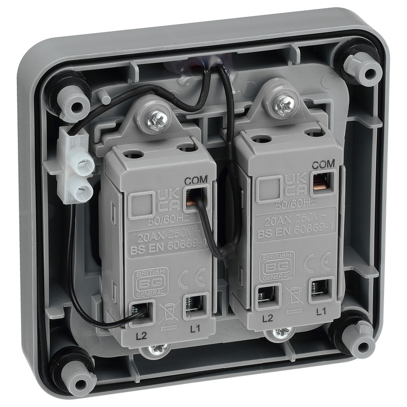

Good afternoon, Please can I have some help choosing a suitable outdoor switch?
We had a new consumer unit fitted a few years ago and the electrician provided an outdoor supply from a 20A RCBO.
This goes to a SFCU with neon indicator (fused at 3A ) in the kitchen and then to an IP protected box on the wall outside.
In the IP box a choc block connects the supply to a string of LED lights (total load 50W) and we use the SFCU to turn the lights on and off.
We now want to take a second feed from the IP box to supply a water feature (also rated at 50W). I assume I need to replace the IP box with an external 2 gang switch so the lights and water feature can be switched independently?
* Please can you advise a suitable external 2 gang switch?
* Is this suitable: BG WP42 IP66 20A Switch 2 Gang 2 Way SP from Toolstation (24607)?
* However this is only Single Pole?
* Do I need a Two Pole Switch?

Thank you very much for your reply.
Please could you also confirm I've got the wiring correct?
I assume:
* LIVE from SFCU to COMM with a jumper to the second COMM?
* LIVE from lights to L1 and LIVE from water feature to second L1?
* All 3 NEUTRALS in choc block?
* All 3 EARTHS in choc block?
Please can you confirm this is correct?
