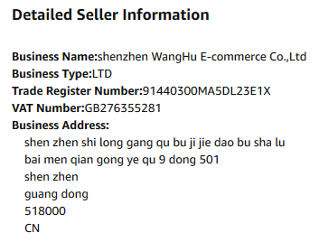

Your pick
£17.95
Free postage
  • Get it by Sat, 9 Mar - Mon, 11 Mar from london, United Kingdom
It is being sold from London. Surely it is bound by UK laws.
No.
There might be a warehouse with the items in, but that is most likely just a place where items are removed from a larger container and shoved in the mail. No checking, no oversight, nothing at all.
If too many complaints arrive, the contents of the warehouse and those within disappear.
The other method is that a large box of a product is sent to students at their rented accommodation, and they get paid some minimal fee to just stick a label on an item and post it. Repeat 500 times with 500 students, and there is your unauthorised, untaxed and invisible UK distribution network. Send your complaints to a disposable mailing address in China.
Selling on Amazon is even easier. Just send a big box of barcode labelled things to Amazon, and they will do the fulfilment for you. Amazon do not check or verify any of those products, and complaints go directly to the seller. Too many complaints could theoretically mean the seller account is closed - but these people have multiple accounts so it changes nothing.
