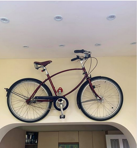

My son has now bought my old house, and he decided the spread was not good enough, so fitted down lights Kitchen bike.jpg not sure on size of each down light, but he is using more power for the same amount of light, however it is a high ceiling, so there is room for the light to spread, and store his wife's bike.
But in the main we fitted 5 foot fluorescent lamps to get the spread, and did not really need the lumen output, so dropping to 2200 lumen from around 5200 lumen is often not an issue, but only you will know that, the fluorescent can have a wire wound ballast or a HF ballast, the latter increases tube output and life so makes the fluorescent tube the same as LED for life and lumen per watt output, but the former can use well over the rated 58 watt, and the tubes don't last as long, so very hard to compare LED and Fluorescent as it depends on the type of ballast.
