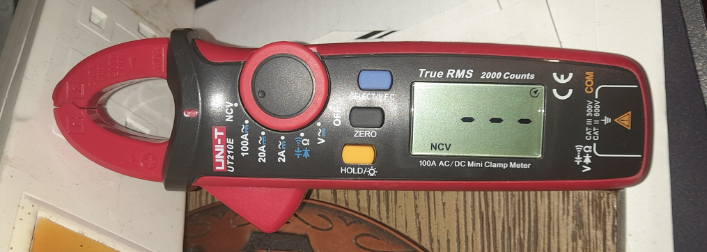

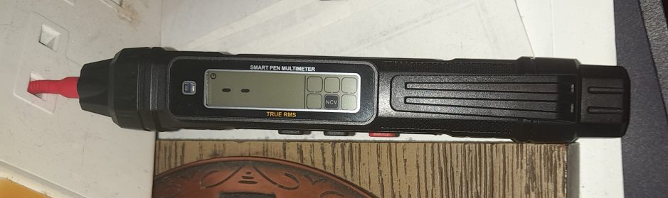

I use a non contact voltage range on my tester 1725523694093.png1725523829262.png to see if any power, both my testers have the function, there are cheaper testers 1725523912362.pngall which should show if there is power without undoing screws, lids etc. Clearly one would confirm with leads, but to start with this shows if there is a line supply.
It may be as simple as a blown bulb, so start with the simple tests. Outside lights are notorious for getting water ingress, so being able to switch off is important. I know my home buyers report included where switches and fuses had been found, is there anything in that, or the EICR (electrical installation condition report) also normally alarms also have a FCU although likely not switched, near the alarm box.
