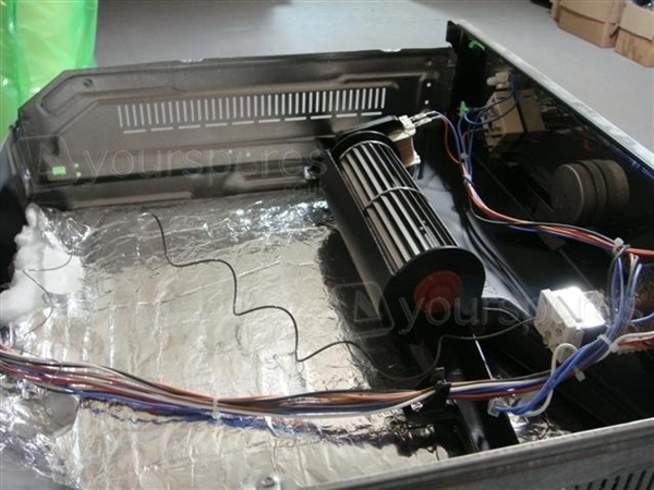

Ok, don't mean to interrupt the legal wrangle but would like to know why the cooker fan is stopping? wsts, you said you know what the problem is but wont tell me??? My neighbour (Mr. 'Corgi' engineer) has said he will pop around to do the job if necessary but thinks I am allowed to change the fan (if that is what is needed?). It has no connection to the gas as it is totally separate and only cools the electrics and takes heat away from the top of the oven (the inside is completely separate, I've looked at the top) - attached is a pic from the internet which although not my oven has the same set up. Is it the fan failing or another component that makes the fan cut out? It would save time and effort if you were to tell me - it wouldn't make you liable.
The fan just makes a humming sound after this.
If the fan is humming then almost certainly it still has power supplied to it. If you have a meter that will measure 230 volts AC and are confident to use it then check the voltage between the terminals of the fan motor. Do it when the fan is running ( to confirm it is a 230 volt AC fan ) and then again when it has stopped and is humming. If there is still 230 volts AC when humming then the fan is in need of service or replacement. Dried out bearings are common fault with that type of fan.
