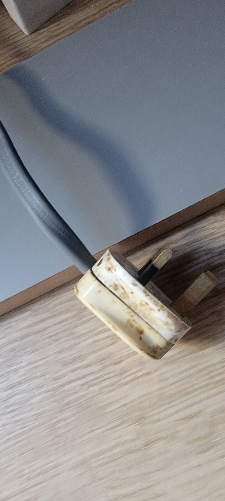

Hope someone can help advise if this ok. Electrician has wired 2.5mm circuit
Assuming this is a ring circuit with the 32A MCB which you have told us.
for oven, washing machine, tumble dryer and dishwasher. I just bought an double oven that is 5.1kw. Is it ok to have this on a 2.5mm circuit with the other appliances?
Not really - or rather - No.
If not, what is the best option?
1) change to smaller oven (what is the maximum kw I can have?)
It would still be pushing your luck and it would not be the oven you want.
2) put the appliances on circuit with the other sockets
You could do that - but if it is that easy to rewire then just connect the oven to the hob circuit and leave the rest as is.
I do not understand why that was not the original way of doing it.
3) change cable to 6mm (which be a pain to do and no doubt cost more). Can the appliances be kept on the same circuit with 2.5mm cable?
No point. All you need is a cable - 2.5mm² would do but I would use 4mm² - from the hob connection point to the oven.

You have a 6.4kW hob and 5.1kW oven.
This is the equivalent of a 11.5kW cooker (i.e. one piece hob and oven which would be on one circuit).
This is well within the limit for a 40A 6mm² cooker circuit (assuming it is installed correctly).
11.5 kW @ 240V is 48A.
Using what we call diversity for cooking appliances because even when on, each element constantly cycles on and off, and the long term average load works out at only 21.5A ((48-10) x 0.3 + 10) so the circuit is way over this and perfectly adequate for both hob and oven.

Are you sure the oven is on this new ring? How is it connected?
You can't plug in a 5.1kW oven.
Tell that to the so called electrician who stuck a plug on a 2.5mm cable and plugged it into a Double socket under an island unit on a 32amp ring final for the Hob
It's an Induction hob and rated at 7.2Kw......found this today
