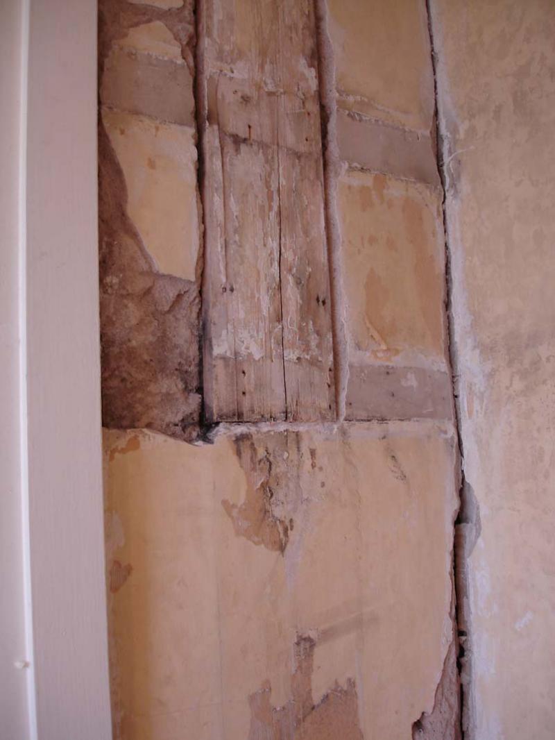

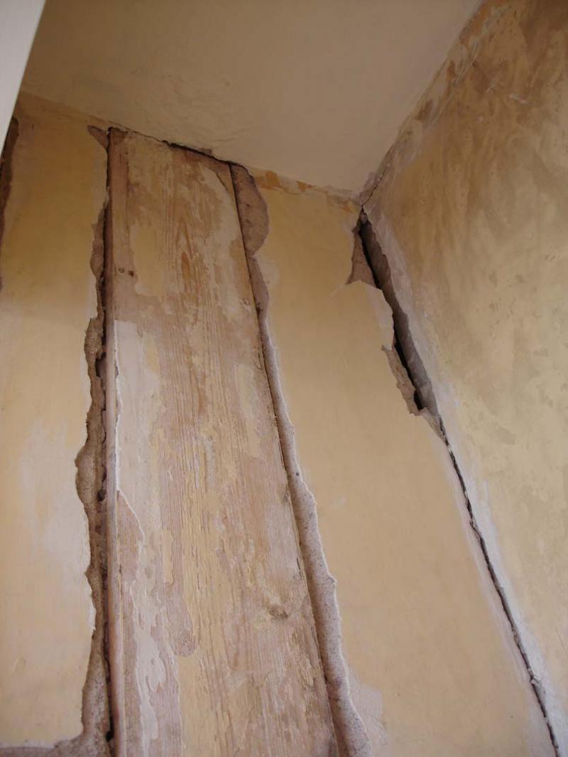

Currently redecorating the spare bedroom. Removed some 'cardboard' lining paper in what used to be the airing cupboard to find it had been used to hide a pretty bad wall . The cupboard was built onto the chimney breast (no longer used for an open fire) and appears to have had a piece of wood fitted onto it for attaching shelves and whatnot without drilling through to the brick.
The plaster beside it was in a bad state, and without too much hacking at it I've removed a good portion (see pics). I'm wondering what the best way to make this wall presentable is - should I just overboard it or replaster?
I've done a small amount of plastering before so I think I could make a good enough job for inside a cupboard but putting up boards would be quicker I presume?
If putting up boards is recommended, how do I fix them (only put onto stud walls before) and do I need to do anything to the existing wall to make them good before boarding? The cupboard is 510mm deep if that affects the answer, and I have about 15mm before any new surface would be proud of the architrave.
