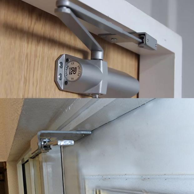

I need to install one of these on a fire door
Eclipse 28730 Overhead Door Closer Silver | Overhead Closers | Screwfix.com
All the pictures I have seen, have flat architraves for the plate to screw to e.g.:

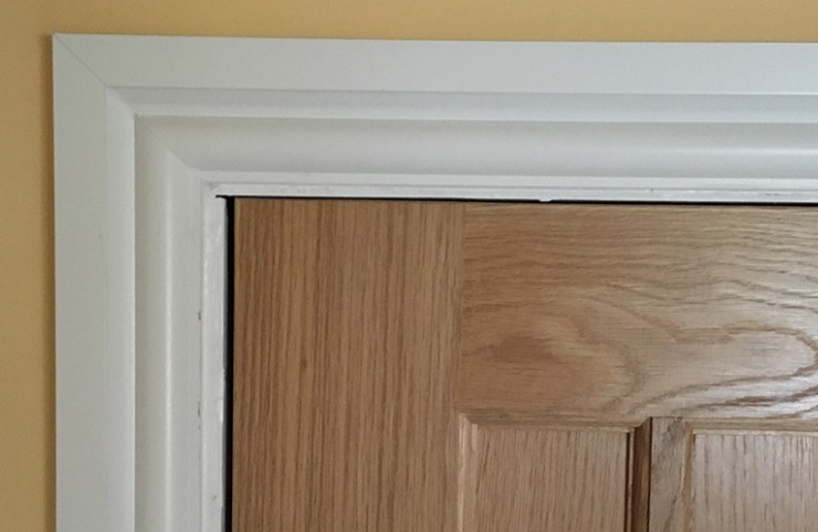

However, my architrave is like this:
Can they work with this arrangement and how do i go about fixing the foot of the closer to this architrave please?

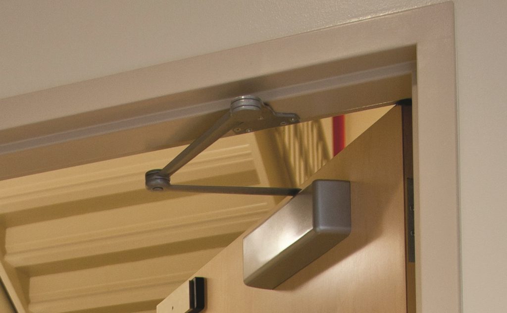

Agreed. What we normally do is just to notch out the architrave neatly. Alternatively it is possible to use a parallel arm solution with the body of the closer mounted on the "outside" of the door
and an accessory mounting plate which fixes to the door frame/casing/lining reveal. Some closers have complete arm system designed for parallelinstsllation which are neater and slimmer (but more expensive):
In general these parallel solution plates are included in commercial door closer packs, but if buying from a "domestic" supplier they may need to be purchased separately
There are also sliding attachment systems where a slide us fitted in the head reveal and a single, non cranked arm is used, but these are often restricted to automatic closing doors (often held open on electro magnetic door holders, sometimes the mag is in the closer, though) and disabled toilets, etc
