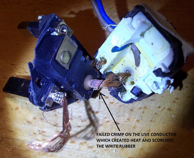

A few months later, the tumble dryer stopped working. I reached down to the socket, and went to switch it off at the socket, and remove the plug. The switch would not move to the off position. It's stuck on. I unplugged the dryer, plugged it in to the above-worktop double socket, and it worked fine.
We've been using the dryer in this socket for a few months now, always plugging it in to the RH socket. We've noticed that the plug, and the switch area of the socket were getting warm/hot, and resolved to get another electrician in when time permits. The access to the rear of the consumer unit is below the utility room floor, and we'd have to lift flooring to get to the hatch, so ....
Within the last few days, the dryer stopped working again. I unplugged it, switched off the RH socket, and switched on/plugged in again. It worked for 10 mins or so, then stopped. With the machine plugged in, and switched off at the socket, switching on at the socket gave a little 'kick' of activity at the machine, but no startup/running.
Unplugged it from RH socket, plugged in to LH socket, and it's working fine, but the plug, and the LH switch, are both hot when in operation, the switch almost at the point where it's too hot to touch.
So it looks as though the switches are being disabled by heat.
The dryer works fine, and shows no fault symptom other than the (moulded plug) getting hot. The cable is cool, but not the plug.
Anyone got any input, or thoughts as to root cause?
I'm on the verge of cutting the moulded plug off the cable, and replacing with a decent MK. Could that be an issue? Wouldn't explain why the switches get hot, though....

The heat from a failed joint in the moulded on plug will be conducted into the socket and along copper conductors to the switci.

The heat from a failed joint in the moulded on plug will be conducted into the socket and along copper conductors to the switch.
So, at the very least, you agree I should cut off the moulded plug and replace with a quality one?

Can you plug it in on another socket on the main ring somewhere first. I think EFL is probably on the right track a loose Neutral somewhere since it's a ring any socket or even at the DB.
If you can prove it's not the Tumble Dryer whatsoever by plugging it in elsewhere then this virtually proves the utility wiring is faulty.
If you're still having issues with it then replacing the plug and trying again afterwards and seeing if any heat builds up still?

I would clean the dryer plug pins with a kitchen scourer or that liquid that gets metal shiny.
(maybe some pics of it? etc)
Also remove the fuse cover and pic inside
OK, to follow
