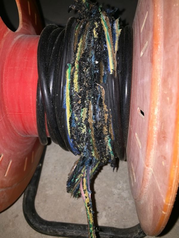

Overloaded extension lead

This was a 40m extension lead partially uncoiled and left running a dehumidifier and a fan heater overnight. It ran for about 14 hours before tripping the RCD.
The extension lead was rated to 13a when fully extended by only 3a when coiled.
The extended section of cable was cold to the touch. But the centre of the coil got rather hot.
It all stopped working when the smoke was let out.....
A very good example of why its important to pay attention to cable ratings and consider de-rating when the cable is in an insulated or confined space.
It is so easy to include an over temperature device in the centre of a cable reel to auto switch it off before it over heats, with a enclosed type of extension it is so easy to think it's all out where in fact it has jammed, it is hard to add an over temperature device as an extra but so easy during the design and manufacture.
What it shows is poor design.

Indeed. Some of the ones I have do have some sort of 'cutout' (with a 'reset' button) - but I'm not sure whether it is current-operated or temperature-operated.

Lower, what was the CSA of that lead out of interest?

According to the IEE code of practice, that does not compute!
1.25mm² csa max length 12m
1.5mm² csa max length 15m
2.5mm² csa max length 25m
Although there are loads of factory-produced extension leads out there that far exceed these figures. Even ones with 1 milli flex that is not even on the IEE's chart!
Isn't it a (British standard?) requirement that all extension reels be fitted with thermal cutouts?

Neither am I but I seem to remember reading something about it in the pat testing book. Edit: I have several reels here, all have reset buttons on them.
The standard Masterplug manufactures to is BS EN 61242 and all their reels have a thermal cut out.

The extension lead was around 10 years old and had no thermal cutout.
Rated loads were cast into the reel moulding.
