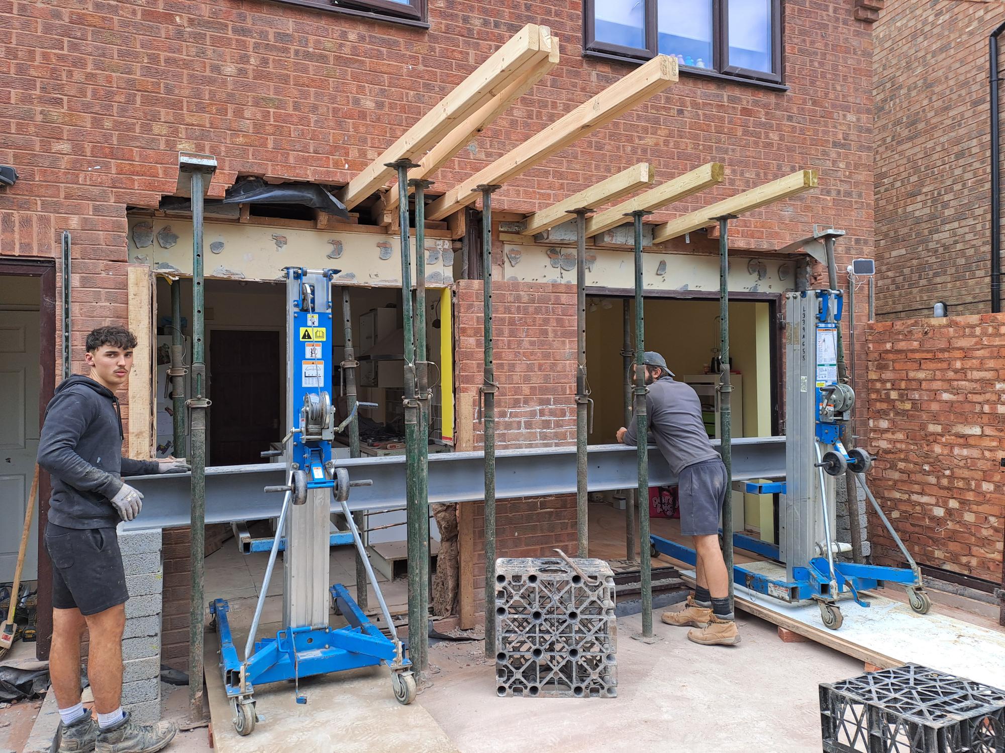

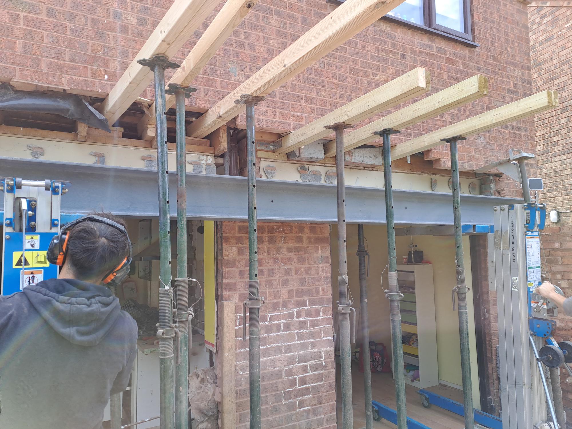

You seem to have used plenty of supports on the middle section. Was there a specific reason for that?
Yeah, there was some compromise with the internal propping, due to an unexpected joist direction change. So we just made sure.

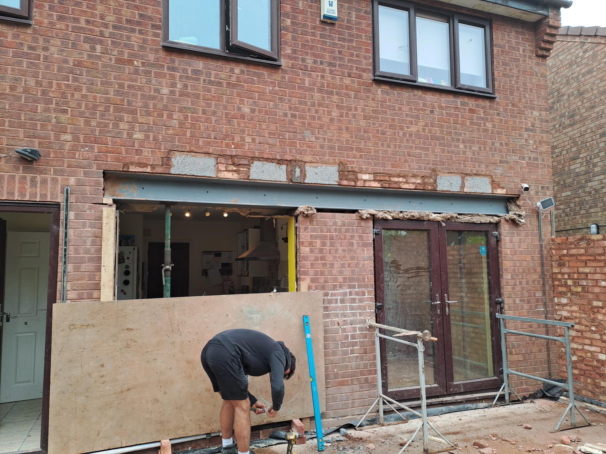

I get that we can't always do that scenario, but it's satisfying when it does. More often we are re-building the masonry above the beam.....
The first cuts you made into the wall are very precise. What saw do you use, arbotech plunger?
