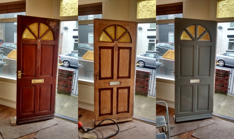

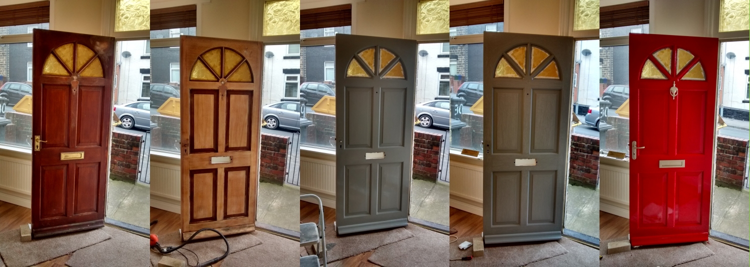

This is where I've got to so far... quite like the "Battleship Grey" undercoat... plan is to sand, re-do undercoat, sand and do Pillar Box Red.
Got there with it at about 09:00 this morning... just in time for it to seemingly dry before the rain started coming down 20 minutes ago...
It's bright! And it's shiny!

Re painting a door, a good sequence is... paint the edge of the door making sure you don't leave a raised edge of paint on the face of the door, cut any windows in; if your crap at cutting in use some Frog blue or green tape before you start painting, if you just have panels paint the edges then paint the centre of the panel, once the panels have been completed, paint the internal verticals, then the top bar, middle bar, bottom bar and finish with the outer verticals.

Hi I'm about to repaint my front door which is almost identical to yours. The only question I have is about sanding. If you sand the door after you put the undercoat on what type of sandpaper do you use, because I don't want to take any of the paint off, or rough it up too much to leave any raised imperfections. Also I'm using wire wool and sandpaper to take off the old wood stain/varnish but find the corners of the bevels/insets hard to reach. Are there any tools which can sand into the small corners?
240 grade sandpaper used between coats. You might need to find something to use as a scraper, or something small to wrap the snadpaper round.
Thanks - I got myself Shaveook http://www.wickes.co.uk/Wickes-Combination-Shavehook-57mm/p/600754 It's proved very useful getting into the corners and not bad for 2.99
