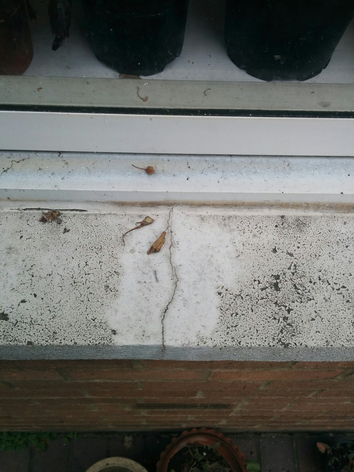

So. I want to repaint my windowsill but it has a huge crack in it. See picture. The windowsill is sturdy si I don't think it is structural but I do want to fill out in. What are my options?
Also I have other windowsills with much smaller "hairline" cracks that are perpendicular to the direction of the windowsill. I assume those are easier to fill with some kind of outdoor cement version of polyfilla. Is that correct? IMG_20170916_122632.jpg
Sorry, but that window cill has had it, and needs to be rebuilt. If the crack goes outwards from the window, then it can be dug out, and an exterior filer added, which you could do with that one, but at some point you'll need to bite the bulet, and repair it properly.
If you're lucky, the bricks inside the cill are still okay, so you would hack off the damaged parts, build a wooden frame to encase it, and then fill with cement and sharp sand.
Ah, so such cracks cannot be easily repaired? I was hoping I could fill out in with something. But what you are describing sounds over my pay grade so I will have to hire someone.
So, if I do get someone I should get a quote to replace the whole thing? How big of a job is that for a professional? It's off because it doesn't look like that big of a crack.

If the cracked segments are loose and can be moved by light pulling action,then they are beyond repair.
Otherwise,clean them, wire brush the cracks remove any loose masonry,sand the cill,vacuum the cracks to get all the dust out then fill with 2 part filler (same stuff as car body filler) have a practice with the filler it sets rapidly,push the filler into the cracks and sand smooth if required.Then paint. https://www.toolstation.com/shop/p1...=16873&gclid=EAIaIQobChMI1u77sv-r1gIVG5SyCh20
Having read Old&Bolds comments, if the bits are stable, then rather than 2 part filler, if you can thoroughly clean out any dust in the crack, the a 2 part resin would be a better idea, as that'll glue both parts together, and will be better long term than the filler. But you've got to sand it down before it sets solidly, otherwise it's a pig to work once it sets hard.
Gripfill Xtra would be good - squeezed in with a mastic gun -suitable for outside use.

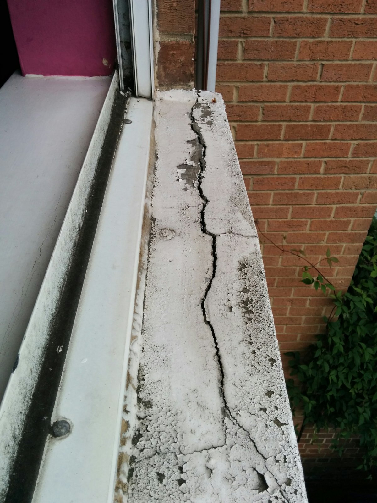

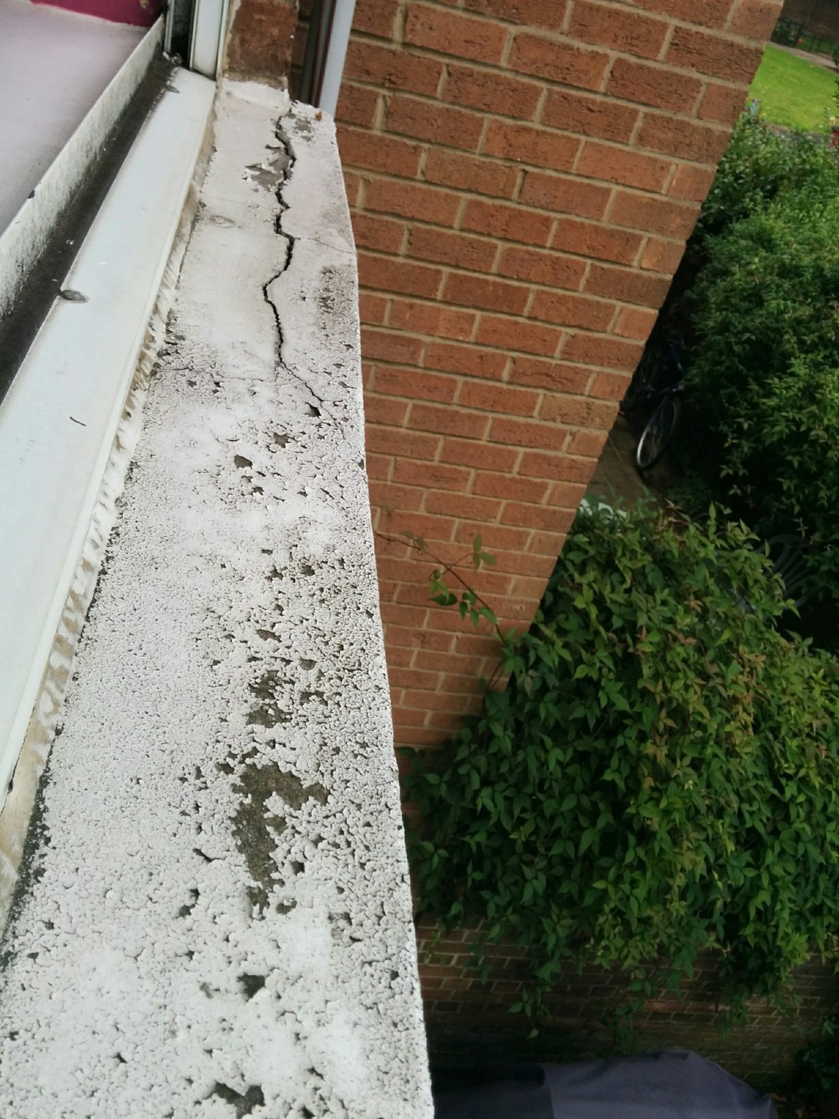

Thanks all. I think my first picture didn't do the stability justice, so here is a second. In this first, the crack looks like it's a fairly substantial portion of the window, but it only goes half way as you can see in the second pic. As far as I can tell, the thing is rock solid. Pushing or pulling the thing won't make it budge.IMG_20170920_111218.jpg

Personally I'd glue that crack with a resin adhesive called Araldite.
Maybe the crack has been caused by a steel reinforcing bar rusting within the sill. Can you safely get there with some ladders....maybe to grind the crack flat first?
John :)
If the cills are solid, then I reckon you could follow Mr Chibs suggestion, but if the cills are loose at all, then go for something like this, they're all pretty much the same, but you have to make sure there is no dust in the joint, or it won't hold, so you either need a dust gun to get rid of it, or wet the joint and let it dry first.. They can be pumped from a mastick gun, but they mix in the nozzle so it'll go hard and set, so you need to be ready to do all the filling in one go.

it sounds like, however, both will be plenty strong. I would like a solution that makes the sill stronger.
Then you want the 2 part resin; it's stronger than concrete in about 20 minutes, but you must make sure the surfaces are dust free, or it won't stick.
