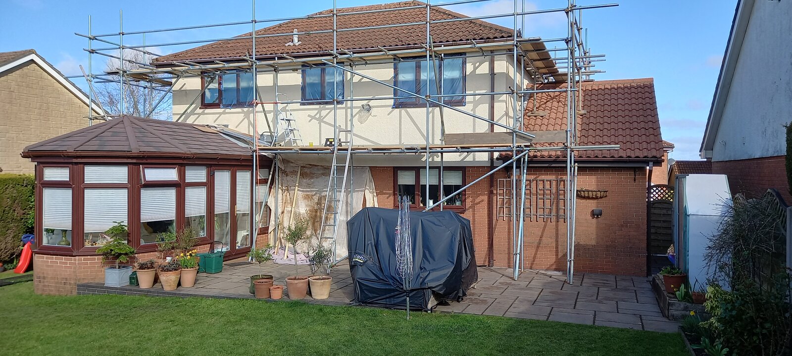

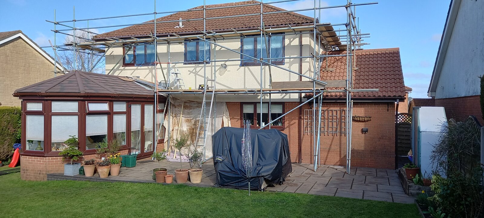

I'm having solar panels fitted January so using same scaffold to paint my exterior walls. Hence the query regarding painting in low temps.
