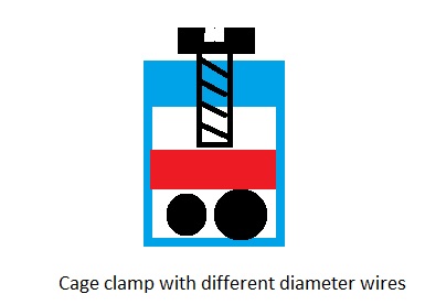

Some cage clamp terminals do not make good connections if there are two wires of different diameter in the clamp

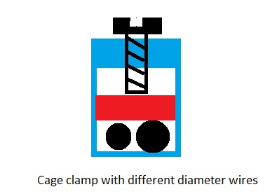

Oh yes that is a regular problem.
In control panels there is commonly a door interlocked isolator (to prevent the door being opened with power 'ON') but it is common practice to have a control circuit connected to the live side of the isolator. I've often had to fix the fault where a small cable like 2.5mm² is not clamped beside a much larger cable.

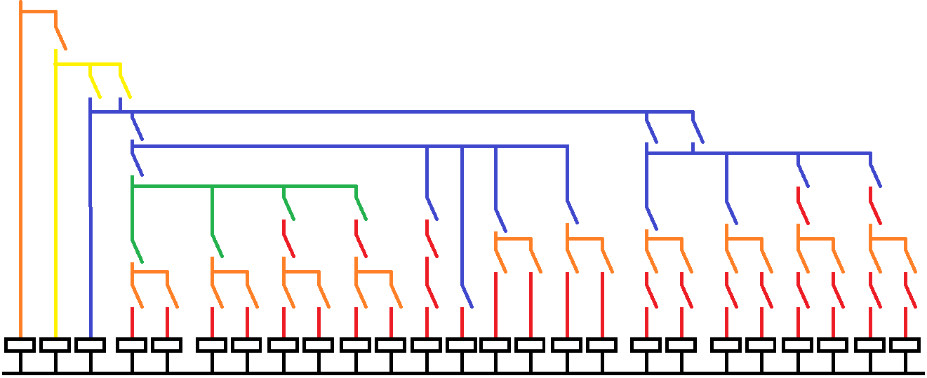

Looking at the drawings for a random panel here is a precis of the enables and interlocks for the heating pumps, boilers and associated items. For convenience I've colour coded the nunber of terminations 'per wire'. Personally I don't see any sensible way of avoiding 2 wires in a double ferrule without adding silly splitters or sets of terminals all over the panel with all the additional wire runs filling up the trunking.
So how would others wire this without double ferrules?

Generally easily avoided with double bootlace ferrules or blade/fork lugs used back to back.
I agreed except I've always been under the impression one should not mix wire sizes in a ferrule.
When dealing with vast difference in size like 2.5mm² and a 240mm² I'd probably look at a ring tag for the smaller wire.
Hardly a typical example though. Generally I would expect to see back to back lugs for different wire sizes.
It's very, very, common to power the BMS system this way and the wire sizes are absolutely not atypical
But a decently designed system should have separate connection points for the power cable and the sense or control line. Torquing up a power lug with a lightweight ring terminal as part of the sandwich is a potential (no pun intended) weak spot.
It's very easy when the terminations for the supply are bolted lugs rather than clamped. I have some agreement with the rest, however adding an additional joint in a large cable is no mean feat and one which many will do all they can to avoid, due to space and reliability. Specifing 2 feeds, like 1000A 3ph and 16A 1ph, into a panel rarely works either due to isolation issues and when it does the additional [external] isolator seems to be a target for later accidental operations.
