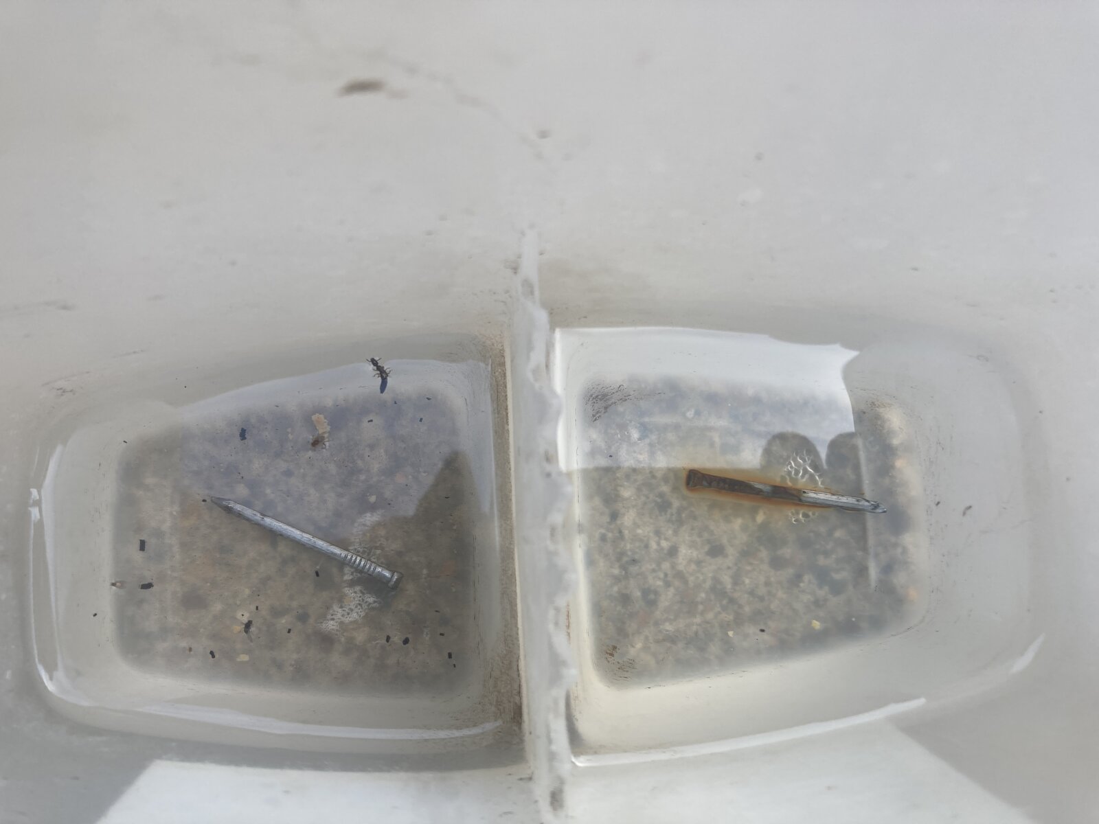

After reading this, I did the same to mine. Drained my Omega TF1 and got a tiny bit of magnetite out, filled one side of a container with fluid from my system and the other with just tap water. Dropped a clean nail in both sides, left it 24 hours and ended up with this:
Looks like it’s OK. Just noticed that insect!

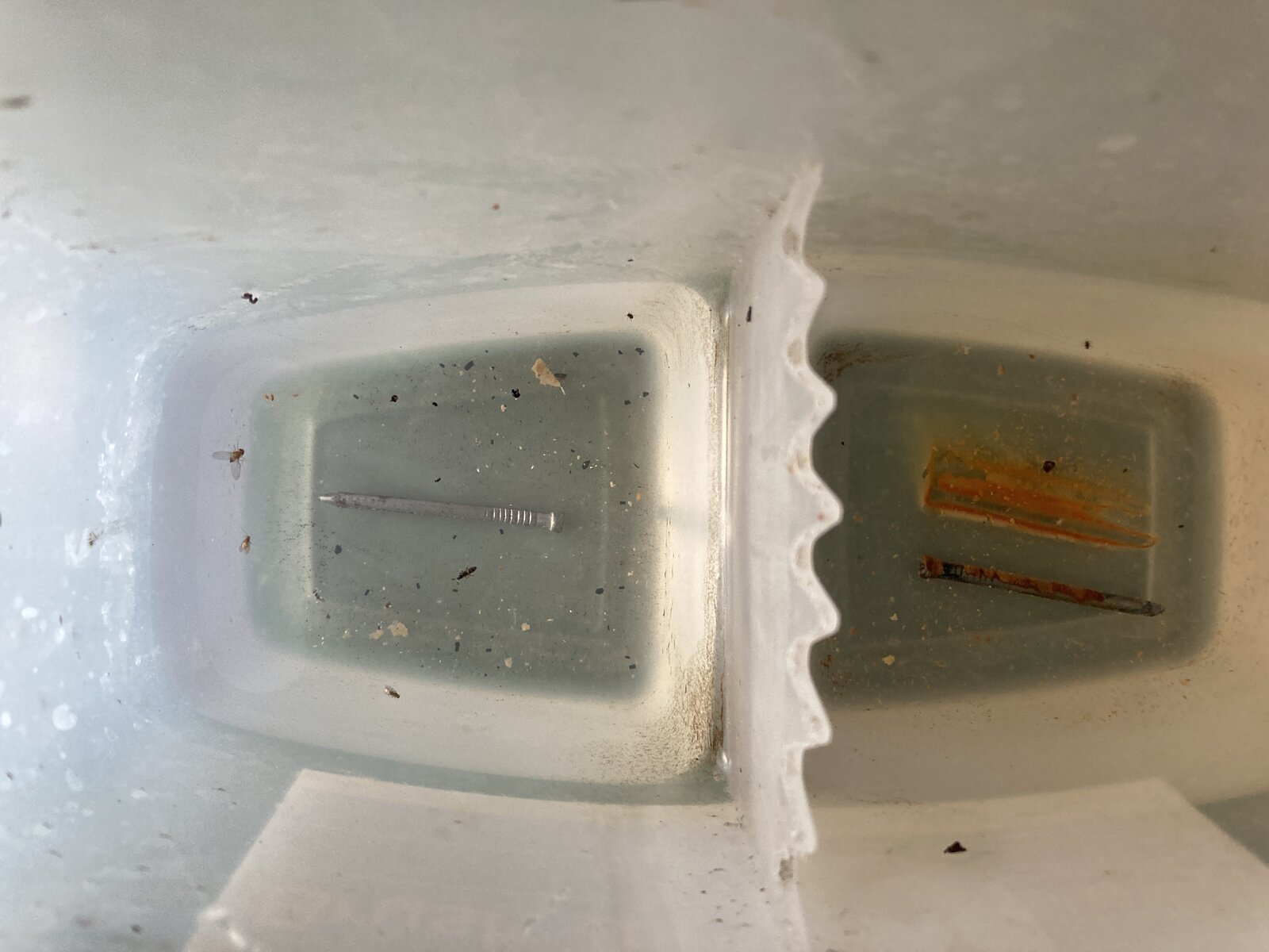

I wasn't sure how long I was supposed to leave it. Mine was fine after 24 hours, but after a few days showed signs of rust. Some say it needs to be in a full and sealed container.
I’ll check it again after 48 hours but I’m pretty sure it’s well protected against corrosion judging by what had happened in just 24 hours.
Plain water still rusting the nail, system water having no effect. That’ll do for me.
