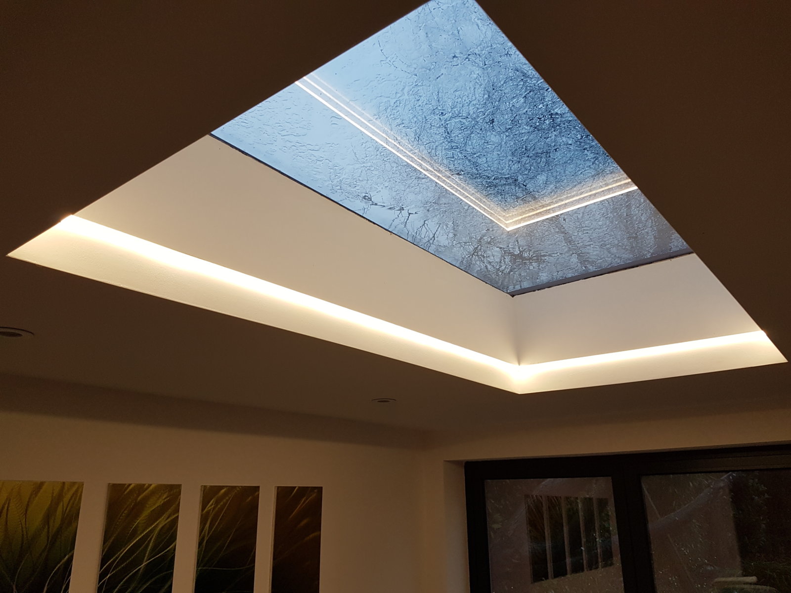

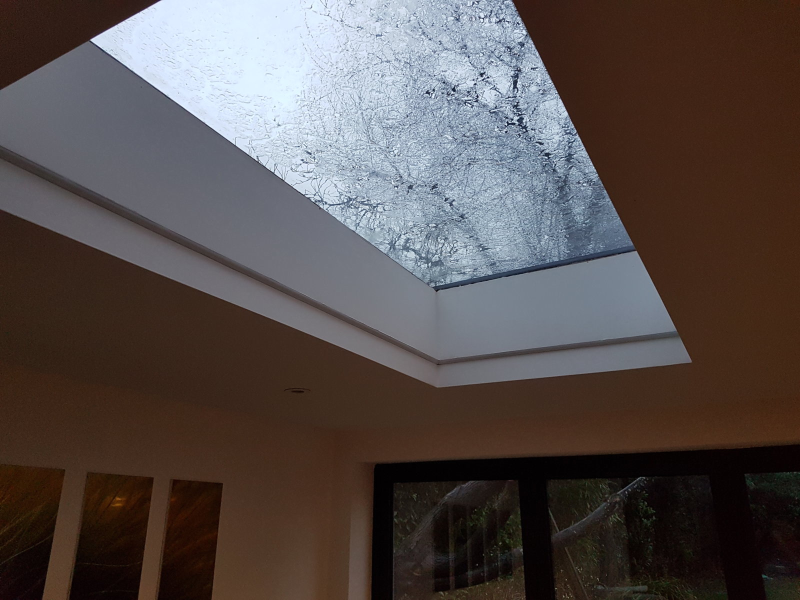

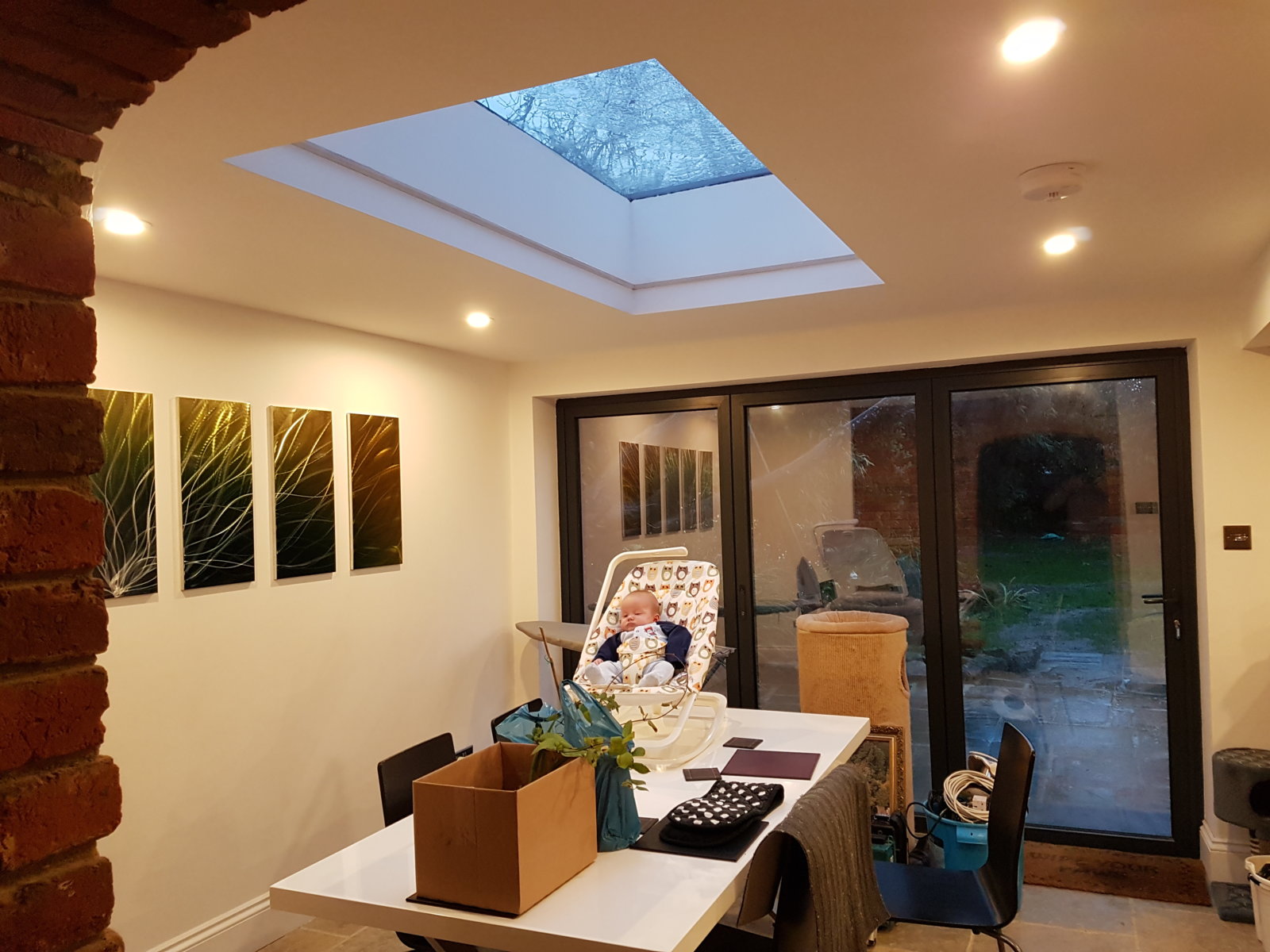

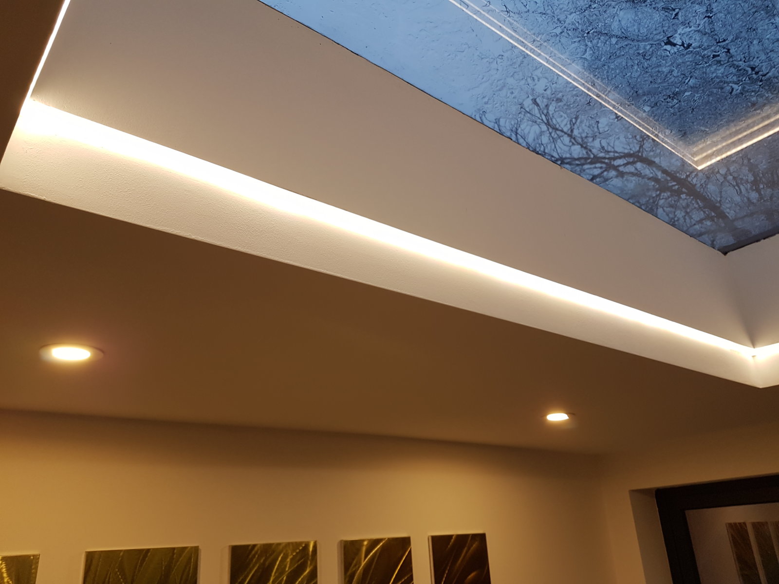

Hi - Just realised I never posted any pics of the finished article so here you are... (y)
Nice lights - is that a self adhesive LED strip stuck to the surface, or something more complicated?
The intention was so that at night time, we still had light coming down from our skylight. To achieve this we set LED ribbon within a 90 degree aliminium profile (https://www.tlc-direct.co.uk/Products/SK156810.html). Above the profile we stepped the verticle wall out by doubling up the plasterboard. We actually installed the profile before skimming so that it blends in seamlessly (the plasterer skimmed up to the edge of the metal profile).
Most people don't realise it is a light there - and only realise when we turn it on :)

With regards to the pics of the finished room Andy has posted - looks very smart. Really like the “showbiz” lighting. What LED strip did you stick inside those profiles? They look very neat. Do they provide much light or are they more visual effect?
