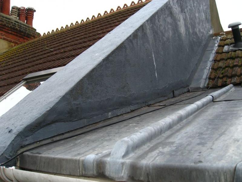

I have had leaking parapet wall > the interior walls were wet ... and we just had it sealed over.
What is the long-term solution ? The seal is only going to last a few years isn't it ... is it possible to re-render the entire wall or ... does it need to be totally flashed over with lead ?
Any help would be great.

Sealed over : well a roofer came and hacked out some cracks and filled them, and then put this "aqua seal" grey stuff over - although it's been only 6 months and the aqua seal is very thin and wearing away.

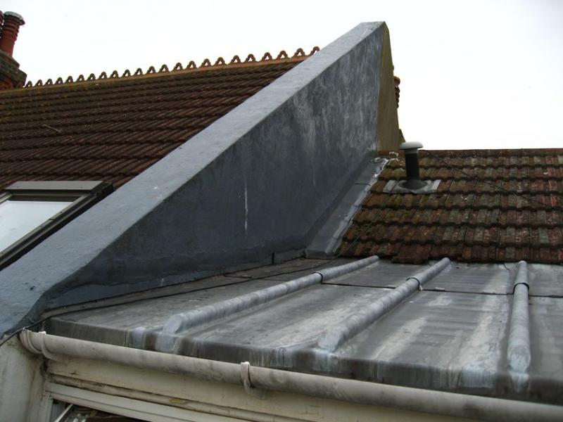

Sorry about the photo : the seal goes up to the apex and then stops, the render being as it was on the other side. It's not a flat roof but a dormer with lead that you can see ... on the other side the neighbours just have tiles and a velux there (I have indicated the velux as a possible cause). Leading all looks good, although I have just mastic'ed 2 vertical seams that I wasn't sure about.
Although the damp is much improved with the work that was done, some is still entering ... from an unknown location ... and seems to be getting a little worse now. My guess is that the render is the problem; the aquaseal would have fixed it 100% if it hadn't been bodged; the aquaseal is now wearing off so its getting worse again.

Here are all the photos. As you can see about 3m of the wall was aquasealed and cracks filled.

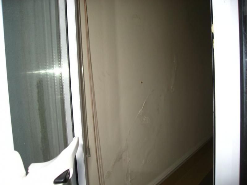

The interior is just visible through the window. It is damp for about 1.5m from the window on the interior ... 50cm beneath the roof line.
There is no damp / damage on the interior on the ceiling nor around the window frame ... i.e. it looks to be coming from the parapet render or possibly the flashings ... but the flashings look good and I masticked 2 vertical seams just in case with no improvement.

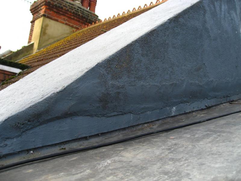

1. The top surface of the parapet, just above the soil pipe and also a bit further up, has been "repaired".
2. There's also a repair line on the parapet side running just above what seems to be a one piece cover "flashing".
3. Render on left side of the parapet appears to go down to the flashed tile? Is there any cover flashing?

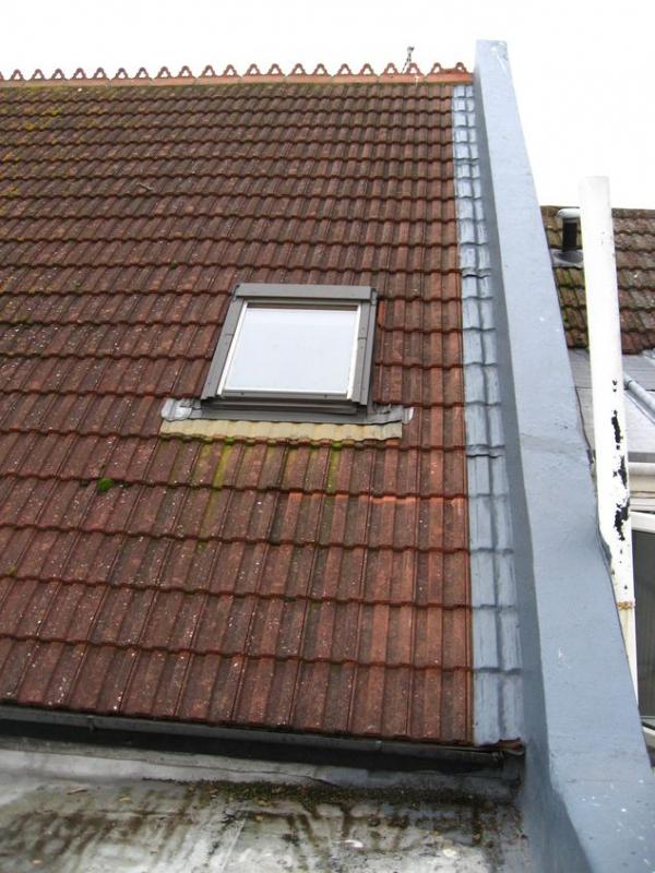

4. Flashing at the bottom of the Velux has been pieced in.
5. The lead flats are very flat (there are no "vertical seams" in the lead). But it looks to be first class leadwork.
6. A tile has dropped at the second bay.

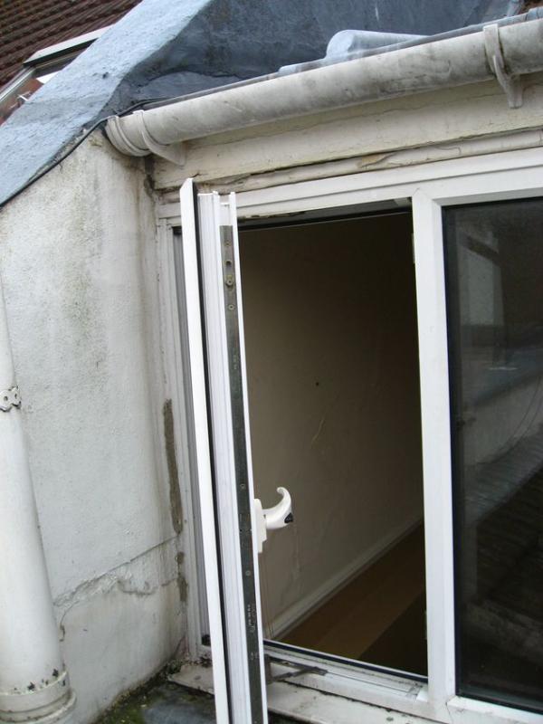

7. The window frame has been badly installed: non-recessed and too low. Something not right at the vertical LH side of the frame?
8. The lead flashing at the corner above allows water to run down the frame and wall.
9. The white painted black plastic soilpipe seems to be indenting into the parapet edge. (never paint plastic).
10. The interior damage runs down to the skirting - maybe behind it, perhaps even into the floor. The plaster will have to be renewed at some time.
11. Someone should water test the roof and parapet. Starting at the gutter and working up to the ridge. Do the same to the parapet. Its a slow methodical process with a hose pipe.
I suspect the parapet but the whole roof must be tested and examined, esp. where flashing looks odd or repairs have been attempted.
The tiles either side of the 2nd bay have been pushed up to accommodate the ridge roll! no tile slippage.
Counter flashings below velux windows is acceptable! thats next door anyway.

Anyway, get a builder to quote for removing back to brick existing render, renew lead aprons to dormer roof if required, run dpc along top of parapet and install coping stones.
2 coat render with waterproofer to complete.
Oh and bellcast beads along the lead detailing.
