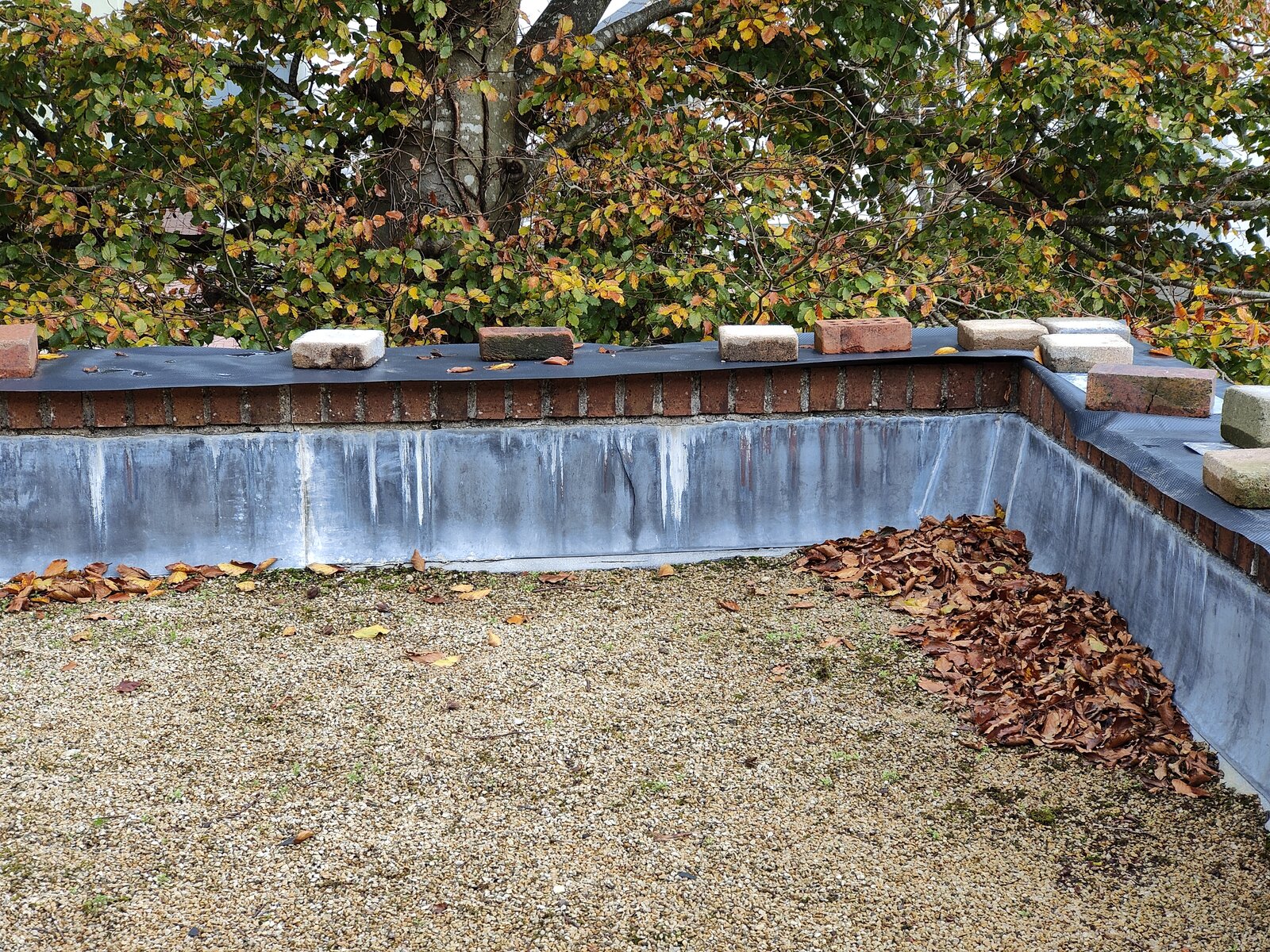

If you stick a tarp over it weighted down on the inside with bricks or whatever on the flat roof and a timber batten stapled or similar to the tarp that overhangs the wall to keep it in position then that may narrow the source of the leak down to just the wall or just the top.
Yeah, well I know I have a leak from the top anyway from my hose tests so that has to be fixed. And I have a plastic cover on kind of as you describe, which has worked.
OK so are you getting anymore leaks then? Though your cover doesn't contain that brickwork on the inside.
I'm good I just want to know whats the best thing to do.

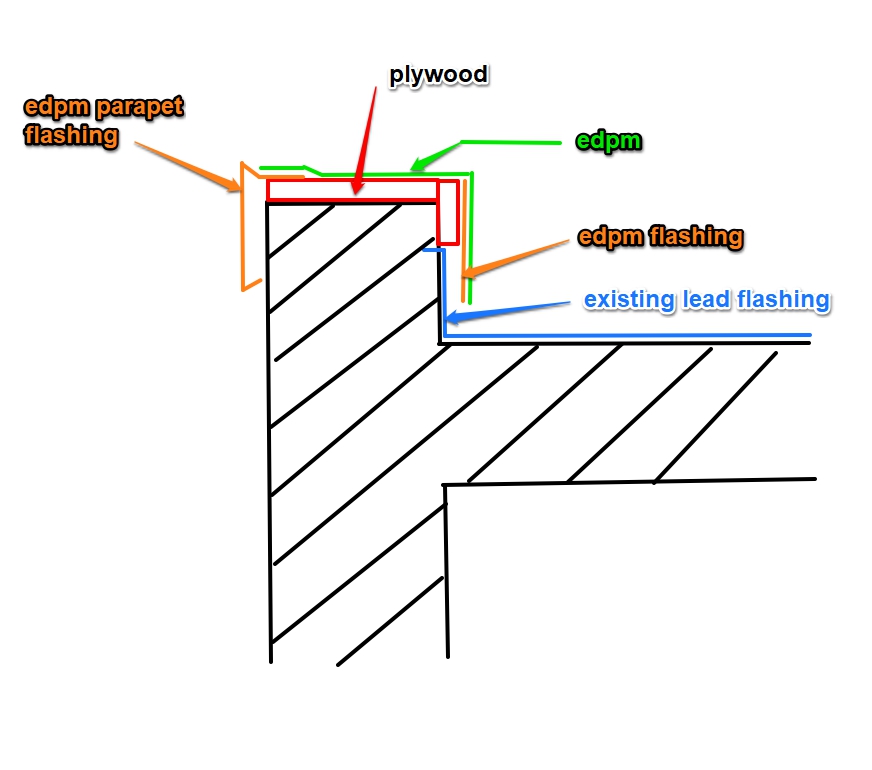

Should I repoint or relay the top bricks or just add a plywood base to wall top and fix metal coping over it.
Any brickwork/mortar that's not sound should be repointed/fixed irrespective of what else you do, then I would go with epdm over the parpet dressed down over the lead with a suitable flashing on the inside and 50mm or so down on the outside again with a suitable flashing, then fit your coping on top. Or just don't bother with expensive aluminium coping and just do it in epdm and the proper flashings for parapets.
Thanks was thinking of EPDM.
Would i place that direct on top of wall.
No issues with breathability or condensation ?
I would have fixed some plywood to the wall first eg
Shouldn't get any issues with condensation.
