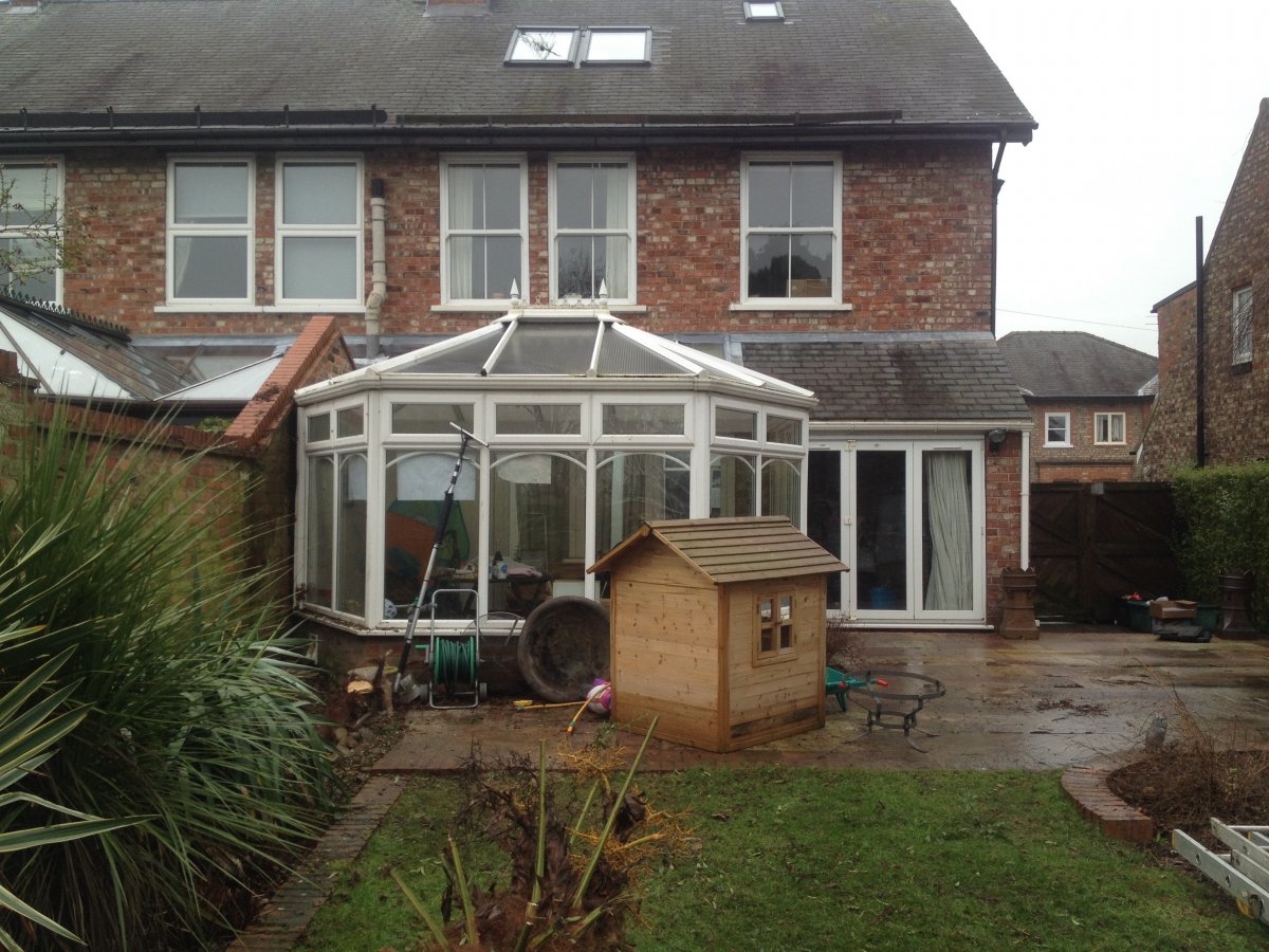

So my trench is going to be close to my neighbours boundary wall and conservatory. I enclose a pic to help visualise.
You can see we have a tiled lean to at the back of the houses. Plus conservatories have been added. Where my neighbours boiler pipe is i am going to be removing all my side of the connected lean to (plus conservatory) and build a new flat roof extension. It is going to be positioned about 200mm to the right of my neighbours wall.
So it will be very close. Do you think my footing will have to be deeper than the walls ? That is the question i suppose. My wall will be brick and block insulated.

If you don't want to use the Party Wall Act, then you should think that the footings won't be lower than the neighbours.
You will be looking at about one meter down though in reality.
Be prepared for shoring with some ply and timber though.
Will that garden wall have footings 1m deep then ?

If you dig lower than the neighbour's house footings, then the PW Act should apply. This will involve notices, and potentially surveyors and associated costs.
If you think, or your plan drawer thinks, and specifies a foundation lower than the neighbour's, then you should serve a PW notice and go through the rigmarole.
If you don't think, or your plan drawer does not think, and does not specify a foundation lower than the neighbour's, then you would not need toserve a PW notice or go through the rigmarole.
Take your pick.

Now I'm a novice compared to Woody, but even I know the difference between using a raft, and general foundations. You'd use a raft for the initial build, so that the house moves as one, so it effectively floats on the raft; but if you use a raft for the extension, then it could move independently to the rest of the house. You wouldn't dig out 45T of earth for the foundations, and then lower the rest of the site for the concrete base - you'd just dig the foundation to the required depth as checked by the BCO, or you'd do it on a raft system. How are you infilling the floor between the foundations.
My first experience of this was my father building the conservatory at the rear of our house on clay, and after they'd gone down a metre, the BCO checked it, and said he wanted another metre dug, and he ended up asking for a 3rd metre before he would let them pour the concrete.
