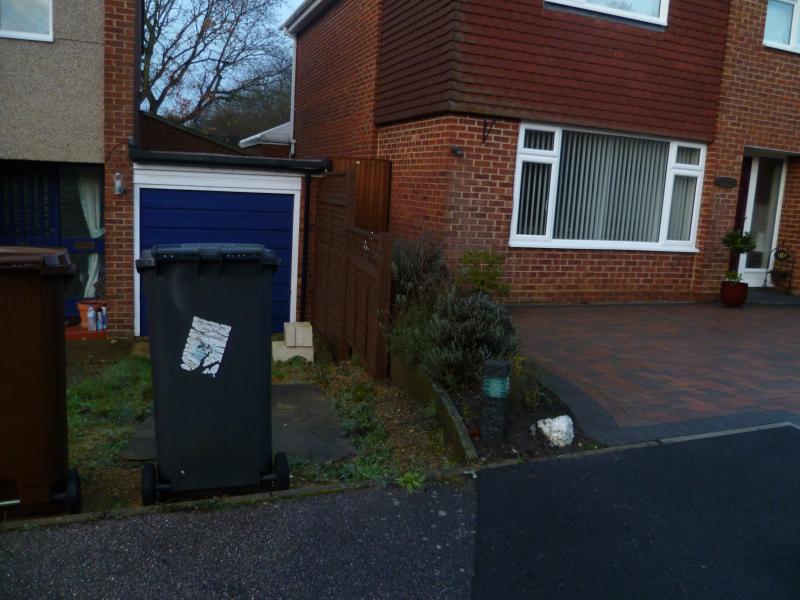

Sorry I will try again.
The party wall (defined in the deeds) is made up of 2 inch deep slabs standing upright embedded in concrete. Currently this is a curve.
I suspect that the neighbours are going to replace this with a straight wall and this will eat into my land.
Reading the leaflet, the wall would need to pass through the boundary but could be 4 feet wide (exagguration!). It seems that as long as some part of the wall lies across the boundary or is near the boundary - then it satisfies the act.
Is this a true reading of the act?
Picture is
This looks like trouble! Could be time to check out your insurance policies for legal help.
That is not a party wall. (an internal wall used by two properties)
It may be a party fence wall, but your deeds are the definitive answer.
The deeds should hopefully show that it actually belongs to one or the other of you; in that case, the owner may rebuild it but only with its "face" along the existing boundary, and with no further encroachment.
If the deeds are silent, then costly boundary disputes arise, but neither party can build onto the others land, except that any footings underground may do so.
If it is a party fence wall---and from the nature of the structure I would doubt it---, then the party wall act comes into play, with all the costs and problems if both parties cannot amicably agree.
Re width--if consent is withheld, then the owner doing the building must only build with the face on his own land.
When do slabs stop being landscaping and become a retaining wall?
Keep the legal profession in comfort.
It most likely would fall under the definition of a wall.
However, for it to be a party fence wall relevant to the Act, then it must sit astride the boundary. Unless the deeds actually define the boundary, I would find it unlikely that the boundary line runs down the middle of those slabs.
But I can't see what the problem is. If he starts work, just tell him.
And yes you are reading the Act incorrectly regarding wall thicknesses. Your hypothetical situation could not occur

The deeds define these slabs as party walls. (long before the party wall act).
I believe that he will knock down the slabs( His workman) and help himself to the land.
The slabs are defined as jointly maintained and neither party should weaken them.
As these are the only thing that marks the boundary, I believe that they may be a wall under the act.
However, if they are not party walls under the act, do I need to allow the workman access to destroy them and some of my land.
If they are party walls , I believe that my neighbour could extend them (increase them in size is an example in the booklet).
The neighbour has already breached a previous party wall act action and the surveyors voted that the extension was so nice that it should not be knocked down.
