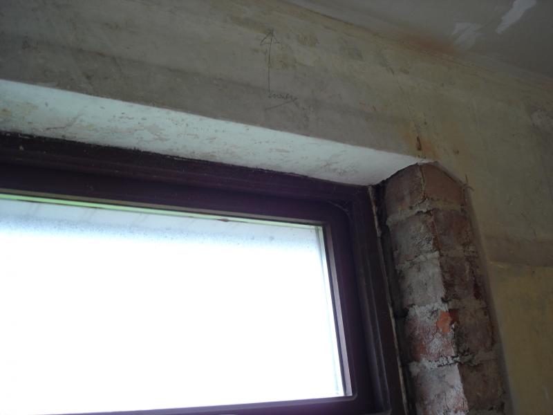

Hi all I was looking for a bit of advice.
Im speaking to my plasterer soon but would like other peoples views on how they would proceed.
I need the radiators on the wall, so below the window, from floor to sill is going to be sand & cemented as I've had issues
with damp being sucked through bonding.
At this point I'm unsure if I'm going to replace wood windows with upvc as I have dwindling funds.
Therefore there is no point in plastering up to the window yet.
I have two choices really...
1. Put a corner bead on and plaster the face of the wall (areas A&B) up to it, leaving the reveal unplastered.
2. Just plaster area A below the window and leave the wall chased as is, then get it finished off when I decide on windows.
I'm prefer option 1 as it seals down the cut edges and all the main plaster can be skimmed in one hit. But I'm concerned
the beading may interfere with the removal of the windows?
I'm also concerned about the damage removing the window would do to the skim above the window, which is plaster
boarded wood.
The window in the picture is dashed on the outside, but most the house is engineering brick without dashing.
I've included a couple of pictures. Thanks in advance :)

Dont do any plastering until your frames are sorted and fixed, and all remedial measures have been taken.
All and any wood lintel bearings should be investigated before making good.

I've decided to plaster to sill level and leave the reveals. The plasterer will return later to do reveals when he does other areas.
Regarding the other posts. I had the electrics done while downstairs ceilings are down and plumbing too.
I hope Ive sorted the gable end damp by repointing the full gable which was completed this week. I'll probably add a coat of water based waterseal to the bricks while scaffold is in situ.
The damp around the windows upstairs has been corrected by removing the internal course of bricks from sill to floor and rebuilding using a DPC under the concrete sill thus preventing any bridge for moisture.
It seemt to have worked but was a pain. The walls under the windows were loose so i took them right down as I want to hang rads there.
Once its plastered, I can go ahead.

Use render, not plaster, when covering previously damp areas, and its no bad thing to render W/F reveals.
Any frame replacement should be done before any making good. But, for my money, its best to keep the h/wood frames. Do you suspect leaks around the edge between the frames and the brickwork? Usually you can color match caulk the join, and re-new the caulk every few years.
And, to repeat myself, dont miss probing those wood lintel bearing ends.

The load bearing woodwork is old railway sleeper so they are creosoted and in good condition. It's because of the supporting woodwork that i refused to have the walls tanked as this locks the moisture into the walls causing wall tie and woodwork failure. I decided to repair the cavity so that everything can breathe . Even if I use portland cement internally, the house can now breathe to the cavity as intended :) .
