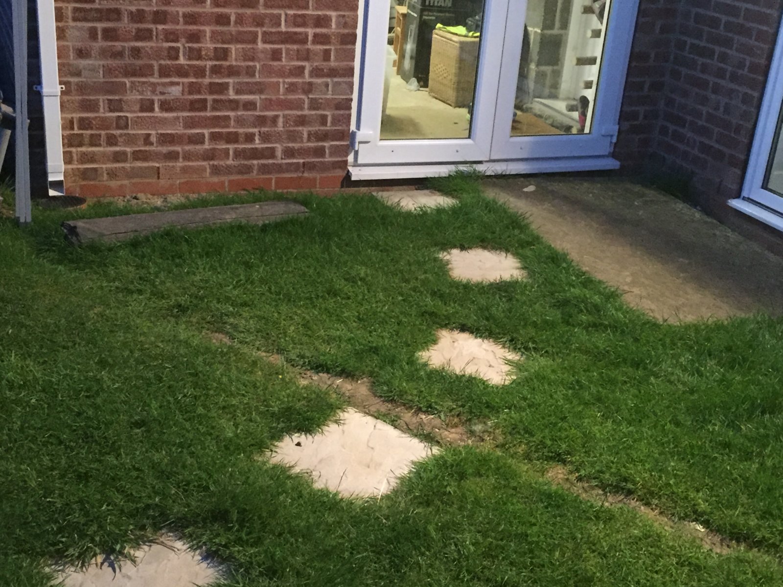

I’m starting my patio project at the moment, and I’ve come to a bit of a dilemma regarding drainage.

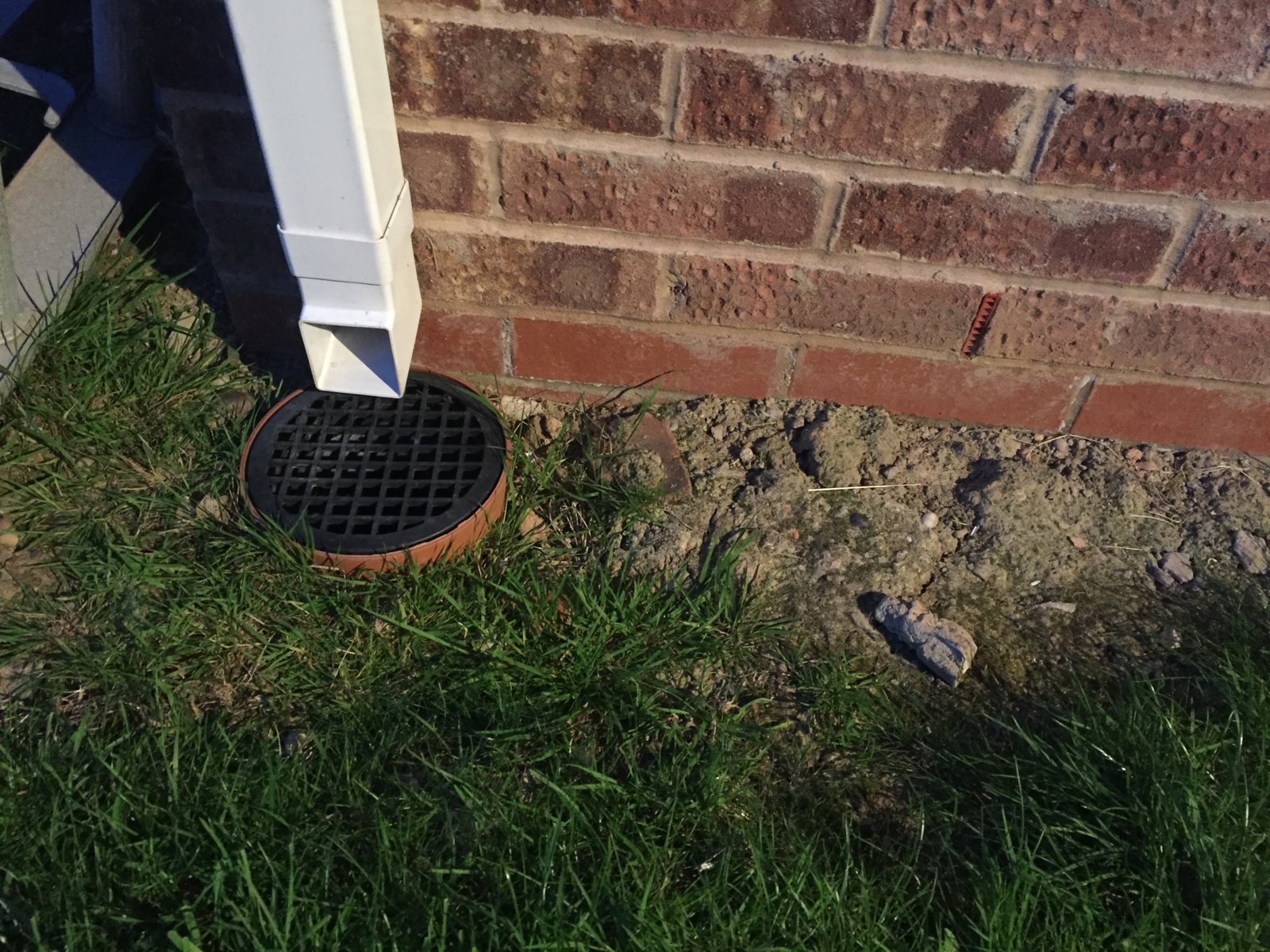

There is currently no paved area in the back garden - just grass/soil/mess, which all slopes down toward the house. The land is currently roughly level with the DPC with a bit of a trench around the house/garage.

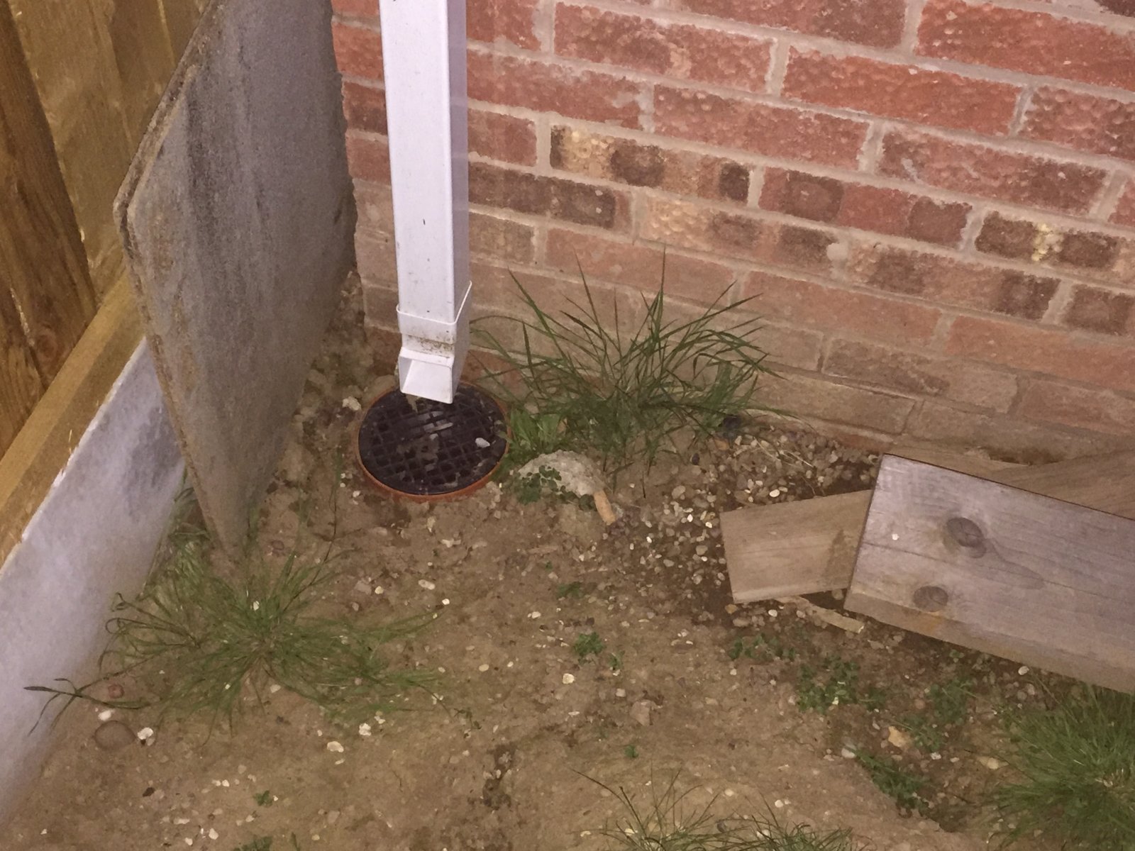

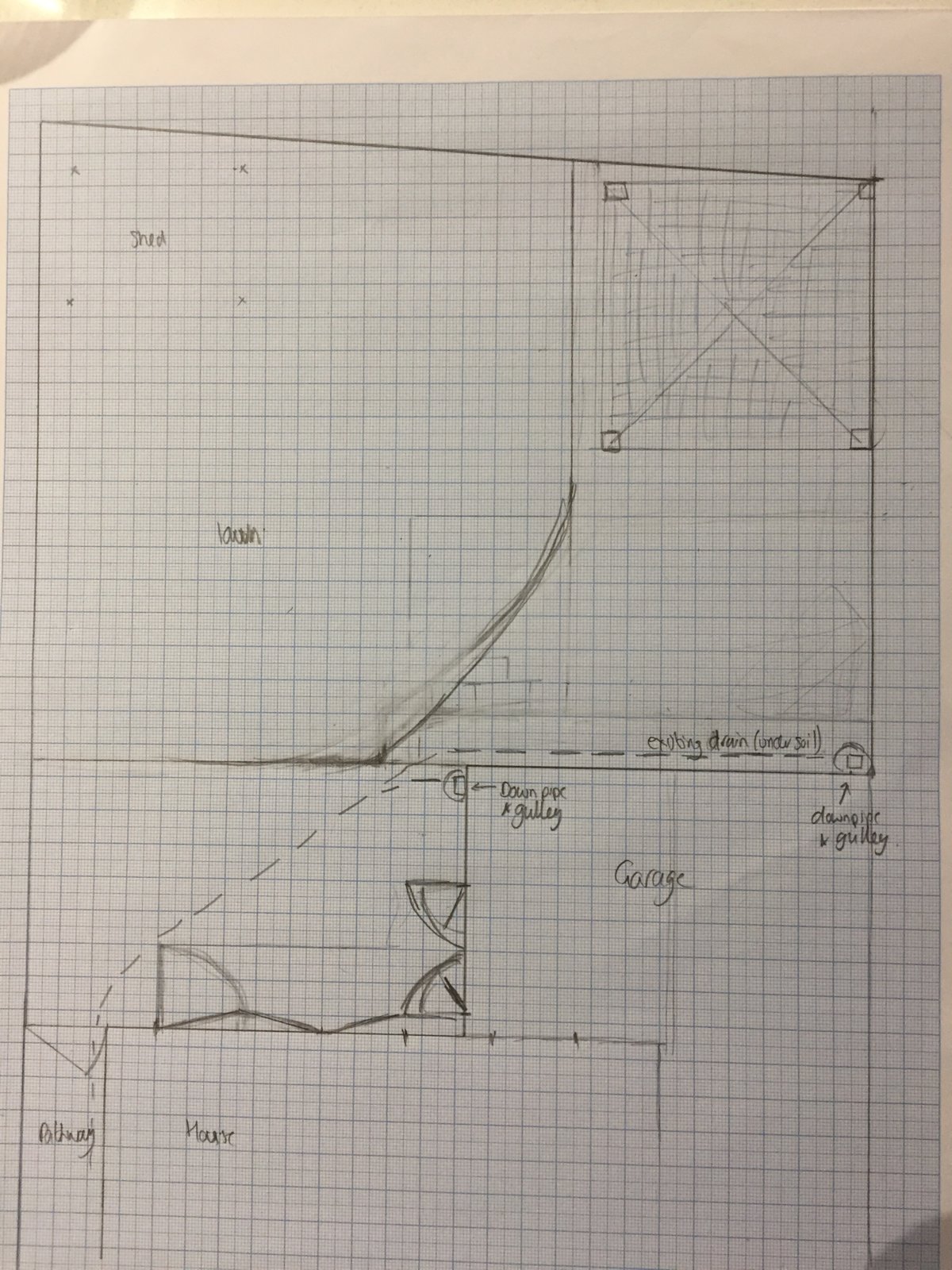

The garage wraps around the back right corner of the house and there is a pathway down the left hand side which has a surface water drain running underneath it. The gutter from the garage roof runs to a down pipe on each of the rear corners into a gulley and then underground via 110mm pipe to the drain under the pathway.
My plan was to build a patio parallel with the back of the house, protruding level with the back of the garage to start with, and then at some point (maybe next year) extend the patio behind the garage right into the back right corner of the garden.
The dilemma is what to do about the drainage. I was thinking of removing the gulleys and underground pipe, and fitting an Aco/linear drain at least 75mm below DPC all around the back of the garage and house to join the drain under the path.
Am I right in thinking that I need at least 1:60 fall for drainage? The distance around the back of the garage and house is about 13m, which means a difference in height from the furthest downpipe to the path is going to be about 220mm (roughly 3 bricks).
Surely that can’t be right?

Acco is 1:200 (5mm/meter). You could probably get away with less than 1:60 for the underground if it's just surface water.
Rather than awful ACCO, you could form a border in pavers up against the walls and angle them ever so slightly in to that RW gully, and these will act as a gutter, albeit very shallow and hardly noticeable. Together with a slight fall on the patio surface this will be fine.

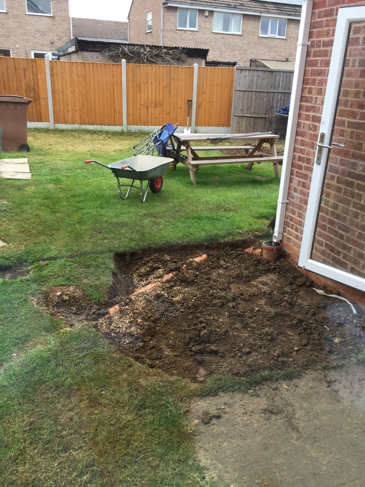

Woody - I’ve got to remove the gulleys because they’re already too high and the pipe is in the way of where I’m digging out for the patio sub base.
Thanks again
What? You are removing and not just lowering the gully? And installing crappy Acco grids?
I can’t lower the gulleys or the existing pipe coz it will be impossible to create a fall towards the surface water drain under the path. There is hardly a fall on it as it stands - and it runs under proposed patio areas (which need digging out)
It would fall 1:60 towards the drain and 1:200 parallel to the drain. Why not just keep the gulley's/pipes, have the patio higher with a trough/french drain/stylish acco drain at a lower level around the wall - level access patios are all the rage these days.

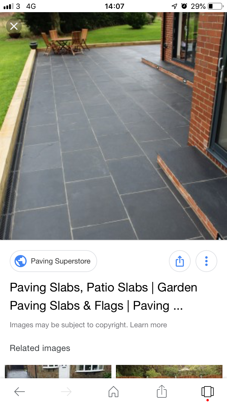

No. You don't design a nice patio in the garden hand have some industrial-looking grid thing around the edge.
Slope it the other way, form a deep gravel filled drainage chanel (aka french drain) and conceal it where it meets the grass.
But you have not mentioned what design or materials are to be used. It is generally better to incorporate something in to the design

We were thinking something like these slabs

1. Do as I originally planned - remove gulleys/pipes & fit linear drains all the way from the corner down pipe round the back of the garage & house to the path - 4.5m at 1:200 along back of garage - 3m at 1:60 to back of house - 5.5m at 1:200 to path. (100mm height difference in total - roughly) So starting at 1 brick below, I would end about 2.5 bricks below.
2. Same as above but with gravel filled channel/French drain.
3. Have raised patio (level or higher than DPC) but with a trench all the way round incorporating French drain below DPC
I like the idea of having the patio the same level as the tiled floor inside, but not sure about having to step over a moat!
