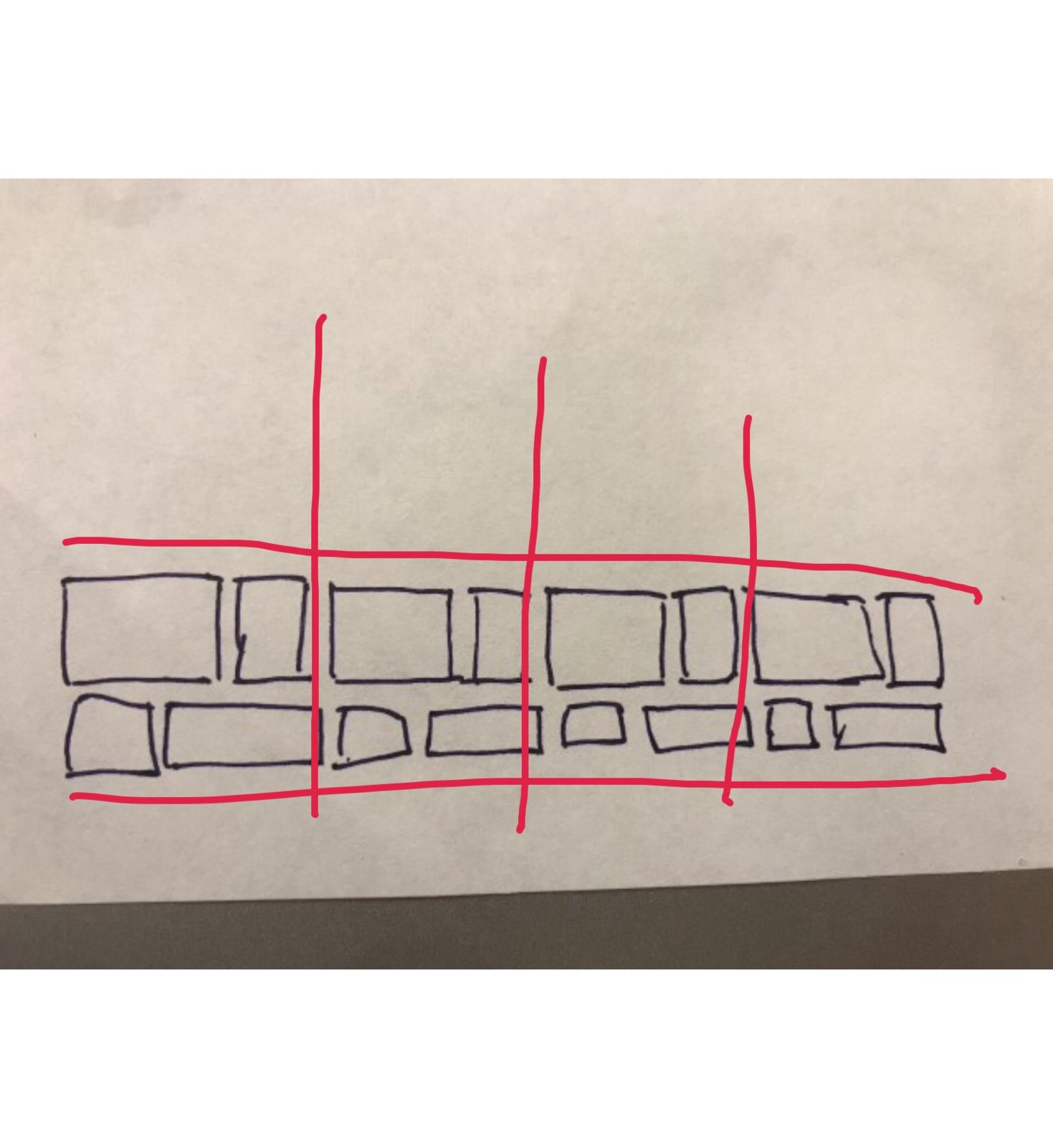

How would you do it with the 3 sizes? 24 - (600 x 600), 36 - (600 x 300), 36 - (300 x 300)
I'm guessing...
first course would be 300 depth so would consist of 300 x 300, 300 x 600, 300 x 300, 300 x 600 (alternated) etc.
next course would be 600 depth so would consist of 600 x 600, 600 x 300, 600 x 600, 600 x 300 (alternated) etc.
How would this look? Like this?
I'm guessing...
Arnt you going to end up with a straight line grid of blocks of 4 ? or has my brain gone to sleep?
You dont just alternate the two sizes, you put a random selection down. 300x300 - 300x300 - 600x300- 300-300 - 600x600 - 600x600- etc etc .You can also cut a 600x600 into say 200x600 and 400x600 to break the bond. You also do the same and dont simple alternate courses having one 300 then a 600 then a 300 etc.
As i said its not as nice to look at compared to a 4 size layout but with a tight clean flag like porcelain accurate joint size and neat laying is imperitive. This is very hard for a diyer to get right using a normal random layout but very acheiveable using coursed width.
