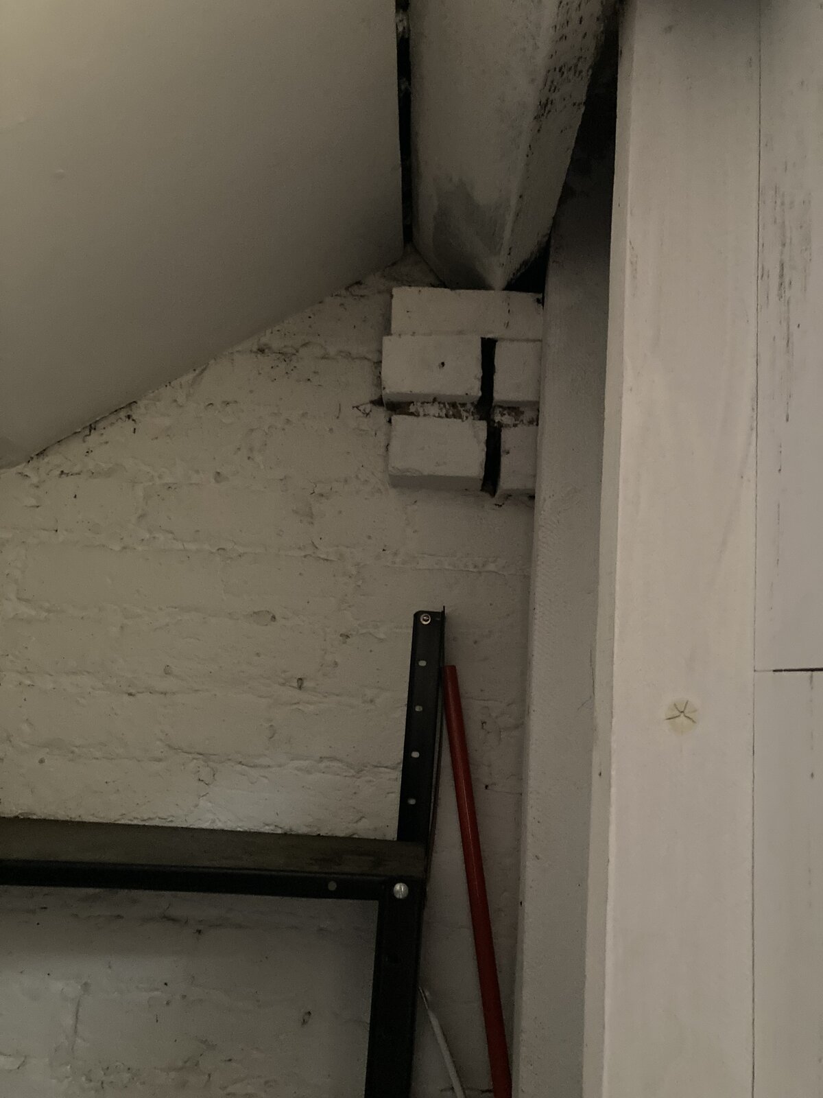

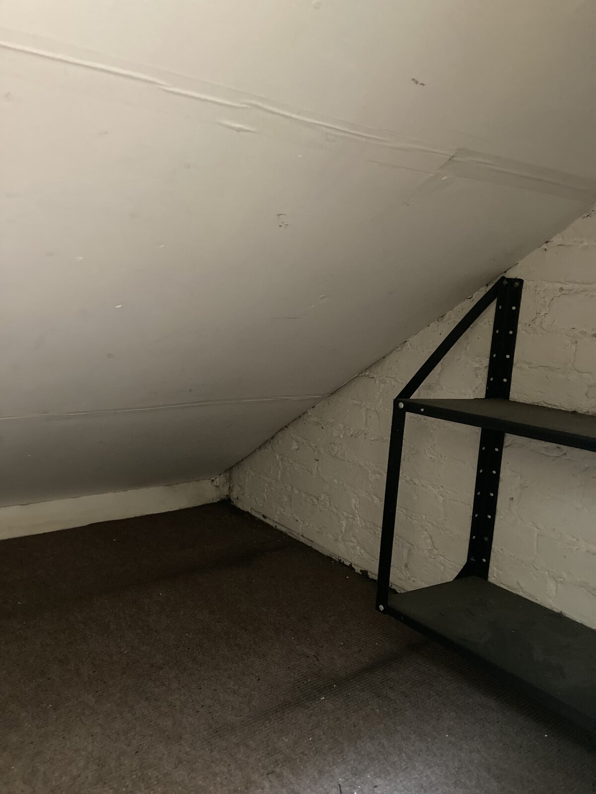

Thank you for the detailed reply.
With regards to:
#1 - only chimney breasts we have internally are related to the large stack on the right hand side, not the smaller one on the left. There is no breast in the bedroom for the small stack and nothing in loft from
What I can see.
#2 - I couldn’t tell you how it’s being supported, I’d have to rip up flooring in the loft to see I imagine?
#3 - I did crawl into the eaves and couldn’t see any water ingress
#4 - our side of the small stack will get removed when we get the loft converted in the next 1.5 years.

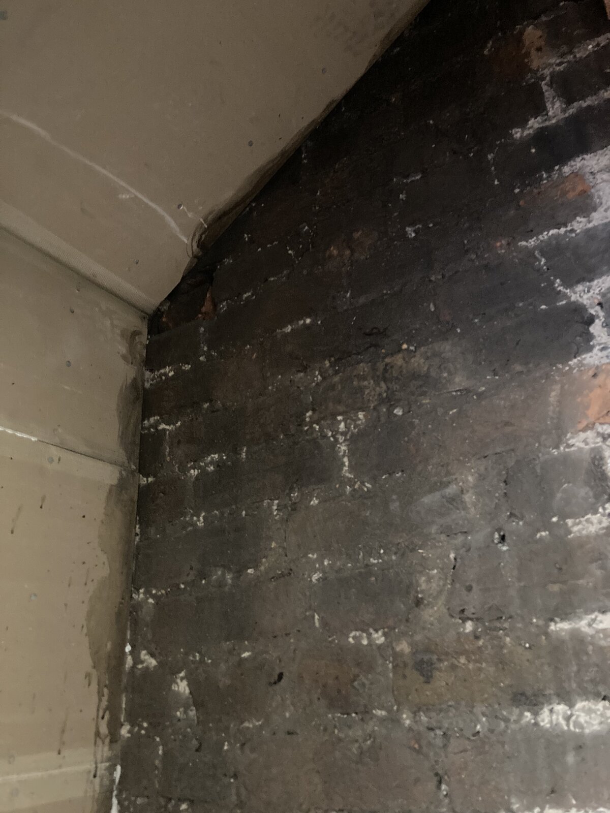

OP,
My point was that there might have previously been a chimney breast in that corner of the spare room.
When c/breasts are removed its often the case that the back wall of the flue is not wire brushed of all soot.
This remaining soot contamination will later show on the decorated surfaces.
Your new pics dont show any signs of a previous c/breast - although the first pic is puzzling with all that dark brickwork?
FWIW: removing half a chimney stack is usually avoided - too many complications! But whoever designs the dormer will have to take account of the shared stack.
For now its maybe a case of dealing with the stack, the parapet & the flashings to keep costs down.
Or, maybe, given you have a solid wall, the gutter/fascia & wall pointing are the culprits?
But you need a professional to view the area.
