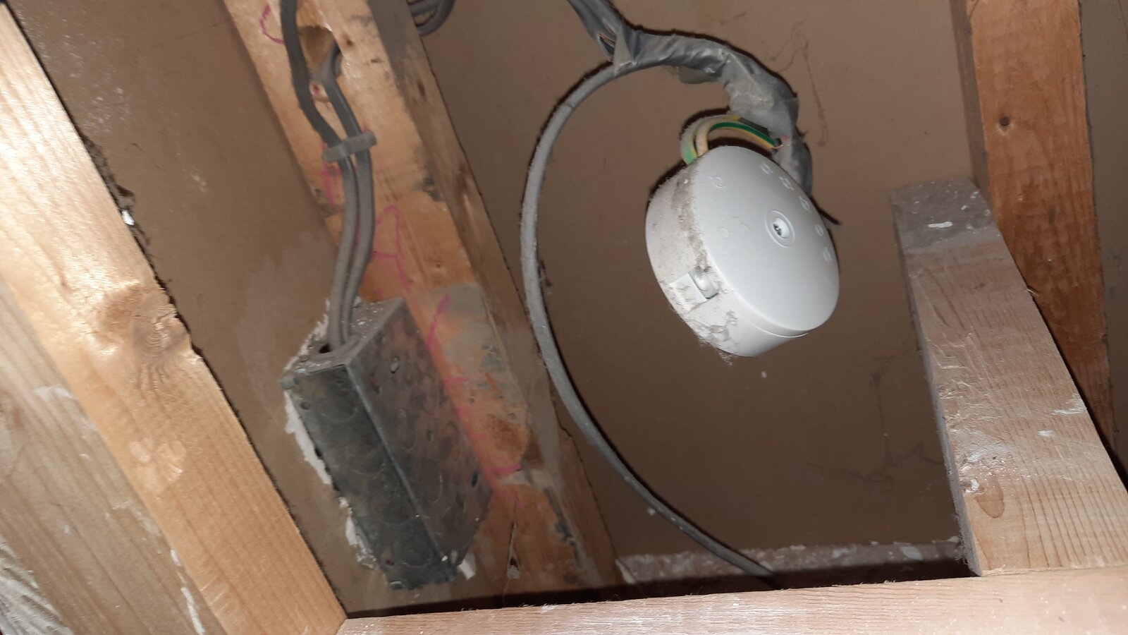

Hi, I currently have a extractor fan that goes off when the light is turned off, if I upgraded to a unit that stayed on after the light is switched off could I get a permanent live from a nearby shaver socket please? All wiring would be outside the room.

No he can’t. The timer fan needs switched live, permanent live and neutral.
It is usual to get the Permanent Live, and the Switched Live, and the Neutral and Earth, from the ceiling rose of the bathroom light.
In UK wiring this is where they are usually present, though they might all be at the light switch, or more rarely in some other junction box.
Normally to feed the Fan you'd have a three core an earth. The Fan I have doesn't require an Earth so it is folded back inside the fan and taped up.
If the fan you are installing doesn't require an Earth I see no reason why you couldn't utilise that conductor as a permanent live as long as it's sleeved appropriately at both ends.
You can only do that with flexible cable where the (green&yellow) conductor is insulated throughout its length; not with twin and earth.
Not permitted. That's cowboy advice.
A live conductor must be insulated and sleeved. The (bare) cpc in the cable is not insulated. Also, earth needed or not, the cable must contain a cpc.

He would still need a permanent 'live', just as he would for a lighting-controlled timer fan, whereas he seemingly currently only has a switched 'live'. The only difference is that for a humidistat-controlled fan he would need only a permanent 'live' (plus neutral), whereas with a timer fan he would need both a permanent 'live' and a switched 'live'.
Hence, if he could find a source for the permanent live, with a humidistat fan he might be able to use the existing 2-core (plus earth) cable, whereas a timer fan would require 3-core (plus earth) cable.

Hi, would this junction box that serves my 2 shaver plugs (in 2 different bathrooms) provide what I need please?
