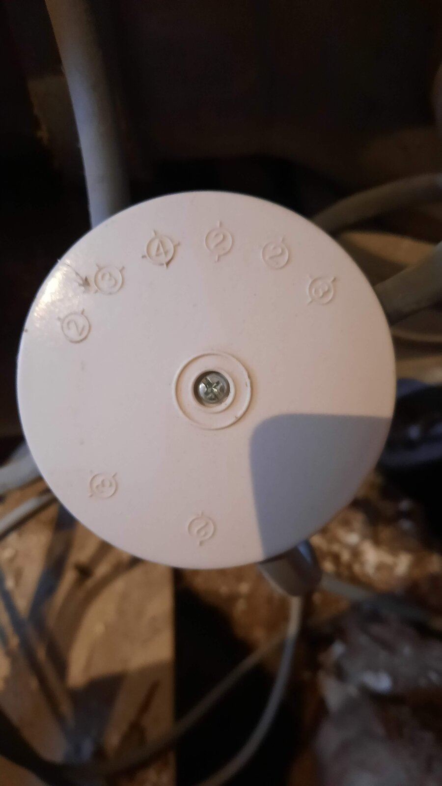

What are the numbers for on the junction box please?
They indicate how you should rotate the lid/cover so as to 'unblank entry holes in the side, depending upon whether there are 2, 3 or 4 cables entering the box.
As previously said, that type of JB is only acceptable if it is 'accessible'. It also needs to be screwed down to something, and all cables entering it should be clipped to something fairly close to the box.
